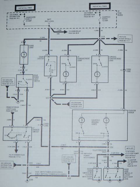

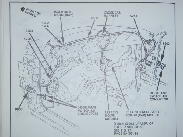

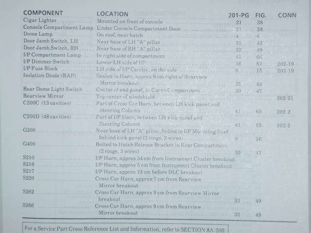

test the output of the interior light switch on the door jam.

would the door jamb switches explain the locks going off as well?

if your security system is designed to auto-lock (mine is after 30 seconds) than yes it could jam switches are like 10 bucks and take about 40 seconds to replace
