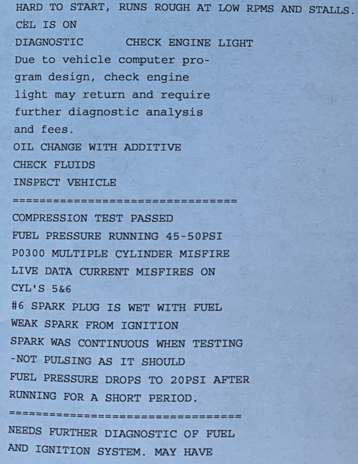

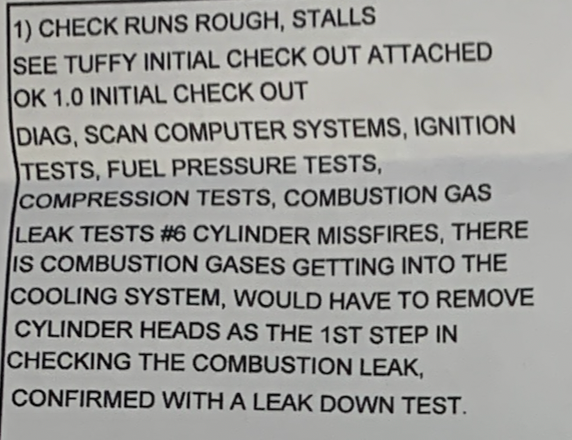

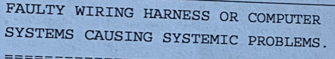

Hi @craby & @Y2Keglide, thanks for both of your replies, I really appreciate it!
The Camaro has the smaller 3.8L 6 cylinder engine.
And attached you will find the diagnostic reports of 2 different mechanics that have looked at the car with some more specifications.
Interestingly, the rough idling has stopped now. I don't think it had anything to do with me changing the coolant, but maybe the ignition coil which powers cylinders 5 & 6 has now completely given up and the Camaro is running smoothly on 4 cylinders? Nevertheless, it still shuts off on low rpms (it holds idling mixture though!, shuts off as soon as you hit the brake).
