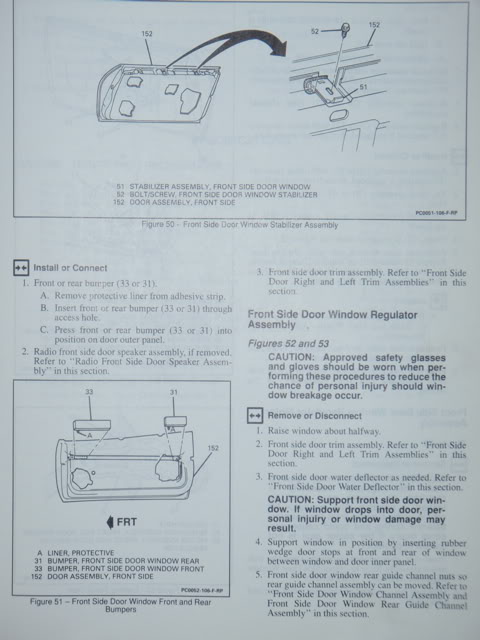

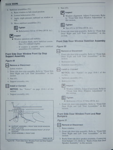

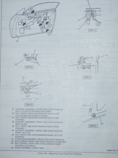

if its not going up all the way you can adjust the window stop more info here https://camaroforums.com/forum/lt1-l...25/#post639865
