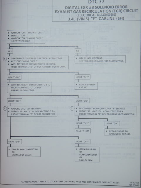

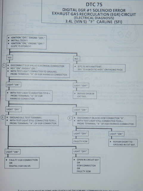

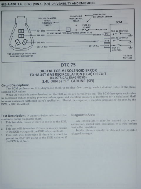

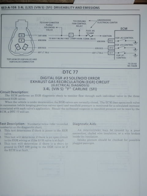

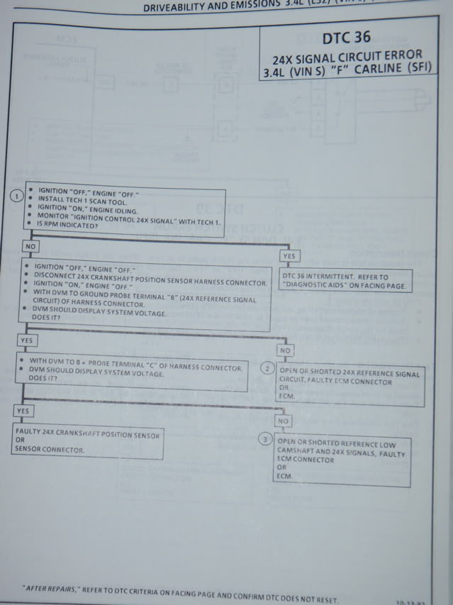

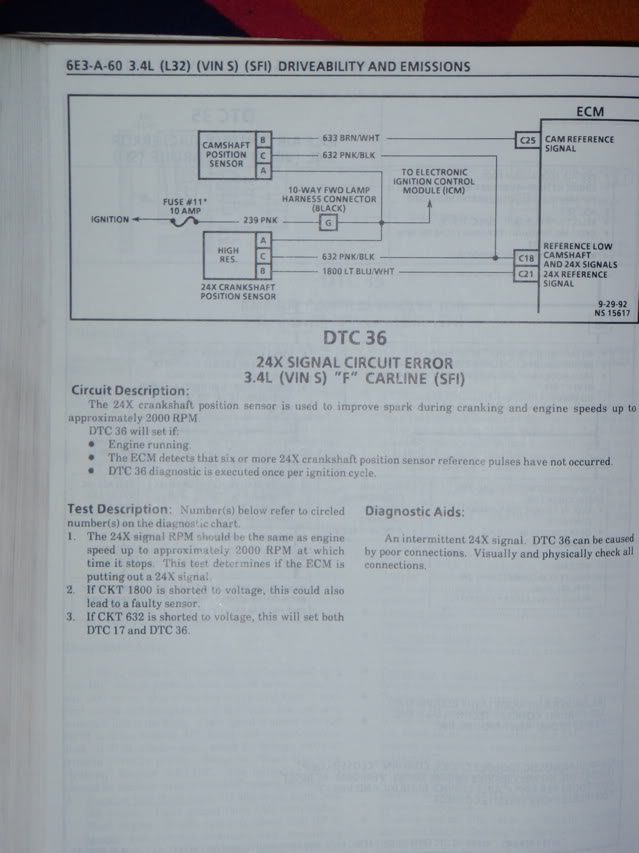

sounds like a cam sensor or connection to it or could be ignition control module.
