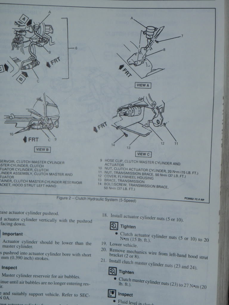

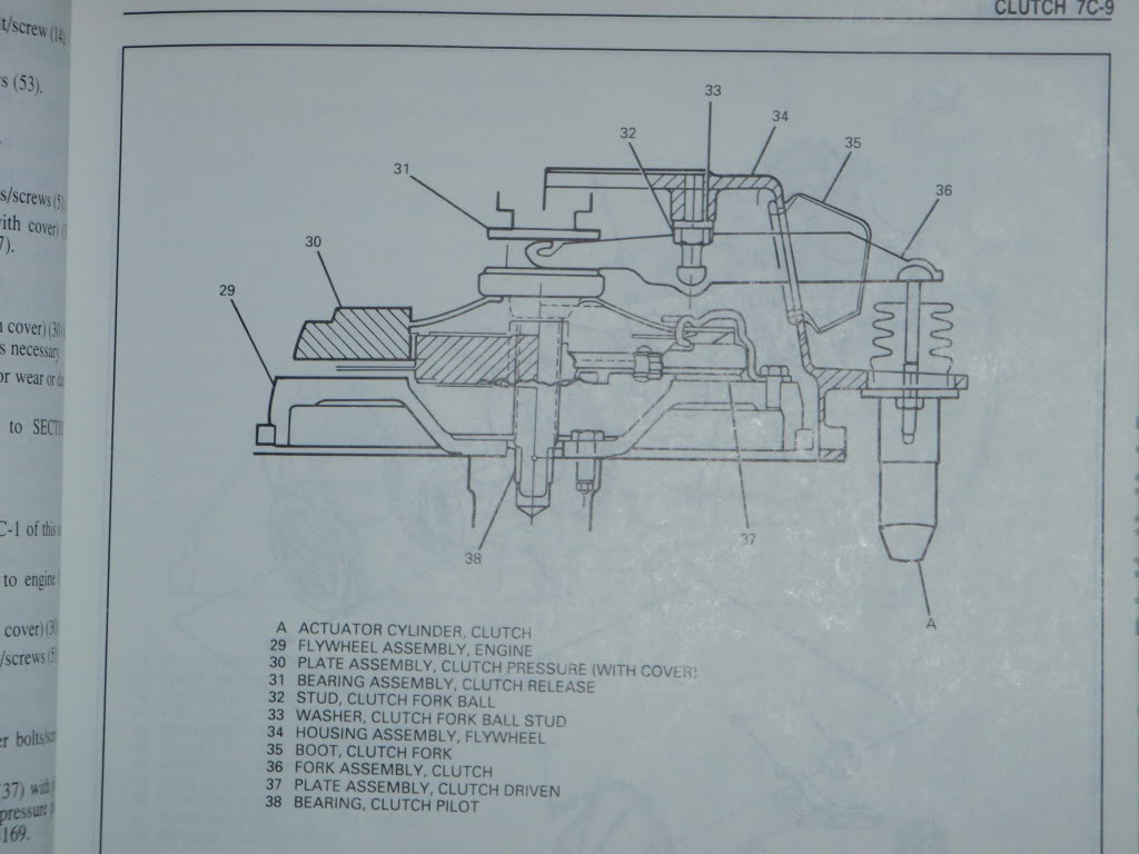

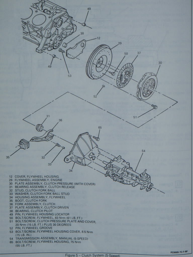

take some pictures so we can see. heres some info

The bad news is your bellhousing isn't fine. You snapped off the mounting ear that the slave is bolted to. You need to either replace the bellhousing, or see if you can find someone who can braze aluminum to reattach the ear, and add some reinforcement gussets to it. Your clutch components are ok, but since you have to take everything apart to fix the bellhousing, it would be smart to just give it a clutch job. You have a T5 trans btw.
