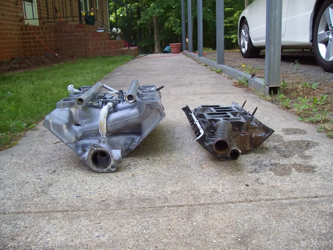

... i may not be shedding too much weight with that monster but hell if i get power than were all set
