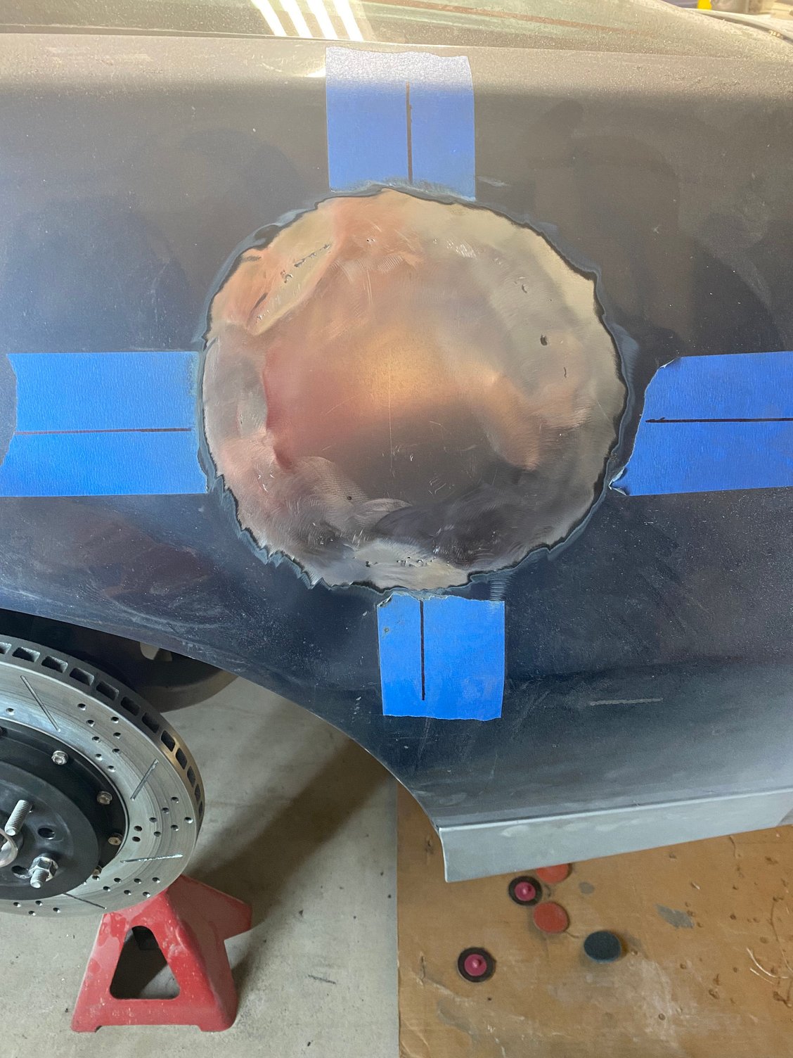

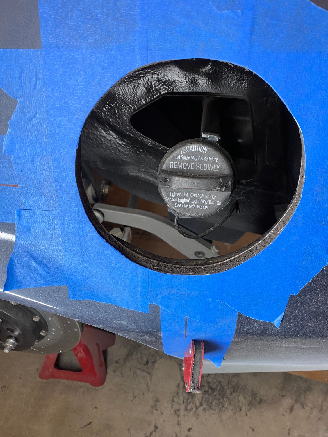

Removed the hinged cover flange

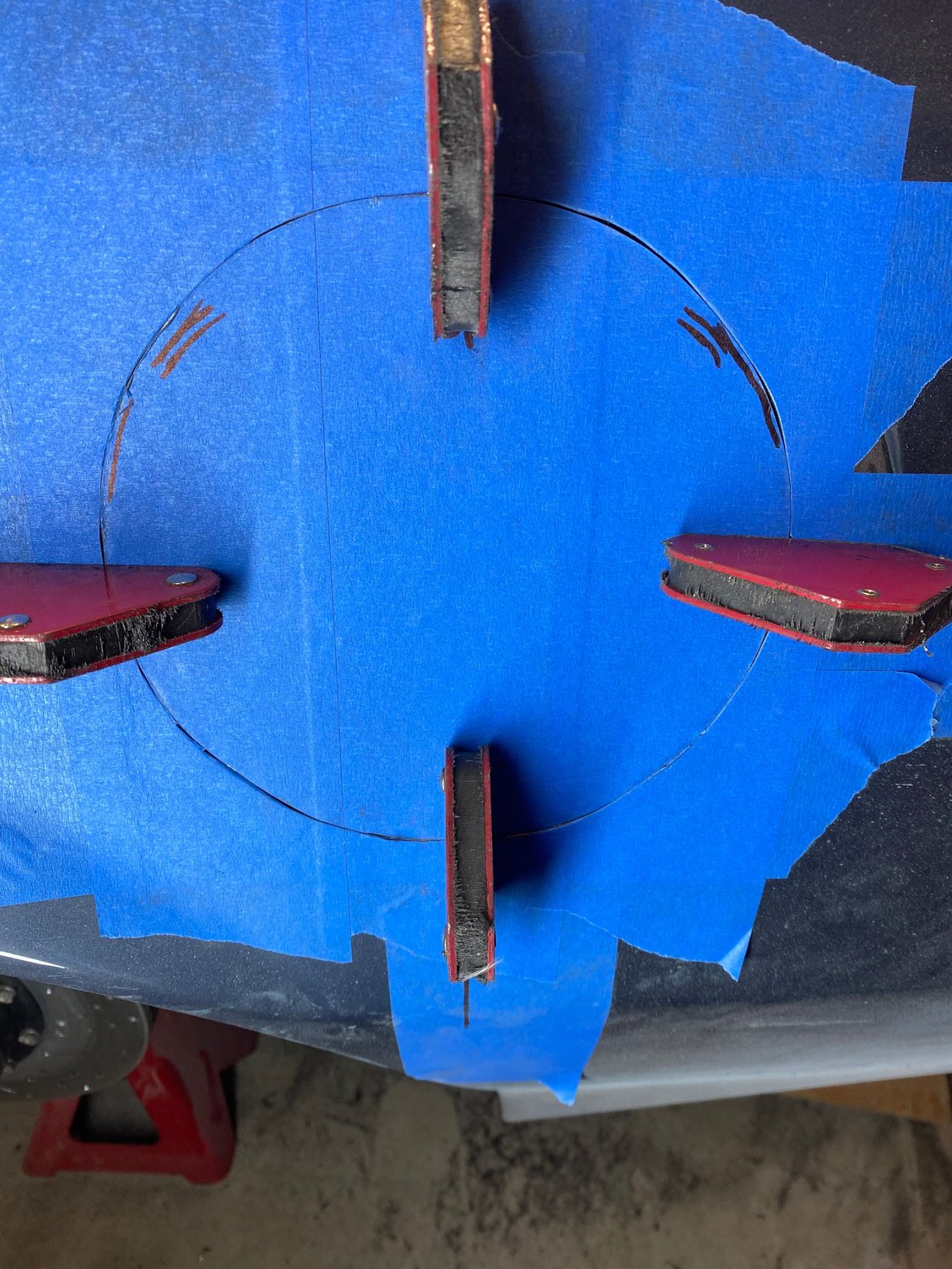

Making a template

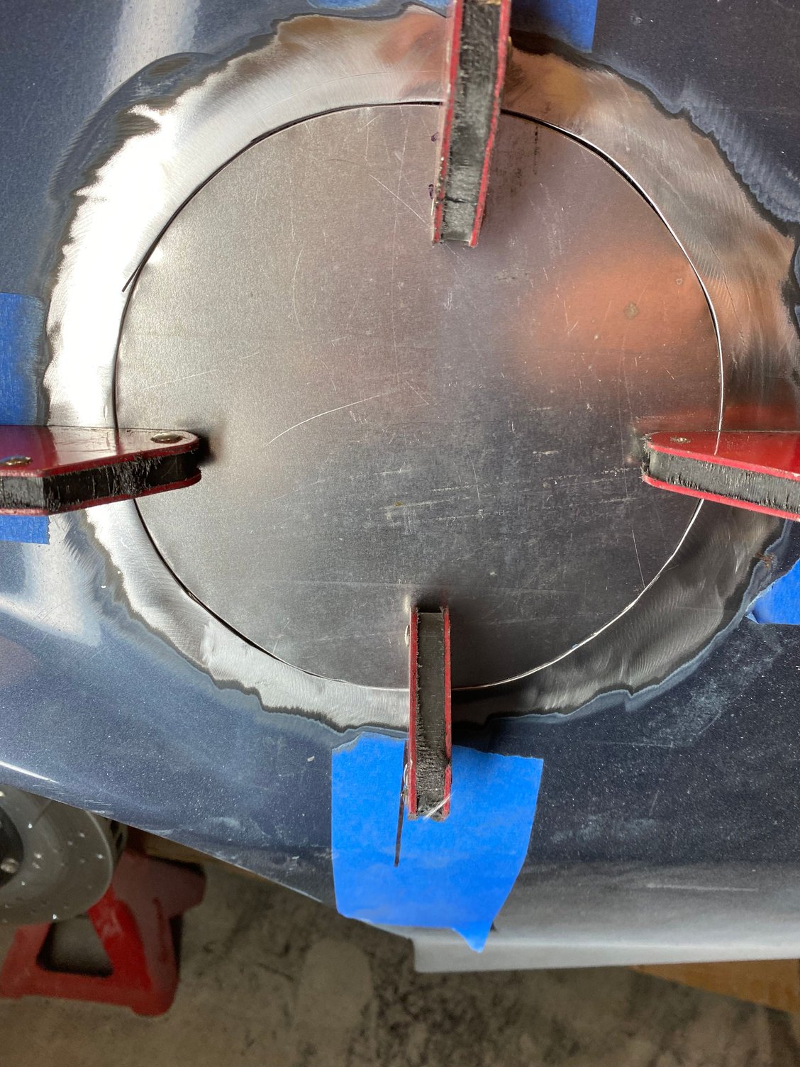

Filler panel prepared for welding
TIG weld the panel

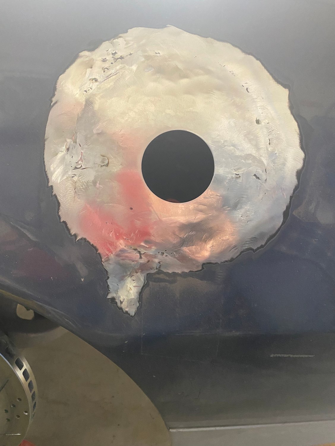

Cut a hole for the new filler flange

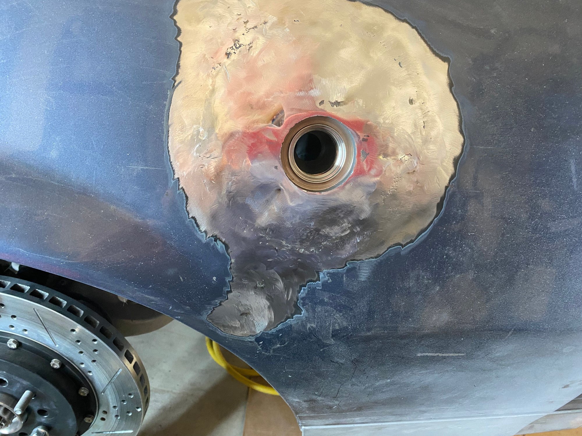

TIG weld the flange

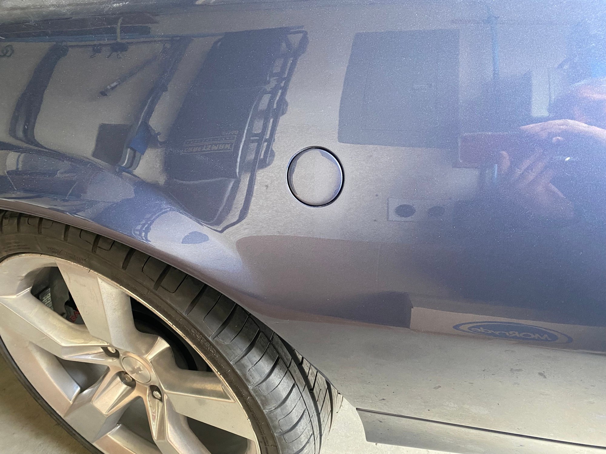

Finished the fabrication. Needs body work and paint
I decided to add a flush mount gas cap to match the flush mount door handles that I am about to install.
