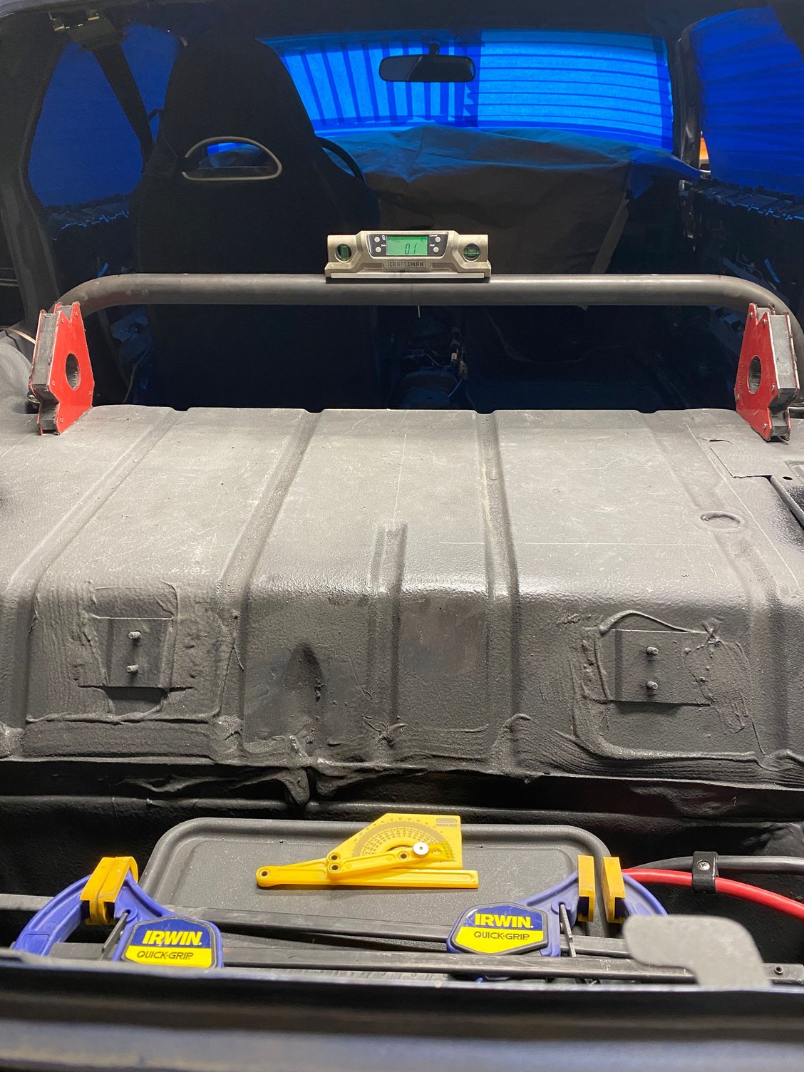

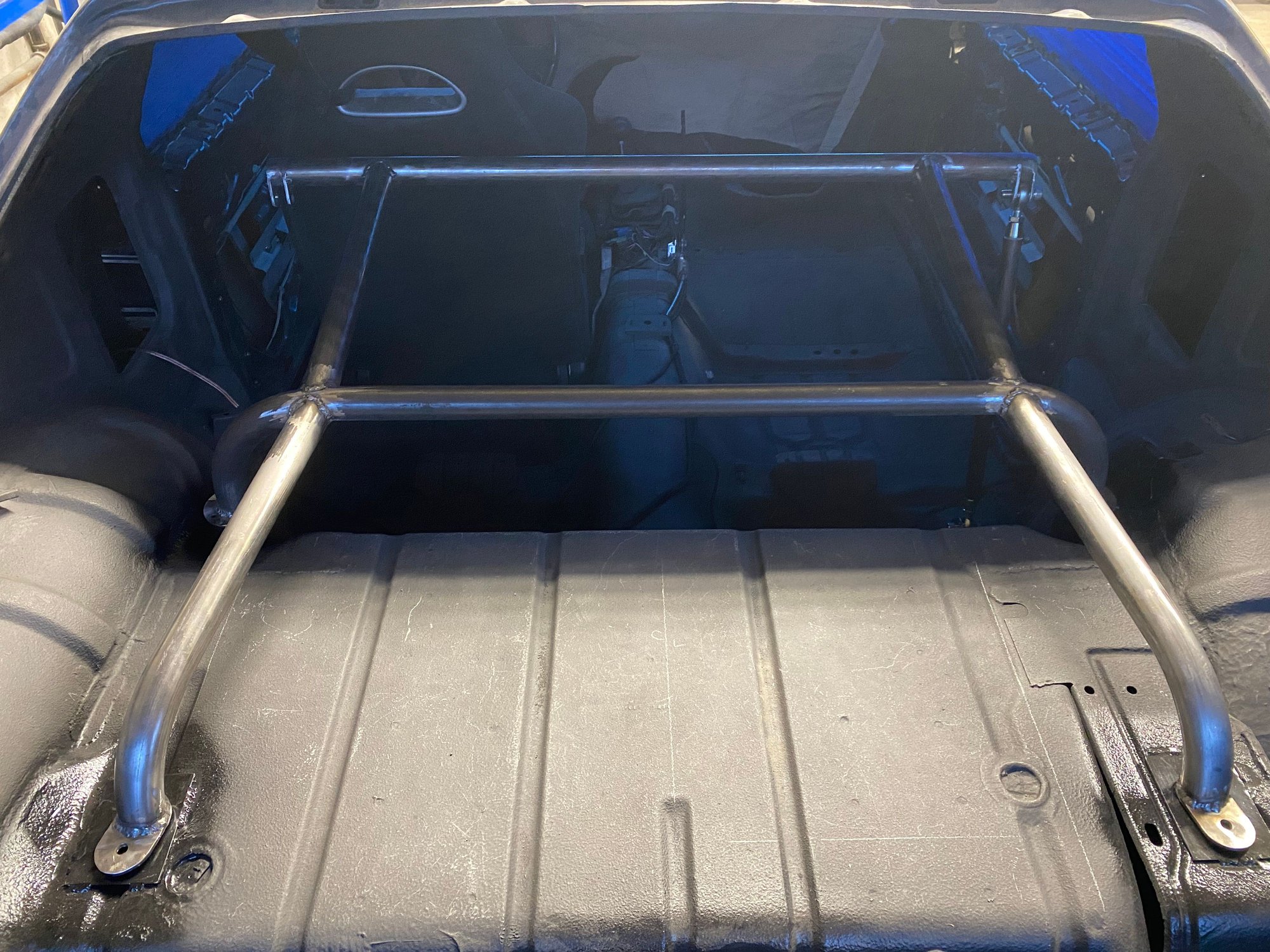

I’ve decided to build a harness bar to compliment the Corbeau RRX seats and delete the rear seat in my car. I plan to auto cross the car and want a more secure harness than the original seat belts can provide.

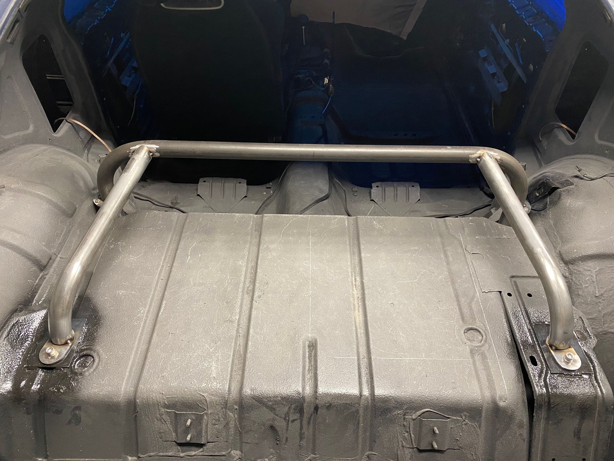

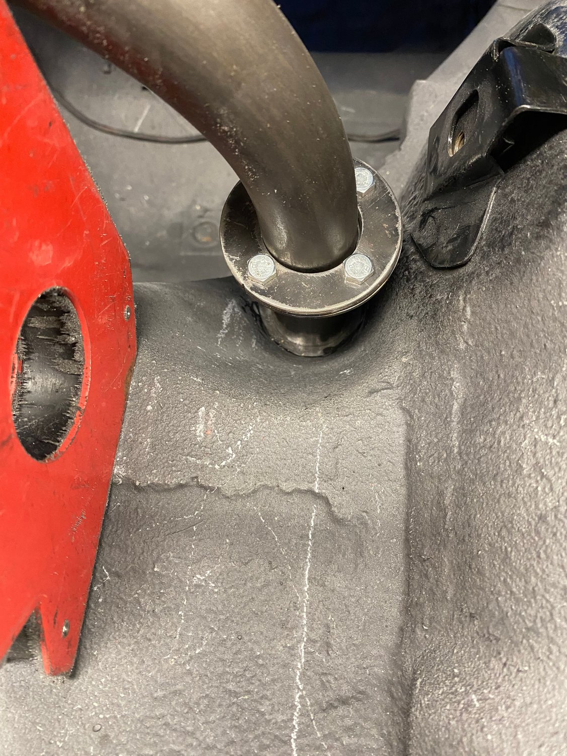

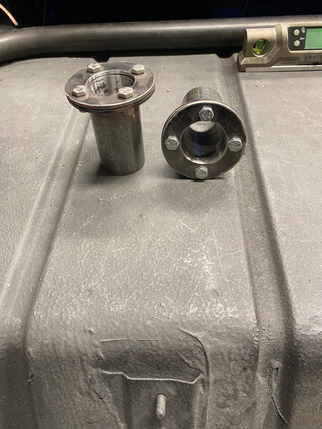

Receivers are welded to the unused upper rear shock locations
Main cross bar
Cross bar slides into the receiver

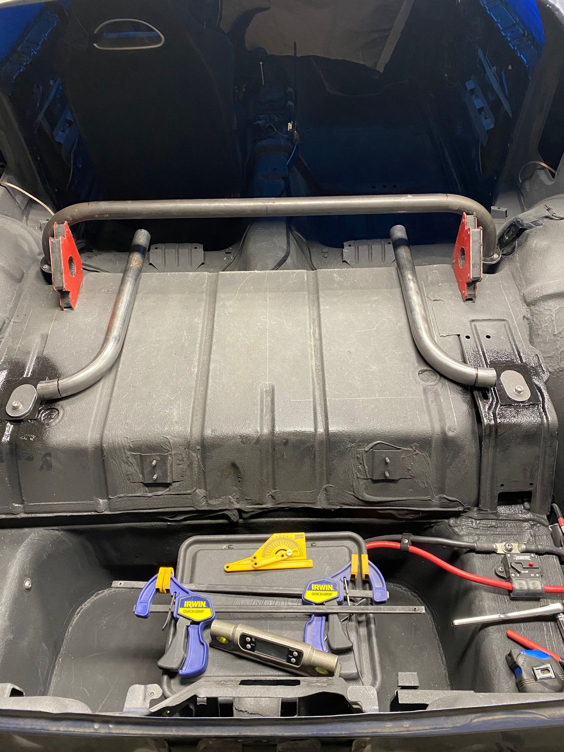

Mock up of the rear outriggers
The entire bar is at a 10 degree angle front to back

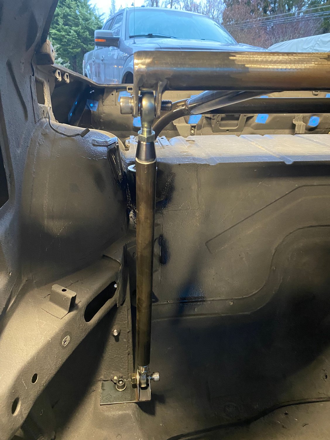

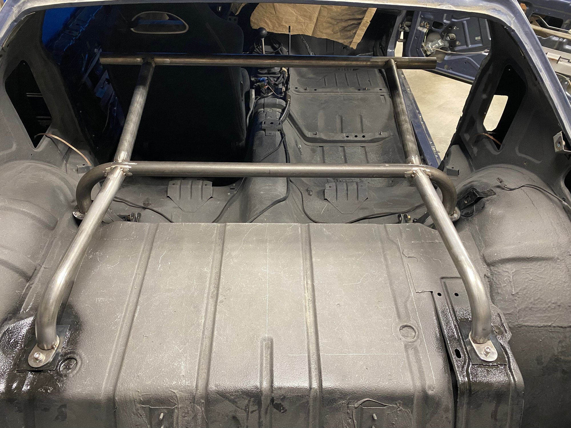

Harness attachment bar “floats” behind the seats at shoulder height
Down bars attach to the side of the harness bar and extend down to the rear seat belt pads.
Completed test fit, ready for paint.
Enjoy!
