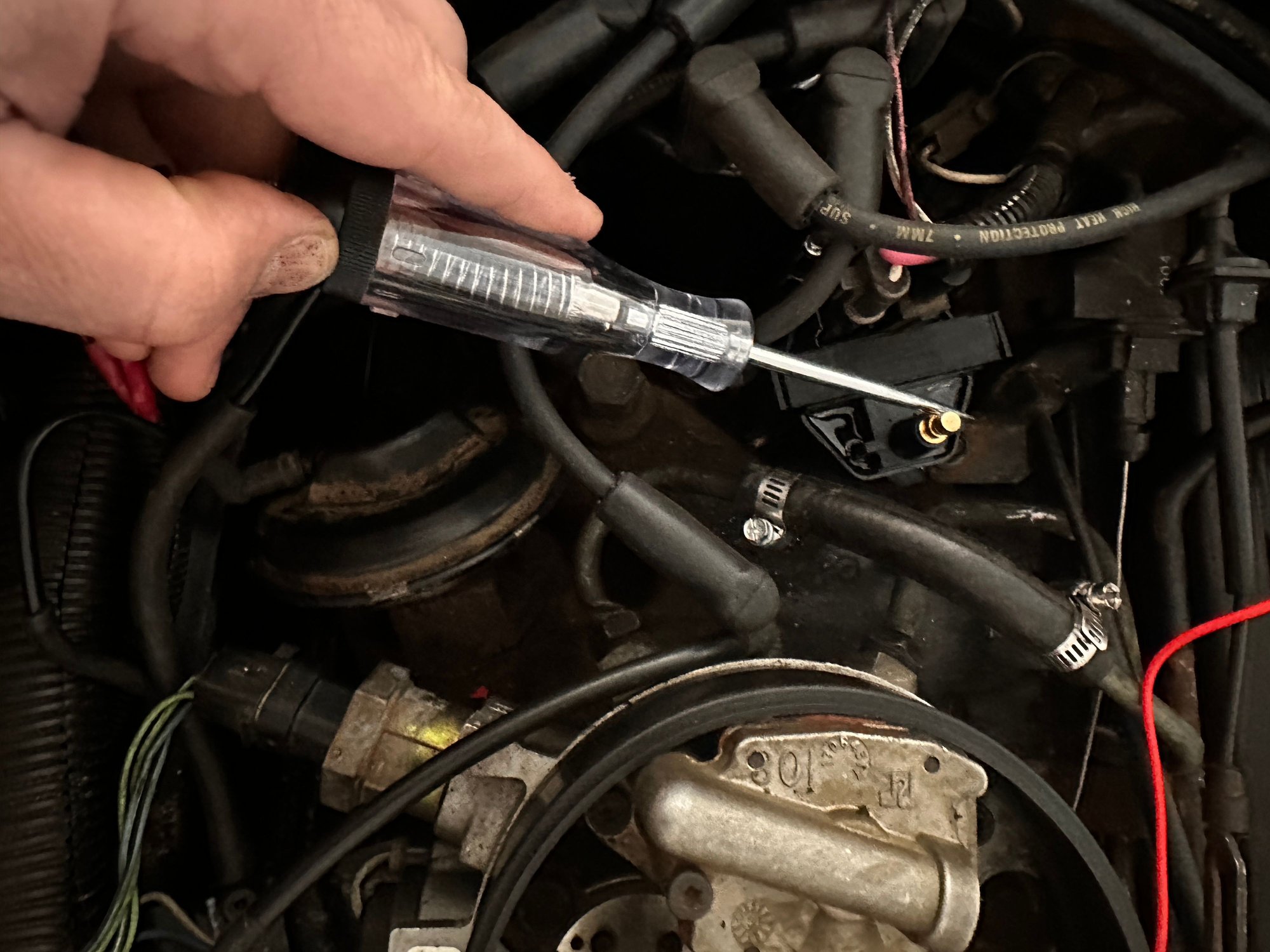

I then checked it on the coil, see picture. No power.
I did check the pink wire coming from the firewall and it has power

Well it is just 12 volts you can jump a wire from the positive side of the battery and see if it starts or at lease sparks. I can not see pics at work.

I tested the red wire coming from the firewall (grey plug) and it has power.
With the car on I checked the red wire from Coil (Black plug) going to the distributor and it has power when the engine is on.
It seems as though the power is coming through the fire wall and into the coil and out to the distributor correctly.
What are the white wires connected to from the firewall, is that the ground? If so, would it help to splice another ground wire to the white coming from the firewall to improve the ground?
Is there a fuse that is associated with the harness for the ignition?
Just grasping for places to look.
I painted the block and perhaps the ground studs on the back of the heads. Could that be creating a power ground?
Since its seems in the ignition somewhere, whats the place place to start to back track the wiring.
Are there any resistance settings I can check on wires?
