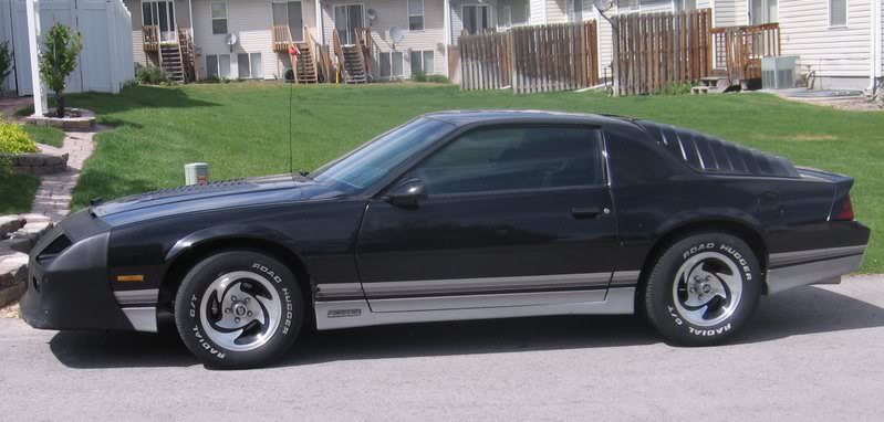

i just bought a 84 z28 for $500 5 speed t tops but no motor. My cuzin sold his old 305 from his 1990 silverodo. I was going to throw a intake and carb on it but i am running into some problems and i would like to know a few thig before i stick to much $ into the motor. The flywheels are different size and i was wondering if it will bolt up to my transmission with little or no mod. Then is there anything else that i have to worry about or change before i put the motor in the car.
You can see pic of the car at www.myspace.com/93xr7merc
