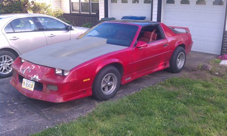

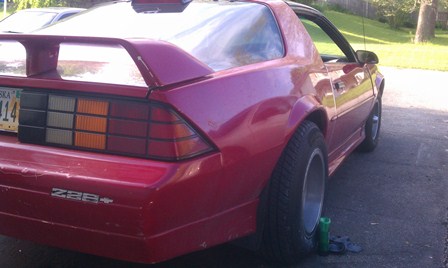

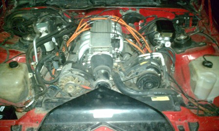

here is what I'm working with

no smoke at all in the morning and haven't seen any through out the day , battery is about a week old. I think its just too small to be honest. the cca is in the 600's i think. I went to pick up a thermostat but was unsure of what motor was in it ( I think it's just a RS but with the sides stating Z-28 and the dash stating Z-28 iroc I have no idea) so I picked up one for a 305.

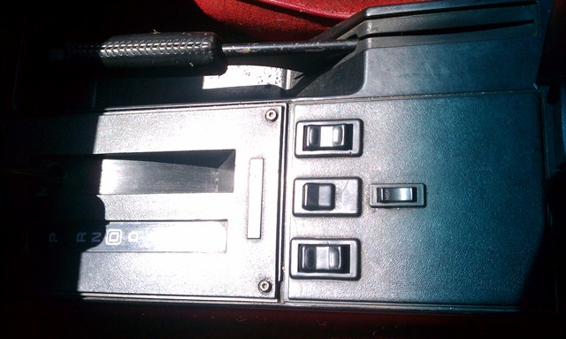

also, there is a high low switch under the hatch release that I have NO idea what it does.

The high low is not stock....most likely a manual fan switch.

I tried messing with it but i guess it does nothing, fans are hard wired to the ignition. Have to chase wires I guess. Still running good, just picked up a temp gauge and am about to try and put it in.

yea, that switch isnt factory. the side skirts and rear wing are also not factory for an 86. the side skirts are for an rs and the wing is for a z28, both '90 and up. adding a temp guage shouldnt be hard. there should be a thread plug on the side of the head that will work. not sure which side it will be on, but one head already has a sensor with a green wire in it. just leave that one in there and put the new one on the other head
