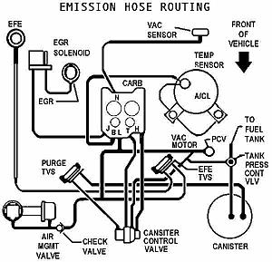

I have an 82 with a 305. Just bought an Edelbrock air intake manifold (w/out and egr attachment) to pair with my new carb (carb 1403 4 barrel). I'm looking to clear out all unnecessary hoses and lines for a more simplistic look/function. What all can i get rid of? Is most everything in this diagram below removable? I hear pcv is something you should keep but i dont know squat about this portion of auto mechanics evidently.
Diargram: https://camaroforums.com/forum/attac...1&d=1503861324

I assume you are eliminating the computer system? You still have the computer controlled timing? You are going to need a new distributer if you do. Note the Vac sensor. That is for the computer.
The rest of the vacuum lines are for air injection and gas tank and Carb ventilation. How is the new carb vented? Tank needs a vent but you don't "need" the charcoal canister.
