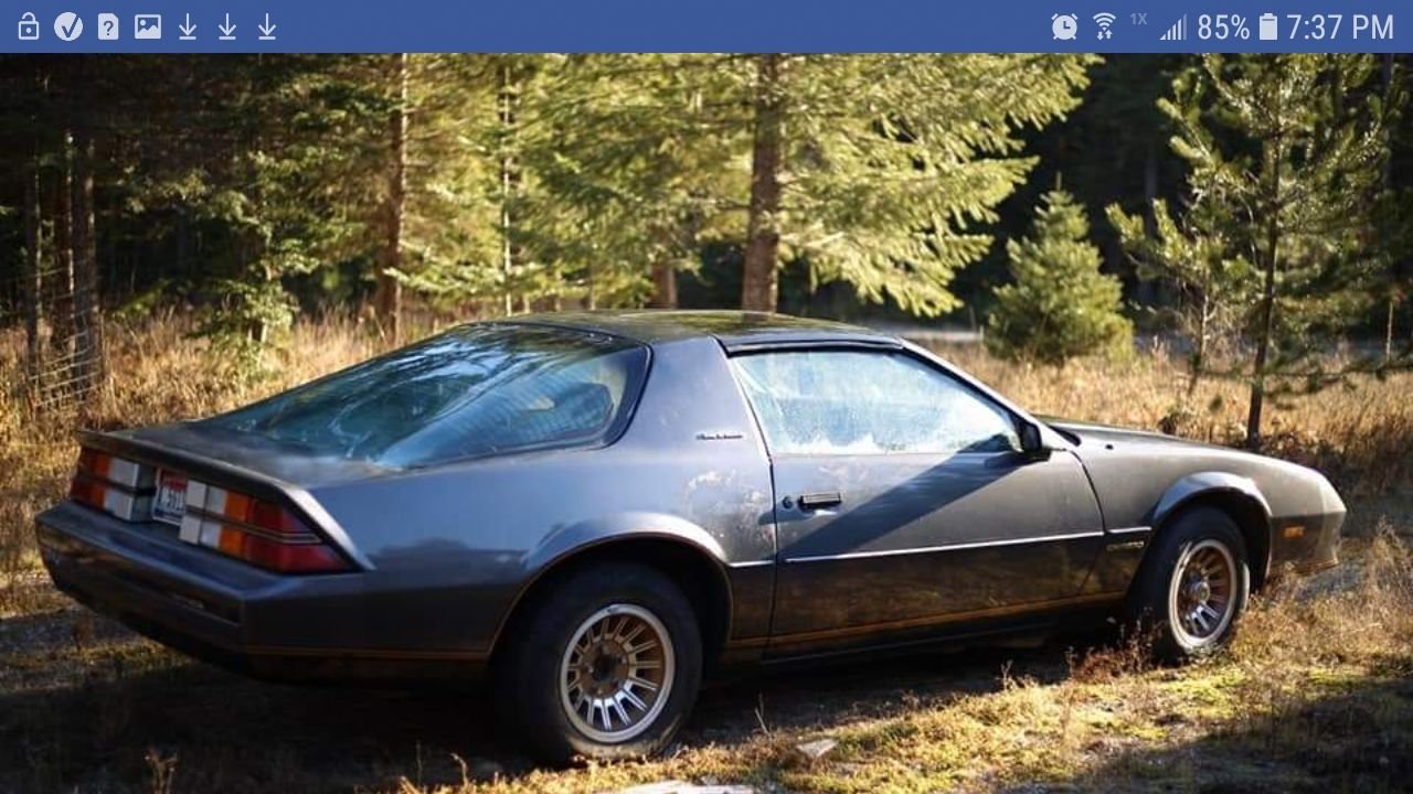

Saved this Camaro before it went a winter without a garage. It's now in my garage and I'm not sure what to do with it. I'm seeking guidance from the Camaro loving community. Please let me know your opinion.
I don't have much information on the car, or knowledge of Camaros in general.
This 1982 Camaro Berlinetta has just over 28k miles on its body and probably original 2.8l v6 with Rochester 2-barrel. The exterior is in fair condition with some chipped paint and clearcoat, I haven't washed it yet so unsure. The interior is fresh showing its 28k miles. Military owned and taken care of, I purchased the car from the original owners granddaughter.
I want to update steering, suspension, and brake components that are worn due to age or are of poor design. Vortec heads, an EFI, and maybe a turbo down the road. Drive it on dry weekends, take it to the track once it's HP isn't embarrassing, and feel cool while I tack on the miles.
What would you do with this car?

If it were me I'd Mostly just drive and enjoy it.
These early 3rd gen six banger cars don't carry a lot of value, even low mile examples like this car so I wouldn't invest too much into it especially anything like a turbocharger.
If you want more power fix it up with a nice detail job and sell it then add some cash and find a v-8 car.
You can see some modest gains with an exhaust system upgrade (headers) and cold air intake but that alone will cost a fair amount of money.
If you want a nice little daily driver summer car that's fairly easy on gas and looks great I'd buff and wax that puppy and maybe do a tire and wheel upgrade.
There's plenty of parts available for better handling but again you can spend a lot of money there and still not have anything that really handles great by today's standards.
I'd suggest a good set of shocks and a pair of better sway bars along with a tire upgrade,that would go a long way towards making you smile in the corners without braking the bank and getting you too upside down value wise on the car.
If this was a Z28 not a six you would be a little better off,at least then you'd have a V-8 to work with but they only came with a 305" (5.0) turd of a V-8 making all of 145 hp.
At least you could swap in a 350 with ease and have some power and a Z is worth a bit more but it would almost be a shame to molest a low mile original car.
Maybe you can find a 3rd gen Z28 parting out for some steering and suspension parts to upgrade your car on the cheap and there's always used parts on ebay and the like,craigslist etc.
Sure is a nice clean little 3rd gen,I'd love to have it just for a summer daily driver,enjoy your find and let us know what you do with her.
