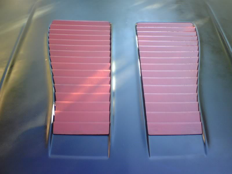

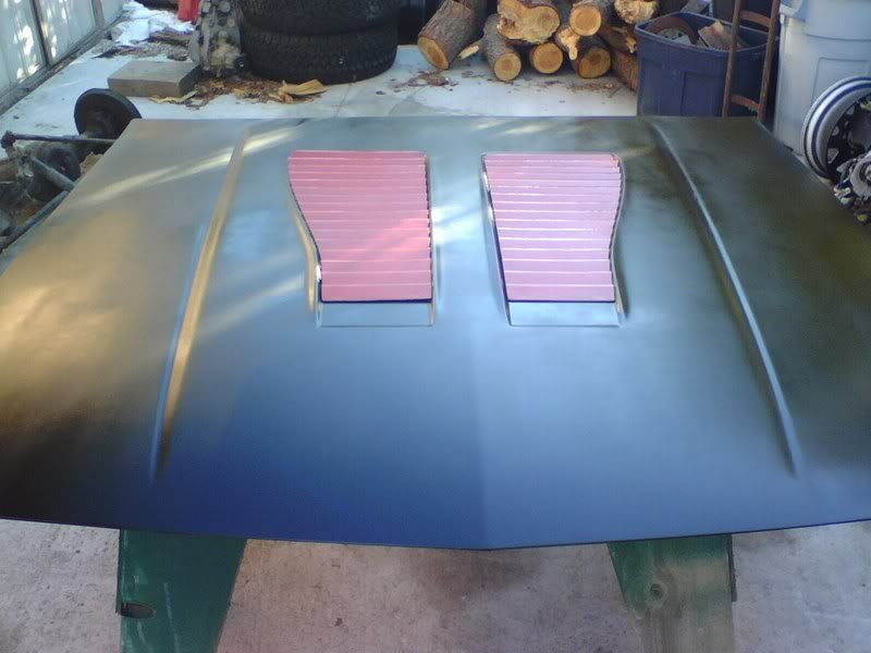

Default pix of the repainted hood
i think it turned out good. im still going to repaint the whole car in the summer at which time ill sand off this paint along with the rest of the paint on the car and give the shop a bare metal...and some parts fiberglass....medium to work with.
you like?

gir not sure why the images didnt post but heres links
<a href="http://s56.photobucket.com/albums/g197/RammsteinRx/?action=view&current=1016081705.jpg" target="_blank"><img src="http://i56.photobucket.com/albums/g197/RammsteinRx/1016081705.jpg" border="0" alt="second shot of repainted hood"></a>
<a href="http://s56.photobucket.com/albums/g197/RammsteinRx/?action=view&current=1016081705a.jpg" target="_blank"><img src="http://i56.photobucket.com/albums/g197/RammsteinRx/1016081705a.jpg" border="0" alt="repainted hood"></a>

Oooo Stealth Black.
My brother wants his whole car a satin to eggshell black.
If your car has not been repainted a number of times and the original paint is sticking to the car don't sand it all off to metal. Paint will stick to paint. It will not stick to bare metal. Taking it down to metal will create more unnessisary work and extra material cost.
Oh but as for the paint from a spray can. It should be taken off. Automotive paint will eat that stuff up.

Hood looks good. I agree with MadMikeZ28 if at all possable don't take it to bare metal i made that mistake with my old truck on a small dent i sanded it down before a gave it to the auto body shop and the price was double than what they quoted just for all the metal prep.
