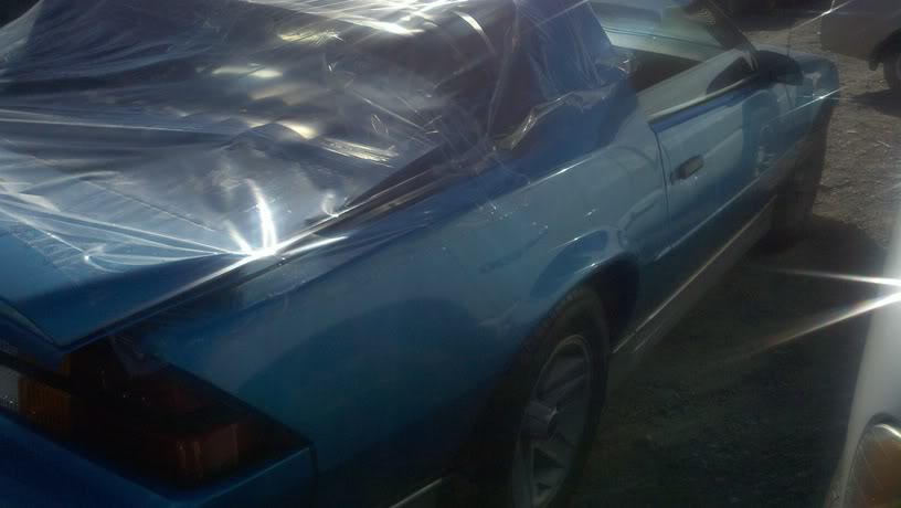

Hello everyone. My name is Matt and I have purchased a 1988 Camaro RS with t-tops for my Senior Class Project. The car has 43,000 miles on it. The car was involved in an accident and sustained rear end, left quarter damage.
After the accident, the car was considered totalled because the estimate to repair it was over $6000. The car interior and exterior are in to good of shape to let the car be scrapped, so my father and I have elected to purchase the car for $1200.00 and do a lot of the repair work ourselves.
I will be posting pictures of the car and the damage shortly. I will then post pictures of the progress and ultimately the end result.

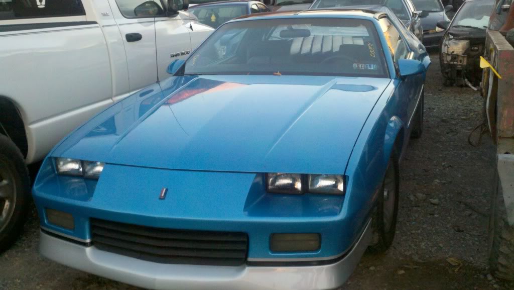

This is a few pictures of the car as it sat at the "boneyard". The car had arrived there three days before my father stopped to see if the owners might have a car worth salvaging. As you can see from the pictures, the car is worth saving. There is no rust, tears or cracks in the interior, paint is perfect and only 43,000 miles on the engine. Look forward to putting this car back on the road.

thats a good find for that price. do you plan on repairing or replacing that quarter? do you have any local yards with those parts availible (as i can see the hatch is broken). theres a few around here that have a bumper, hatch, and good quarter if you are looking for used replacements.

I would take it to a frame shop and have them pull it as close to original as possible. Then remove anything near it that bolts on. Smooth anything as much as you can with a hammer and dolly. I would remove only as much as the quarter panel as needed. Keeping the repair as small as possible. I have repaired damage like this in a week at the shops I have worked in. This isn't an easy repair, but it isn't difficult as long as you take it slowly, and carefully. All of this is said not knowing your extent of knowledge in this area. Have fun with it, it looks like a very nice car.
