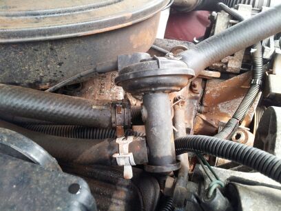

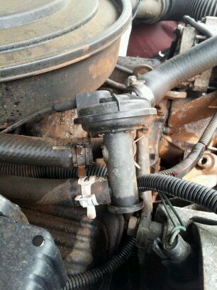

OK so I just got some more coolant and filled it up and now found what the problem was. does anyone know what that peice is called in the picture?

I am pretty sure that is your heater control.
