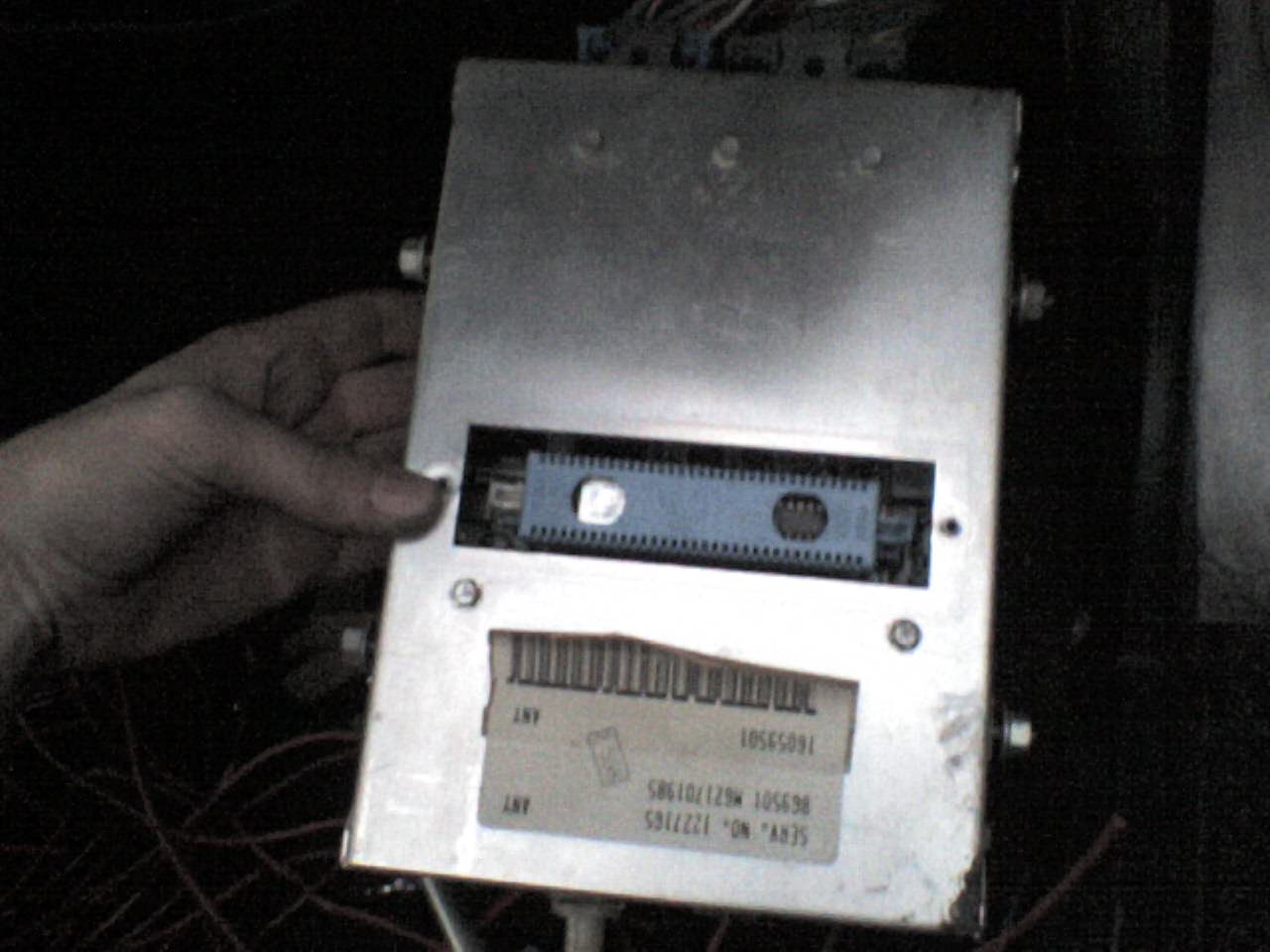

either im looking at the wrong item, or its not as depicted in the haynes manual (chilton doesnt have a picture) everything is in the same spot, however the only chip i found was a long chip with about 50 or so connectors, not the little rectangle chip in the bottom. heres a picture to show what i found. is this it?

well, my guess is that haynes used the one for the tbi or one of te v6's because all the other tpi chips look like that. good job haynes!!!

You are looking at the Prom (chip) in the ECM..

ha, yea. i realized that after looking through other pictures. idk what haynes shows, but its not the tpi chip

GM calls that chip the MEMCAL and it contains all the instructions for the ECM. The same ECM may be used in various model GM cars (up to 1993), but each application uses a different MEMCAL.

the whole blue unit is called a memcal and the prom is inside the memcal. you can have the prom changed in your exsisting mamcal or you can have the prom inside the memcal reburned or you can get one of these, http://www.moates.net/g1-memory-adap....html?cPath=64 and get a prom thats tuned to plug into it. pcmforless sends a unit like the g1 with the prom soldered in. soloman uses the moats g1.
