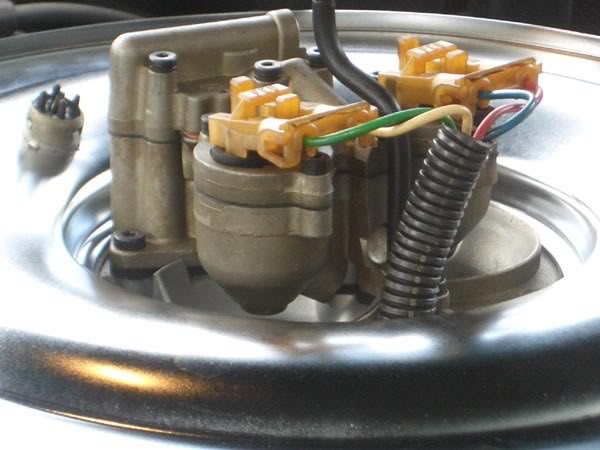

Originally Posted by maudyZ28
yeah i asked him that and yup its CO2, UK emission say we can have 3.5% but his was 7%. Anyway he had bought a 14" air cleaner base or something which he too back off and put the stock one on and all is fine.
Then he must have TBI (a carburetor-esque FI unit), not TPI. Possibly he didn't transfer the temp sensor probe from the base of the old air cleaner to the new one? That would sure do it.
Here's a pic of when I put an aftermarket air cleaner on mine. You can see the probe to the left of the injector pods.
