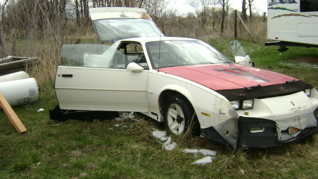

Old Apr 6, 2011 | 04:14 PM
Tcel95's Avatar
Joined: Apr 2011
Posts: 8
Old Apr 6, 2011 | 04:55 PM
HorizoN's Avatar
Joined: Mar 2010
Posts: 100
From: Southwestern USA
That poor damn Camaro.
Good for you for trying to get it running, man. Best of luck to you, don't be afraid to keep asking questions.
