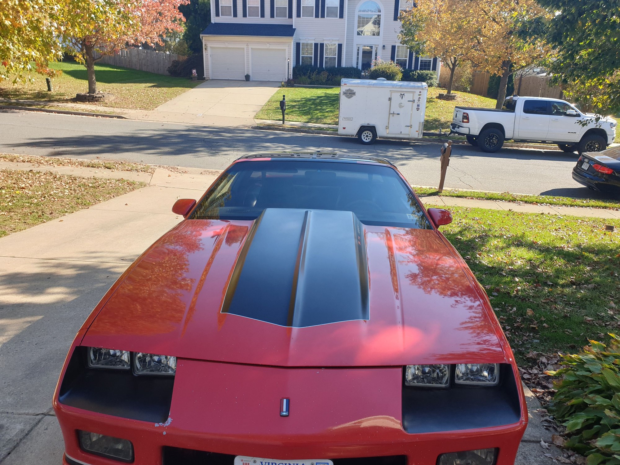

I have an 87 Iroc 5.7L automatic 89k miles where a misfire on cylinder 6 was diagnosed. It was running rough and would start bucking and shut down on long drives every 150 so miles. I'd turn it off and 10 minutes later would run again but rough and a decent engine vibration. This kinda came out of nowhere. Now on a short drive the engine vibration is bad as well
A shop I took it to said it was a misfire and could be an injector. They checked plugs, wires but wasn't the problem. They couldn't do any engine work because they're backed up but we're trying to sell it and don't know if it's worth spending a lot on engine, or just selling it as is. We might not get the money back out of it if its major. Other than the engine issue its in great shape.
Anyone know what the issue might be and costs for any of the possible issues? Thanks.

BTW Nice looking car. I cannot imagine a scenario where it would not be worth fixing this car. I am sure selling it with a miss fire will hurt the value of the car more than the cost of a repair. .
Agree 100%
