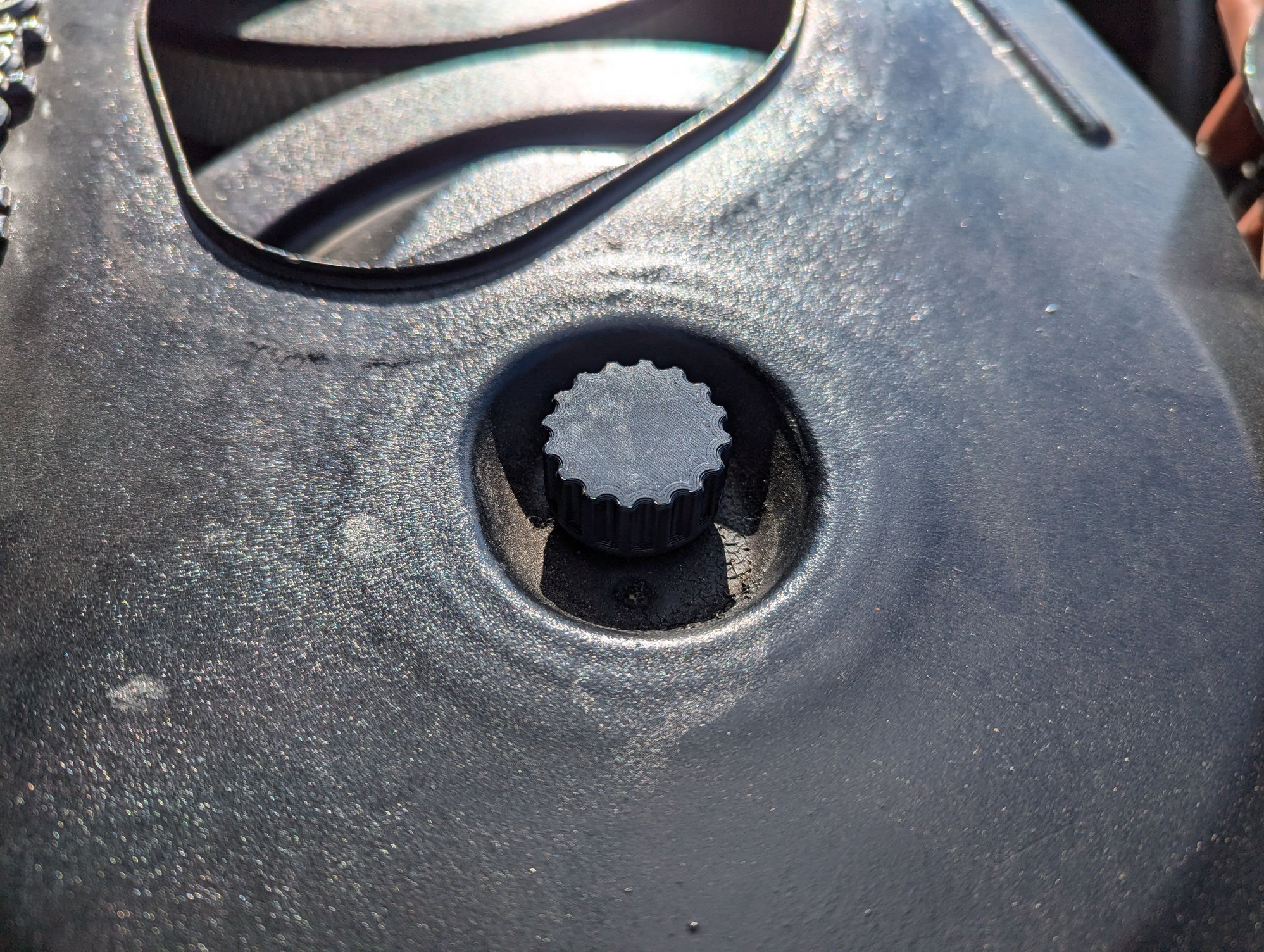

This gave me an idea. Could I create this air cleaner nut in CAD, and 3D print a version that looks practically identical? I think I've succeeded.

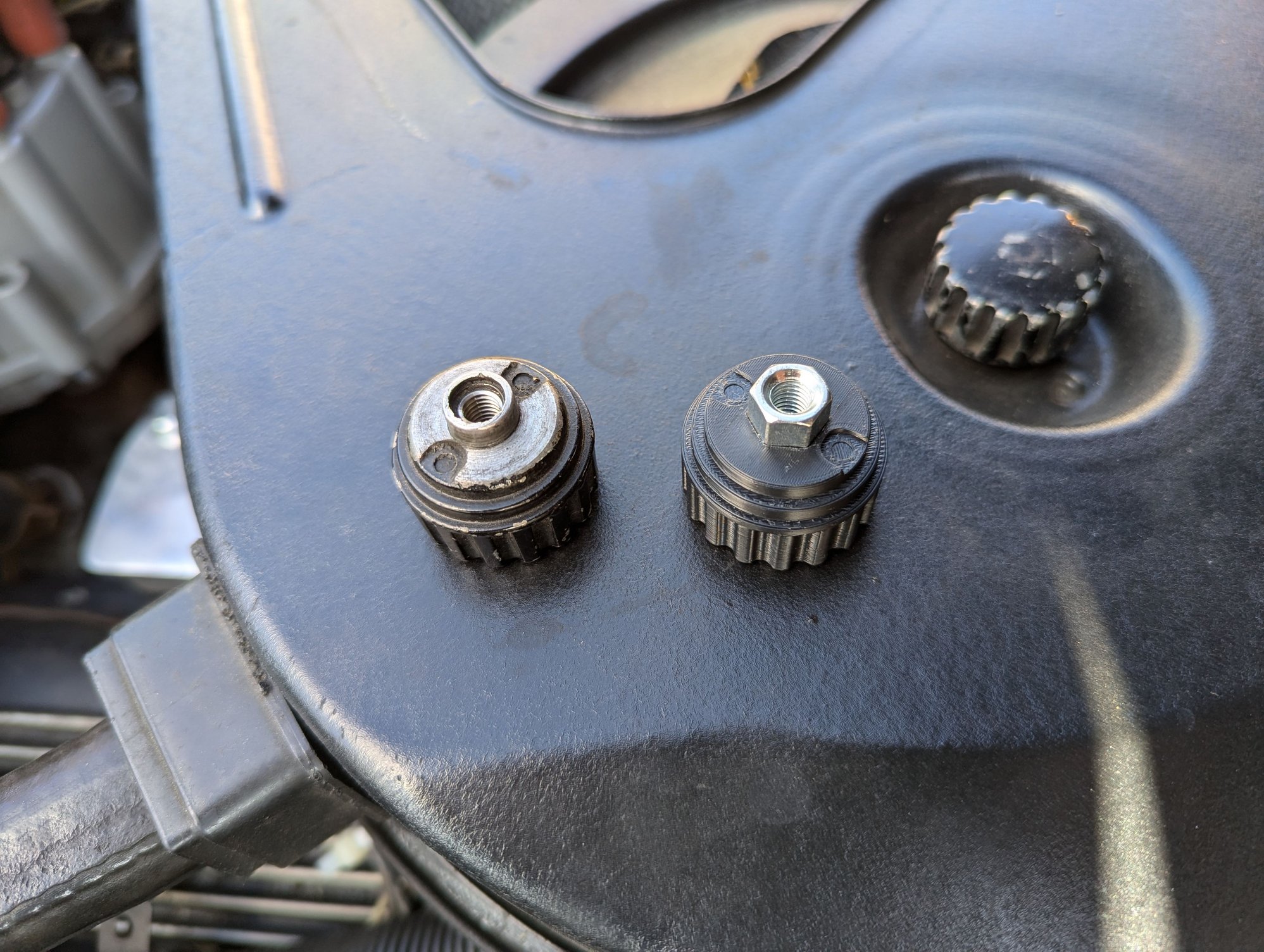

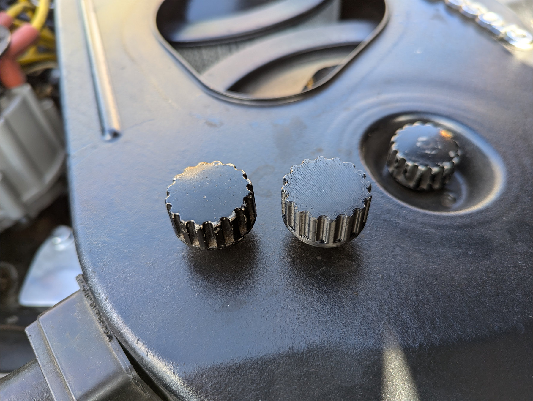

The original nut is on the left, the 3D printed nut is on the right.
The nut is printed face-down, with a hexagonal sleeve in the middle. Once it's printed, I hammer in a coupling nut that's the same thread and length as the original (M6-1.00 x 25).
The nut is printed from ASA plastic, a modern form of ABS plastic, which is found in practically every car that contains plastic parts, both inside and out. Most 3D printing hobbyists use PLA plastic for printing, which is fine for ornaments that'll sit on a shelf, but not good for anything that comes in contact with heat, oil, or the sun. ASA plastic is far more durable, heat resistant, chemical resistant, and UV resistant. The perfect industry-grade plastic for a car part.
I recently drove my 82' Vette 194 miles from Detroit to Cleveland with this nut in place. It did not melt, warp, or break.
