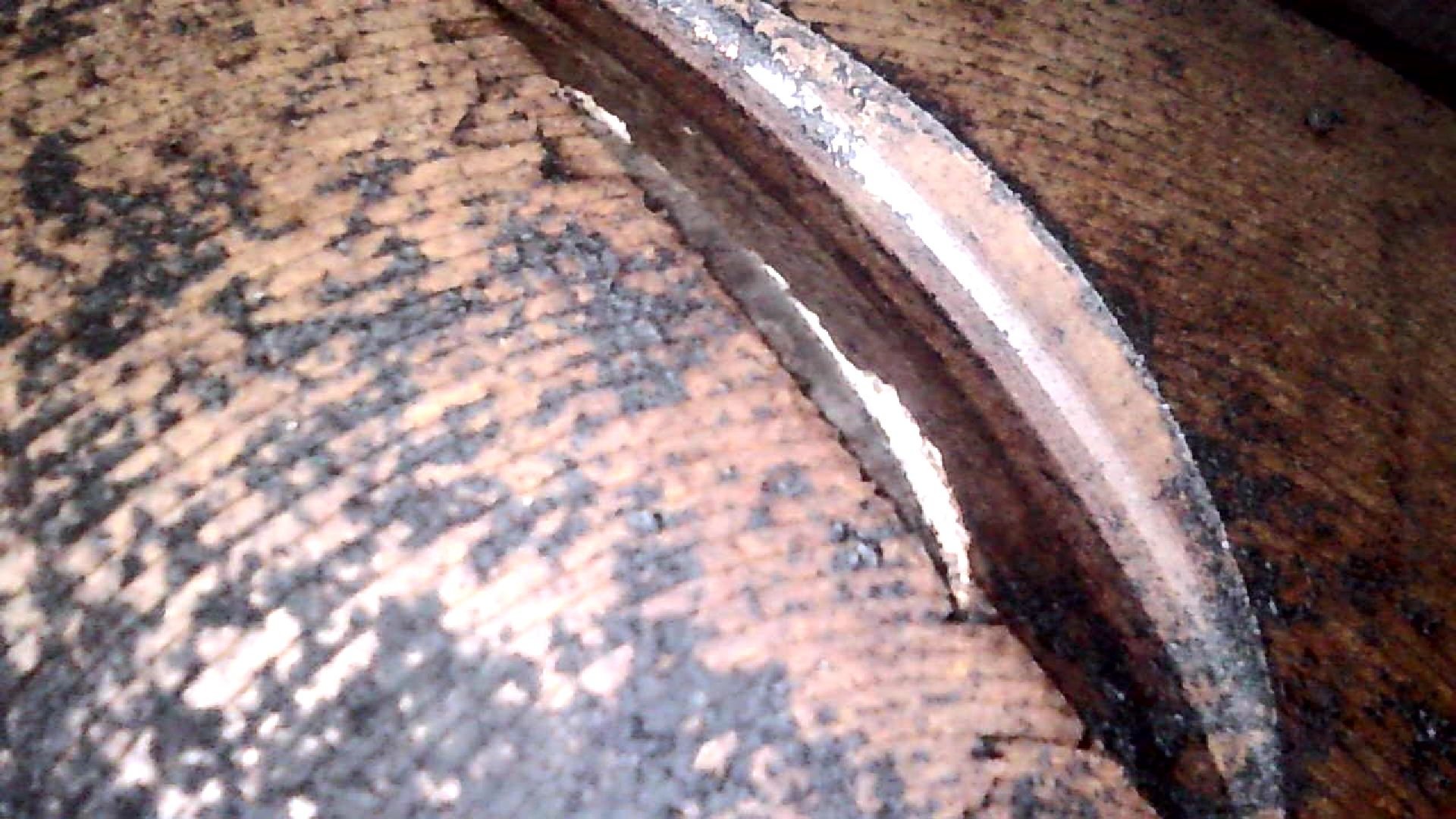

Unfortunately, the borescope shows a damaged piston on the cylinder with 0 compression (trying to upload a photo here). I agree the timing was off so much at some point that it likely damaged the pistons, valves, etc. I think this confirms that the whole engine needs to come out. I could not really maneuver the scope towards the top of the cylinder to check the valves, but after I saw he damage to the piston, I just stopped because I knew at that point the whole engine needed a rebuild (I think, anyway).
I think I either need to pull and rebuild the original 307 (likely $2-3k), or buy another sbc engine to swap in as-is (which is another risk). It's the worst possible scenario for this situation, but it is what it is.
I would be grateful to hear any advice you guys may have. I really did want get it running, as my mom is sick, but it doesn't appear likely at this point. It may be worth spending $2-3k now to then sell later, but I don't know if rebuilding the original 307 (to keep the entire call all-original) is worth it, or if rebuilding a donor 350 would actually be more desirable to a buyer later. Or, perhaps just sell the whole lot now and let the next person deal with it (and maybe promise a ride when complete).
