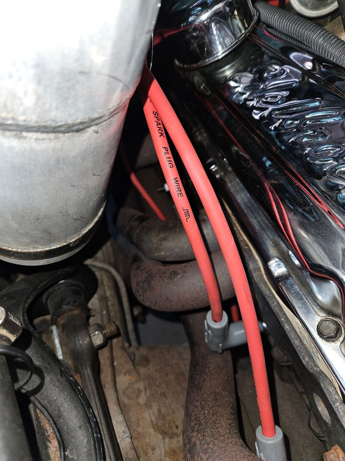

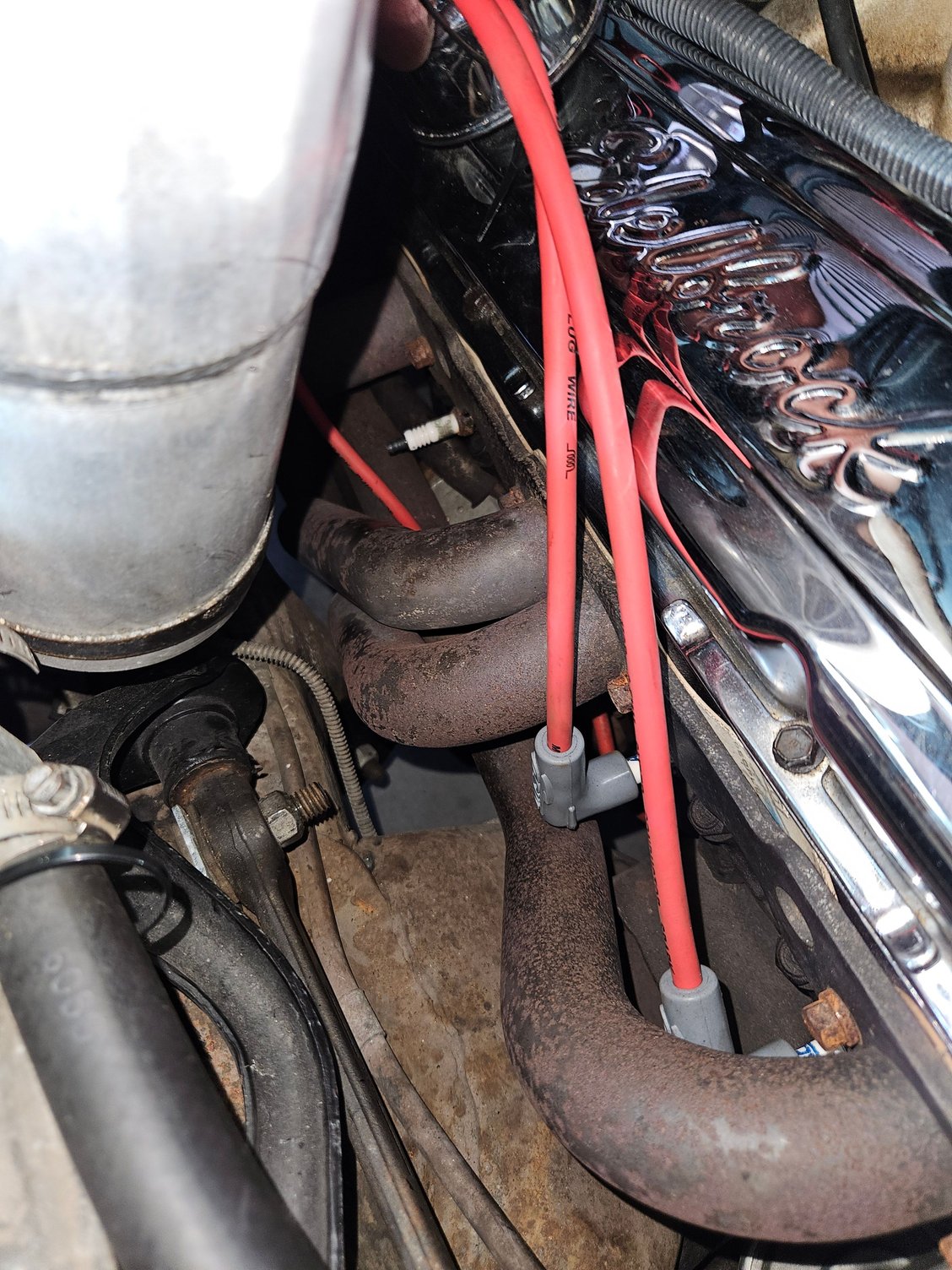

only issue is number 6. The clearance is soooo minimal as in its just not touching anything. Any ideas on a good set of looms or keepers or whatever they are called to keep the wires from melting on the headers? This is a "not stock" 350 in a 1979 with hooker competition headers. Only cylinder 6 has this odd issue.

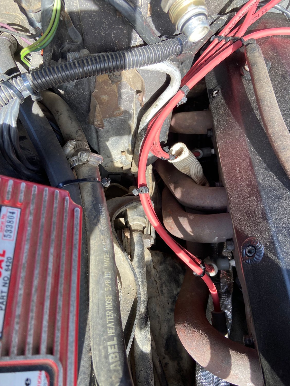

Here is pics of my fix I used zip ties for wire separators too.
