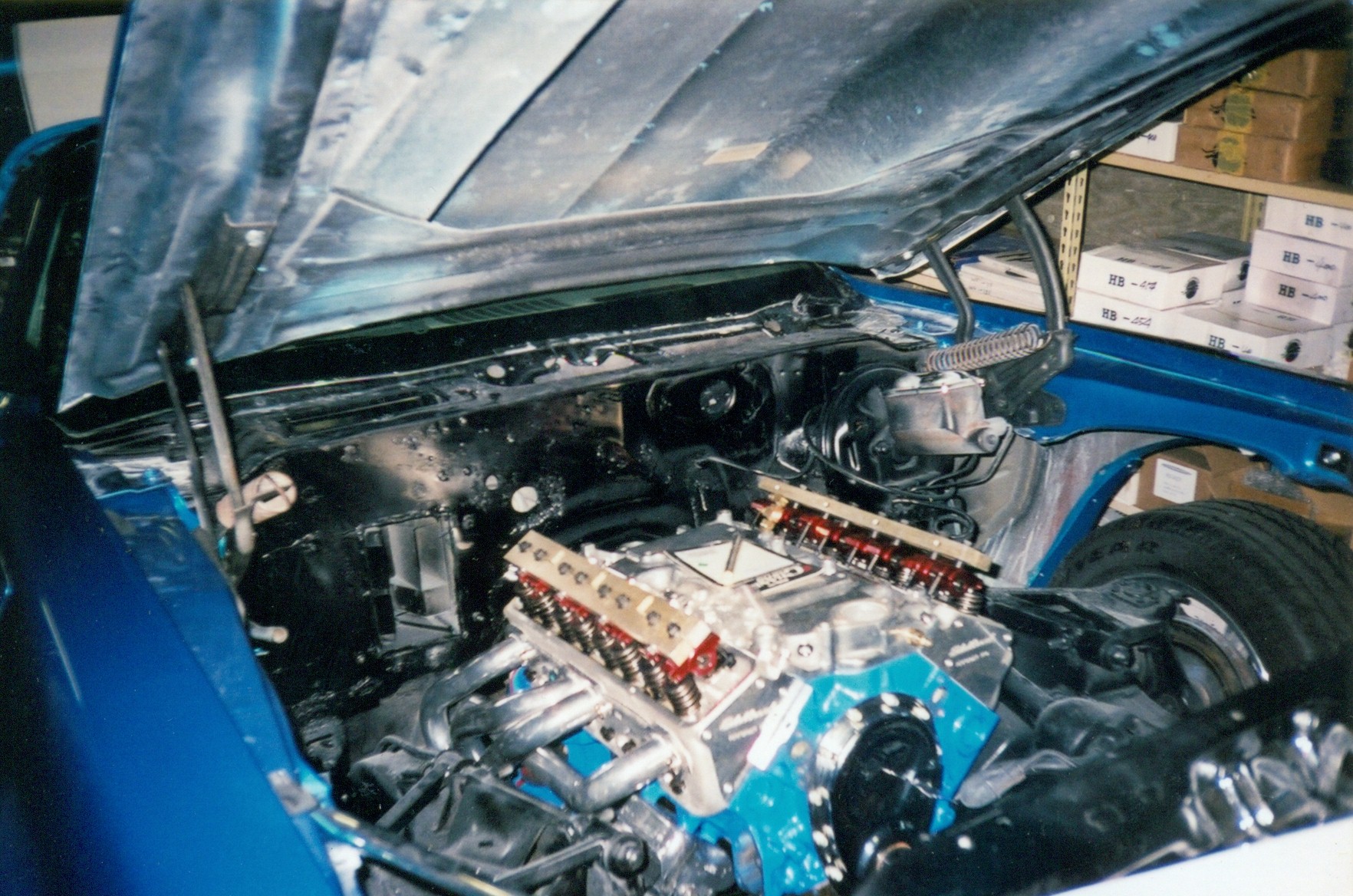

Camel hump heads are very "old tech".And with all the machine work you will have to do to run on today`s gas.Like screw in studs,drill and tap it for the newer brackets. and harden seats And you don`t know if they are cracked. It would save your money and buy a newer set of heads,I have run Dart II`s and Eldelbrock Performer RPM aluminum heads and were happy with both.And there are a lot more from Chevy and the aftermarket.Your choice.
