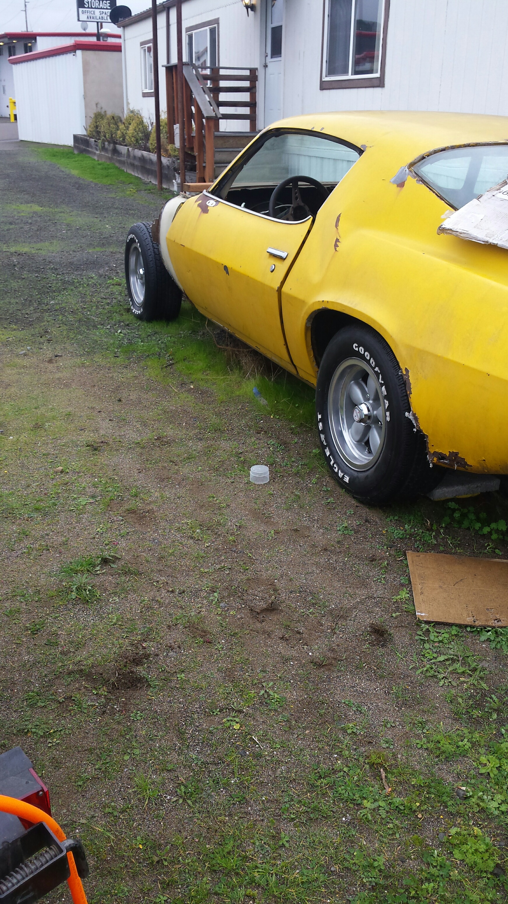

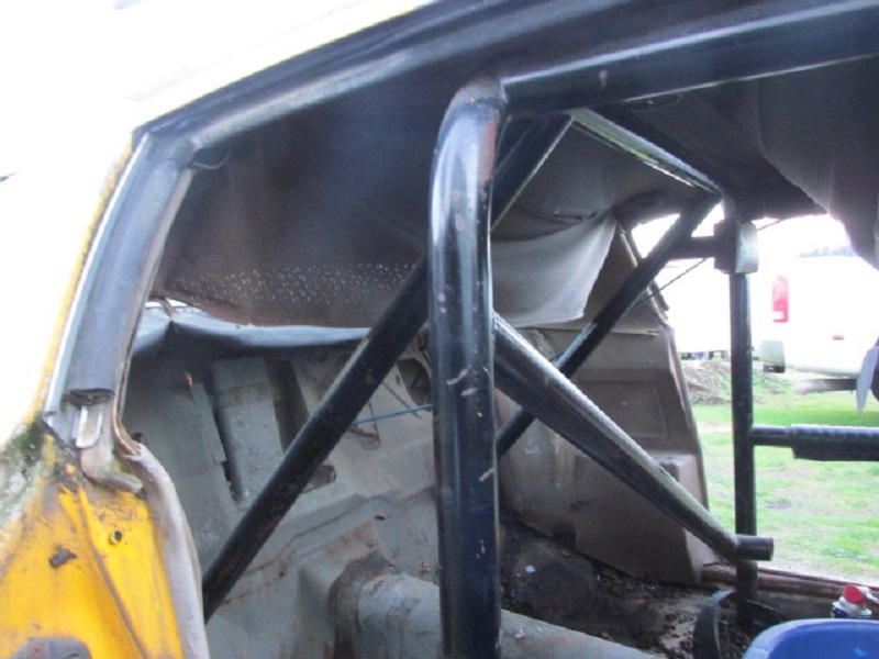

I found the original Popular Hot Rodding '71 Camaro in Portland, Oregon a couple of years ago. The car showed 41,000 miles, had all of the Bonneville safety stuff, roll bar, etc. The car was built to run a Ardun headed Ford flathead with supercharger and injection. It also had a fiberglass one piece front end from a 74 and newer Camaro, but this was long gone.
I toyed with the idea of returning it back to the way it was built, but, hey? A flathead Ford in a Camaro. I couldn't do it. So I opted to build it as a 1971 Camaro. It has been a longterm project and I am still a long way out. I replaced both quarters with AMD sheetmetal. They were repairable but I wanted to replace the outer wheelhouses. The biggest project was removing and replacing the lower cowl under the windshield. That job really sucked.
The car has a 12 bolt rearend and was equipped with a Richmond 5-speed at one time. Since that piece was also long gone, I'm going to run a Muncie. I haven't decided on an engine yet, I have an LS engine with custom intake and injection pieces, but a nice LT1 from an early Camaro sounds nice too.

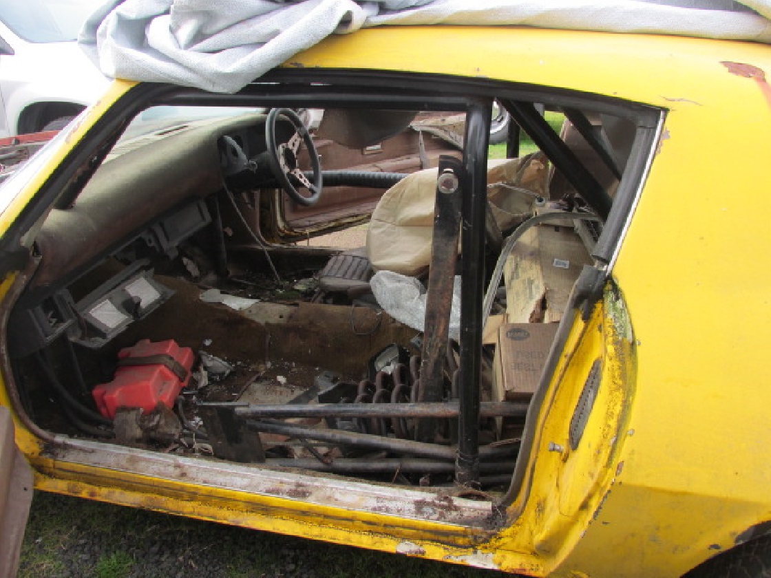

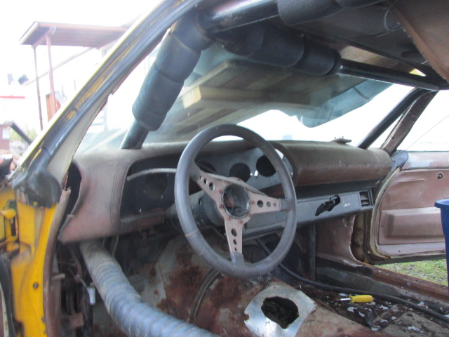

The car was in amazing condition, considering it sat in a backyard in Portland from 1981, uncovered, The floors, with the exception of the toe boards were very solid, as was the trunk floor. The car had had a buildup of moss on the upper cowl, which kept that area wet and it took out both the upper and lower cowl.
But the car was nice enough to bring back to life. I have been picking up original sheetmetal for the front end as I find it. I picked up an original 4 speed console for it. I still need a lot of parts, but I work on it almost every day.

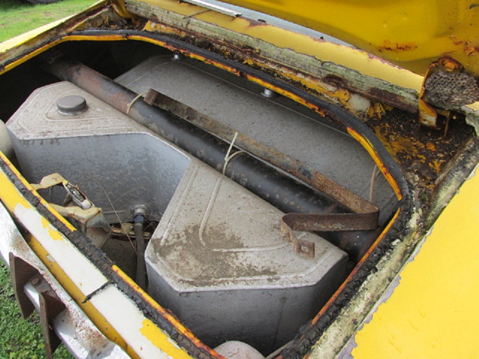

I started out as a Mopar guy, actually owned 4 different 426 Hemi cars. I transitioned into muscle cars of all makes, even owned aa 1969 Ford Talladega. I like working on Chevys because of the parts interchangeability. I always loved the Gen ll Camaros, so this one has been fun. Because the car had a large aluminum water tank, with metal safety guard underneath it, the trunk floor was saved. Everything else is available, even though I am still trying to figure out what it is missing.
