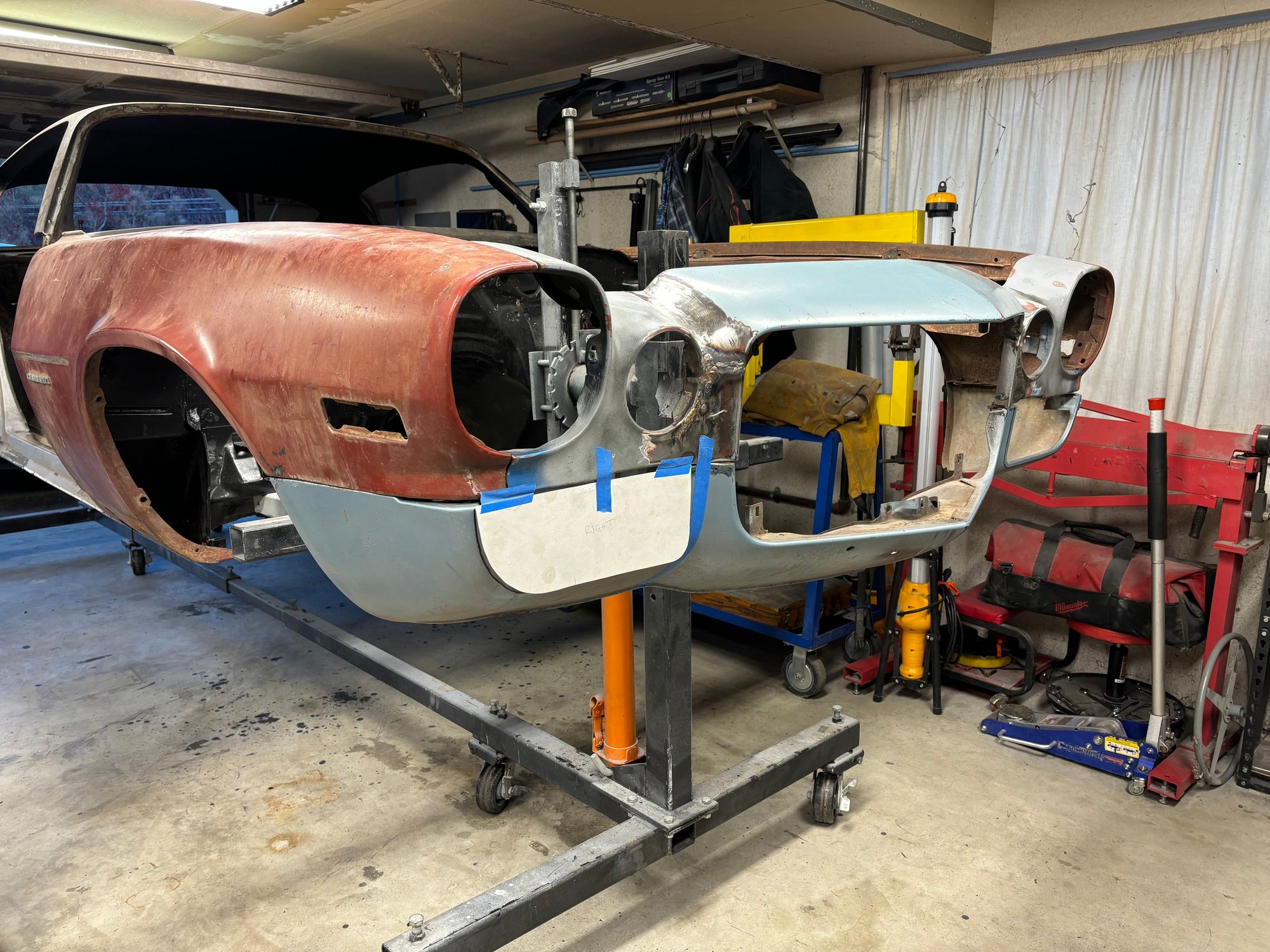

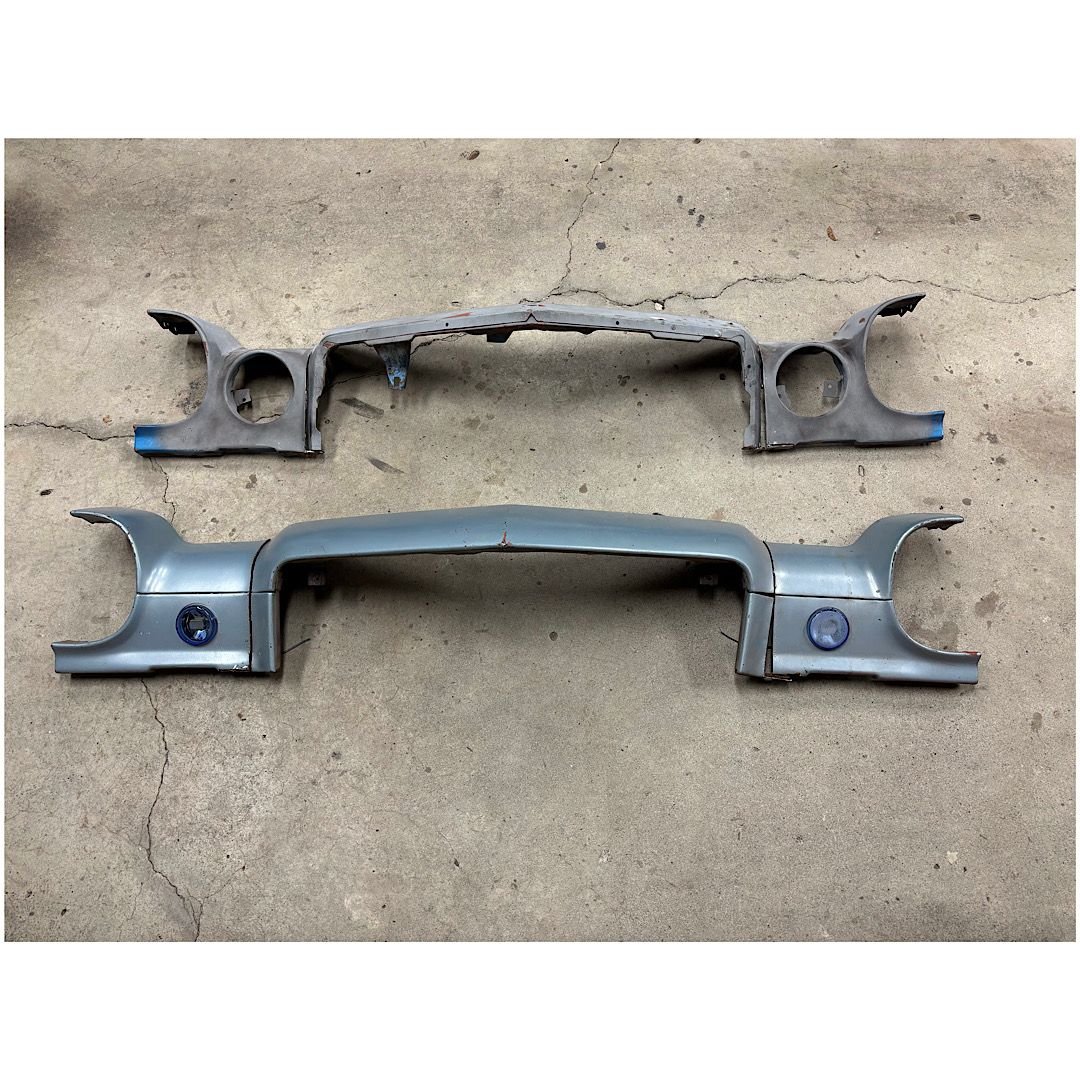

It began as a standard front nose and an RS upper valance
Mocking things up
Mocking things up
Two RS upper valances, one standard upper valence, and one standard lower valence
Added bumperettes to make a one piece front nose

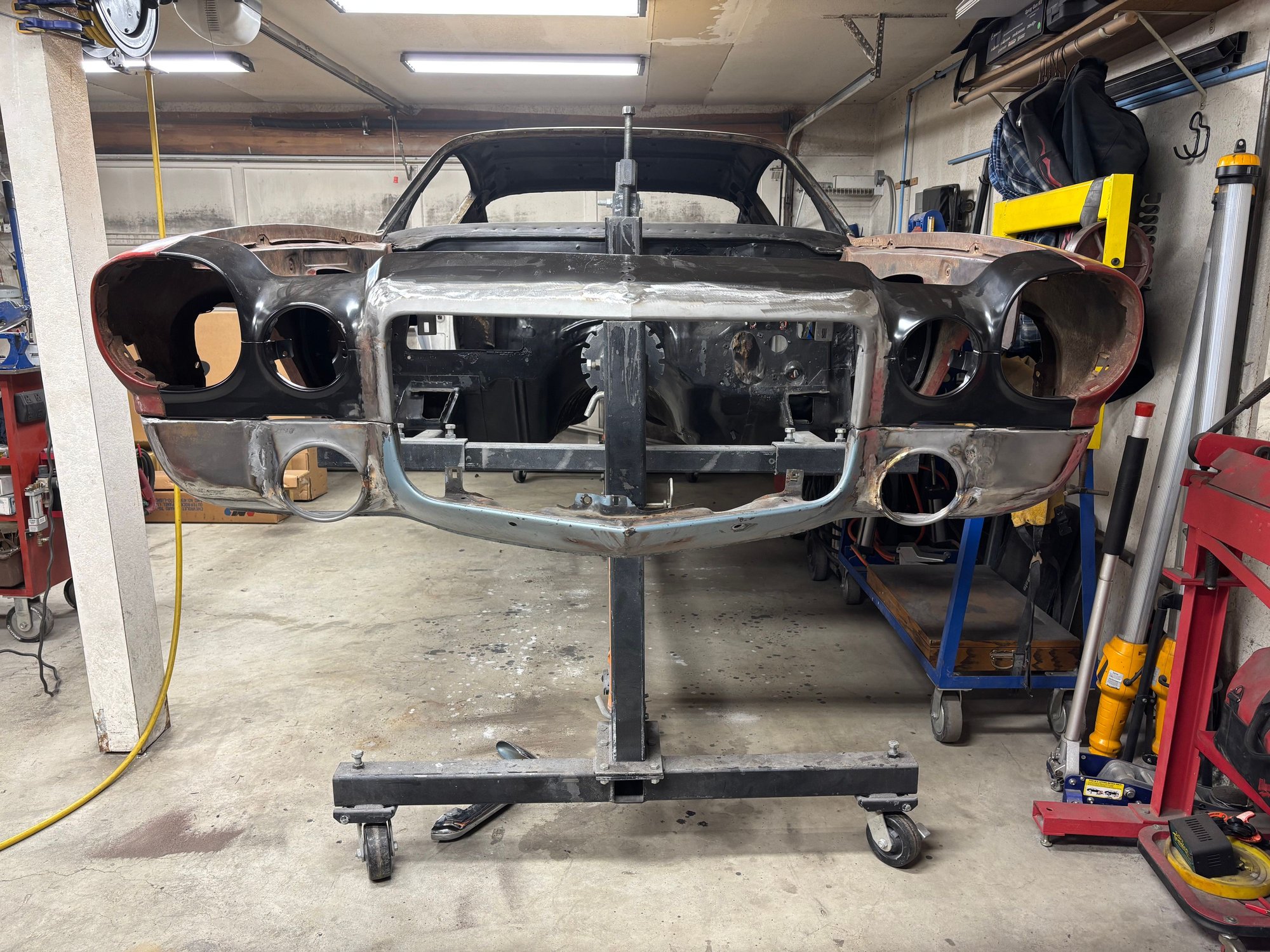

I am making a unique one piece front nose for the 70 build. This is a mashup of two upper RS valances, a standard upper valence, and a standard lower valence with trimmed down bumperettes. It is all metal and will use the one piece standard grill. Two of the 5” round housings will be turn signals and the other two will be cold air inlets. I plan on a flush rear bumper to match the front.

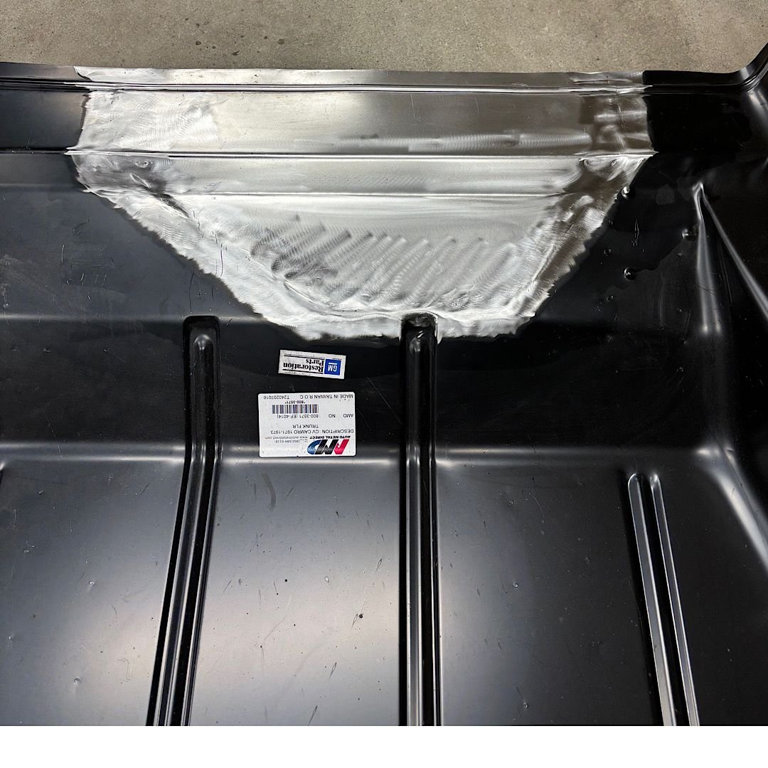

The 1970 Camaros did not have a fuel tank evaporator canister, so I had to modify the trunk floor to fit.

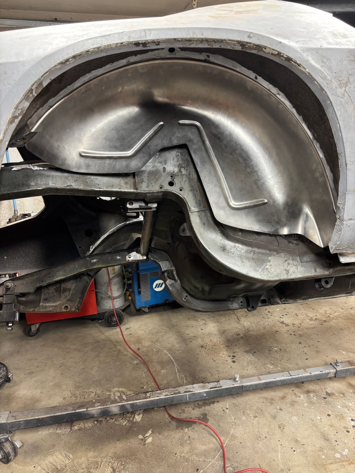

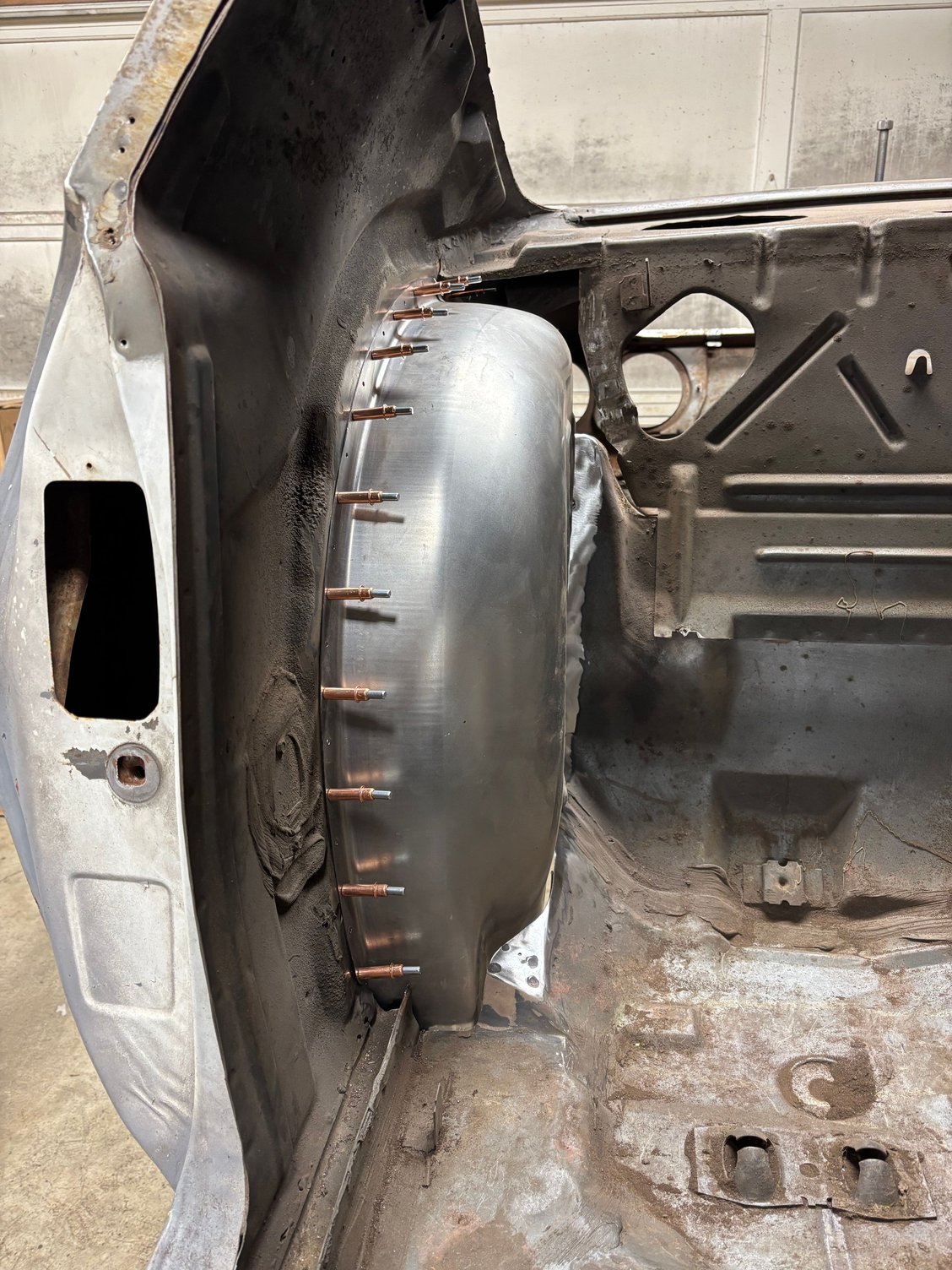

I decided to put mini tubs in since I am replacing almost the entire rear half of the car.
Fitting the new tubs.
Ready to weld, but I will finish the trunk floor before I finish the tubs. The rear valance and both quarter panels will come next.
I’ve started the sheet metal replacement. Almost the entire rear half of the car needs replaced. I’m starting with the trunk floor and mini tubs, move to the rear taillight panel, then the left rocker, and finish with both quarter panels.

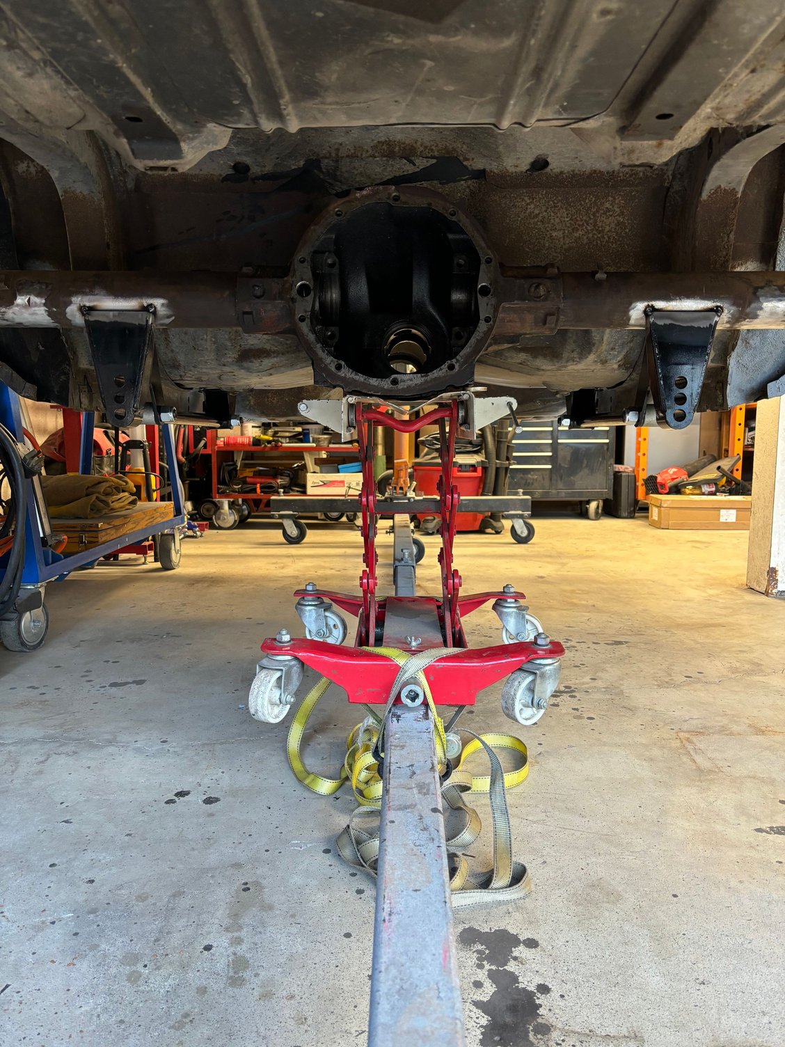

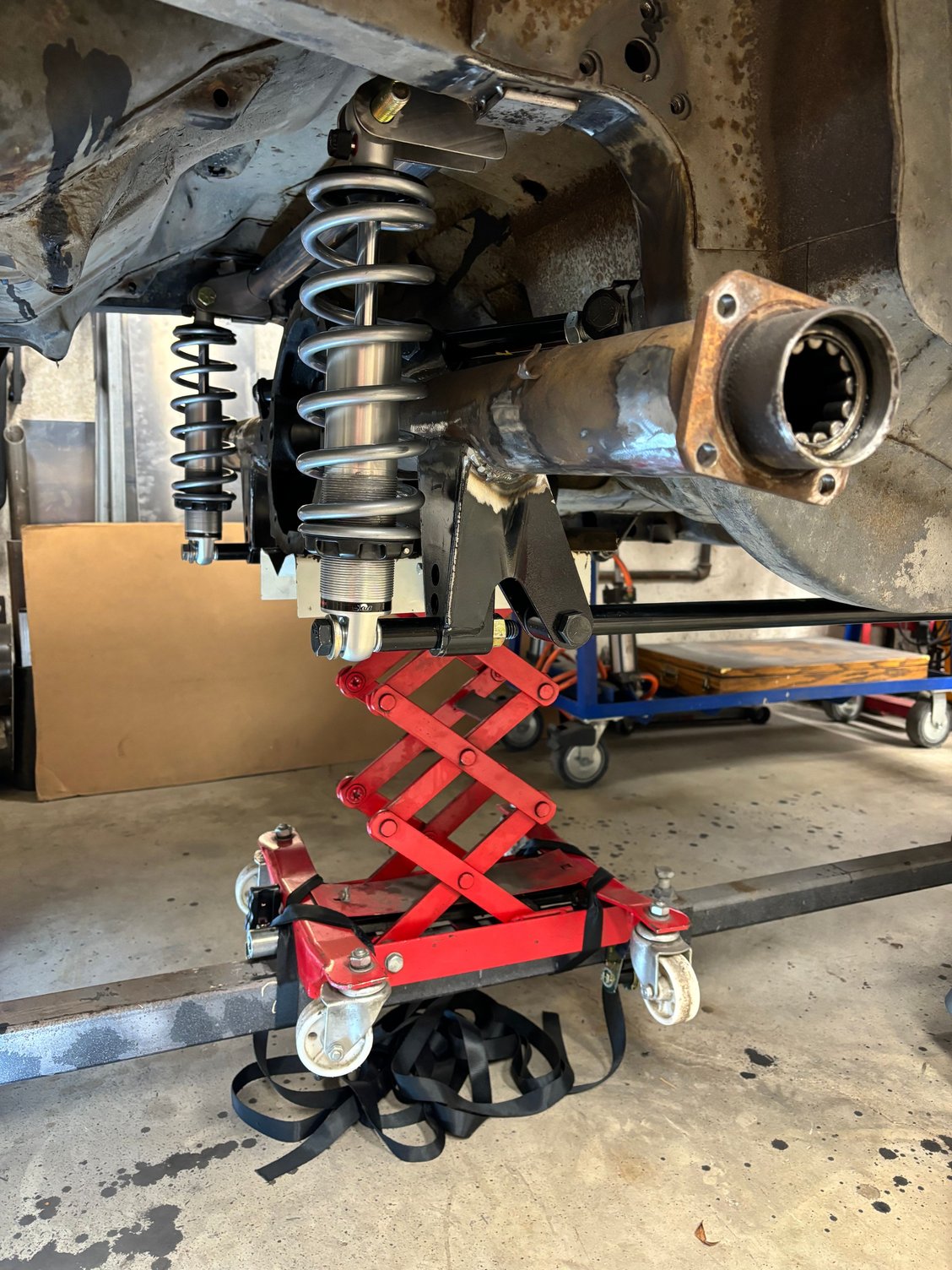

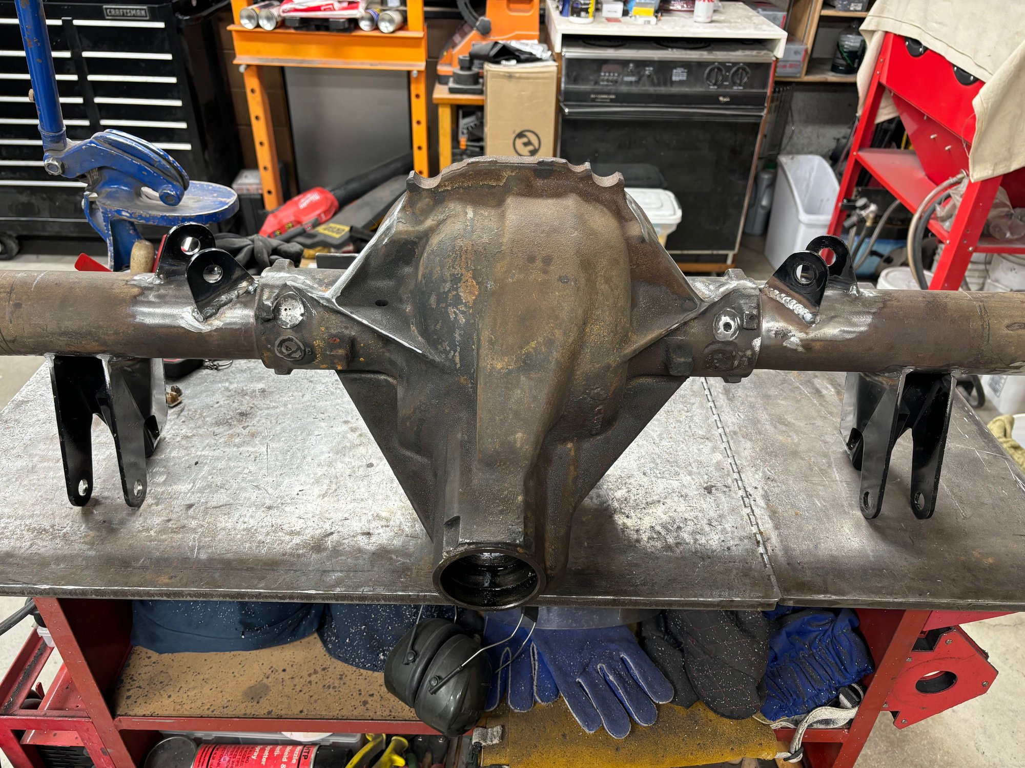

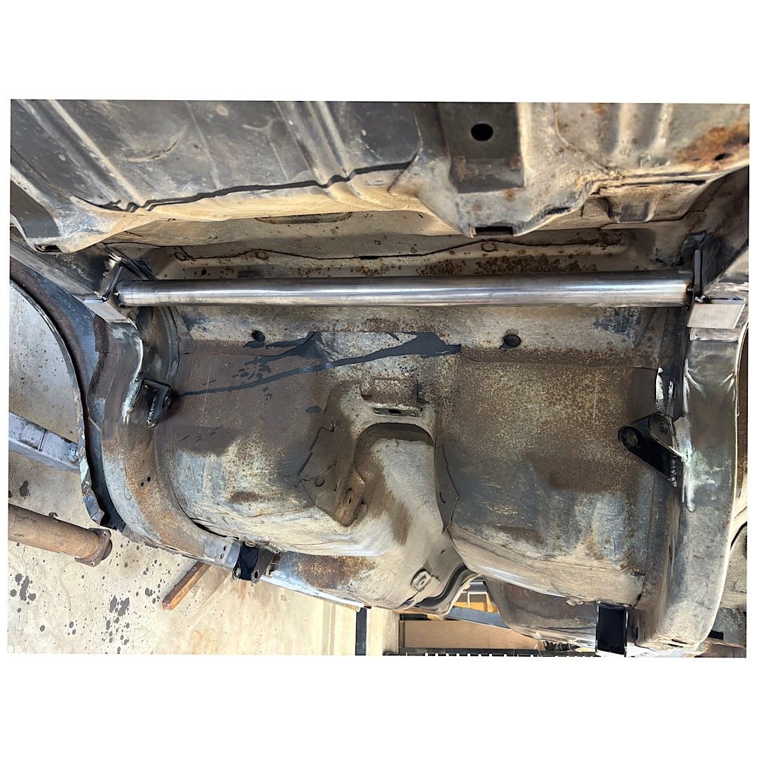

I almost forgot, I am also converting from leaf springs to a 4 link coil-over rear suspension.

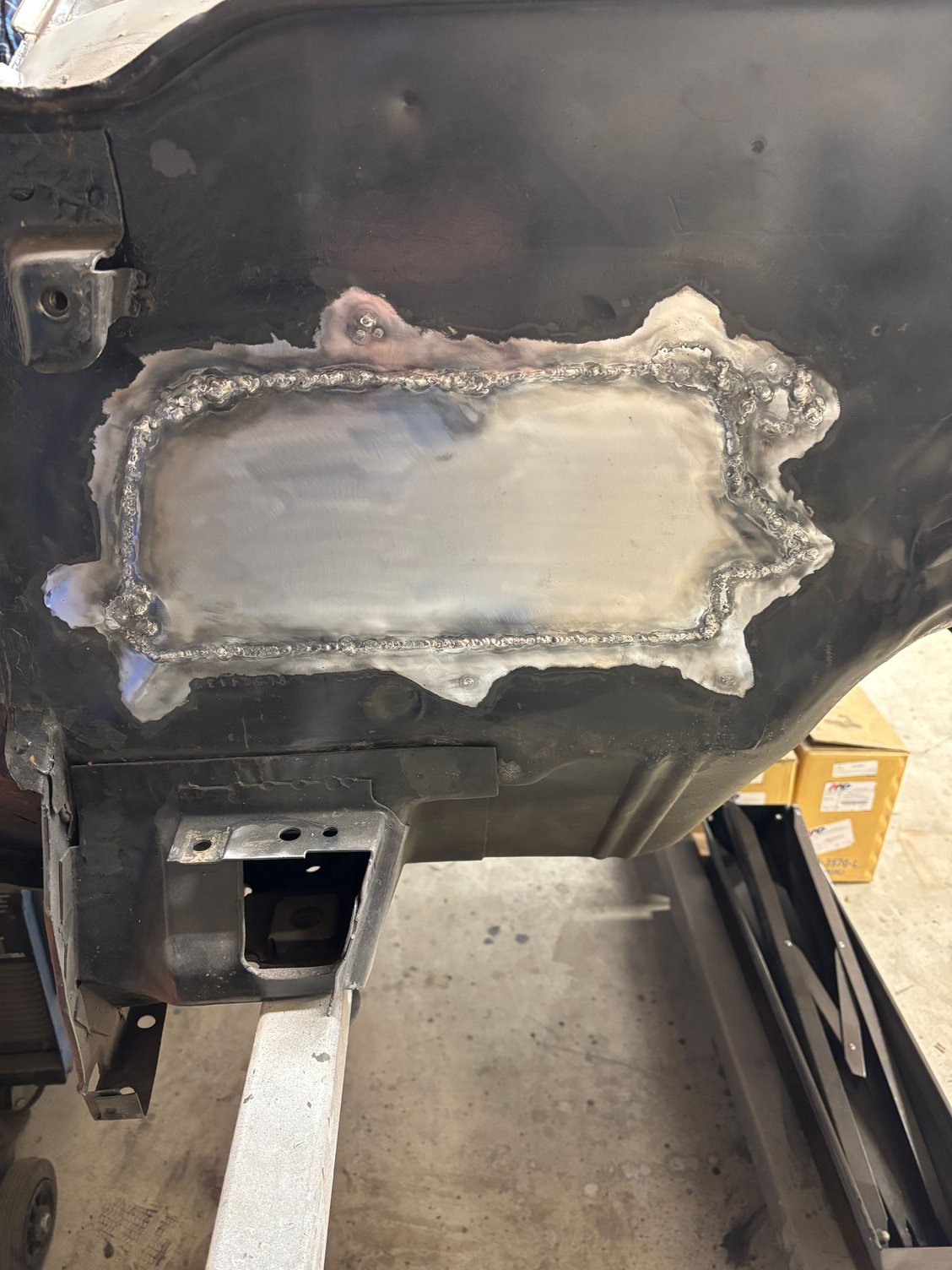

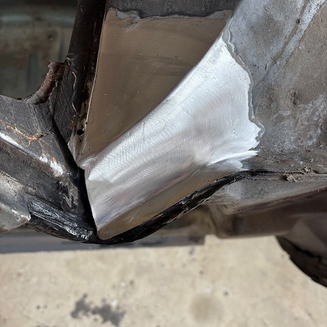

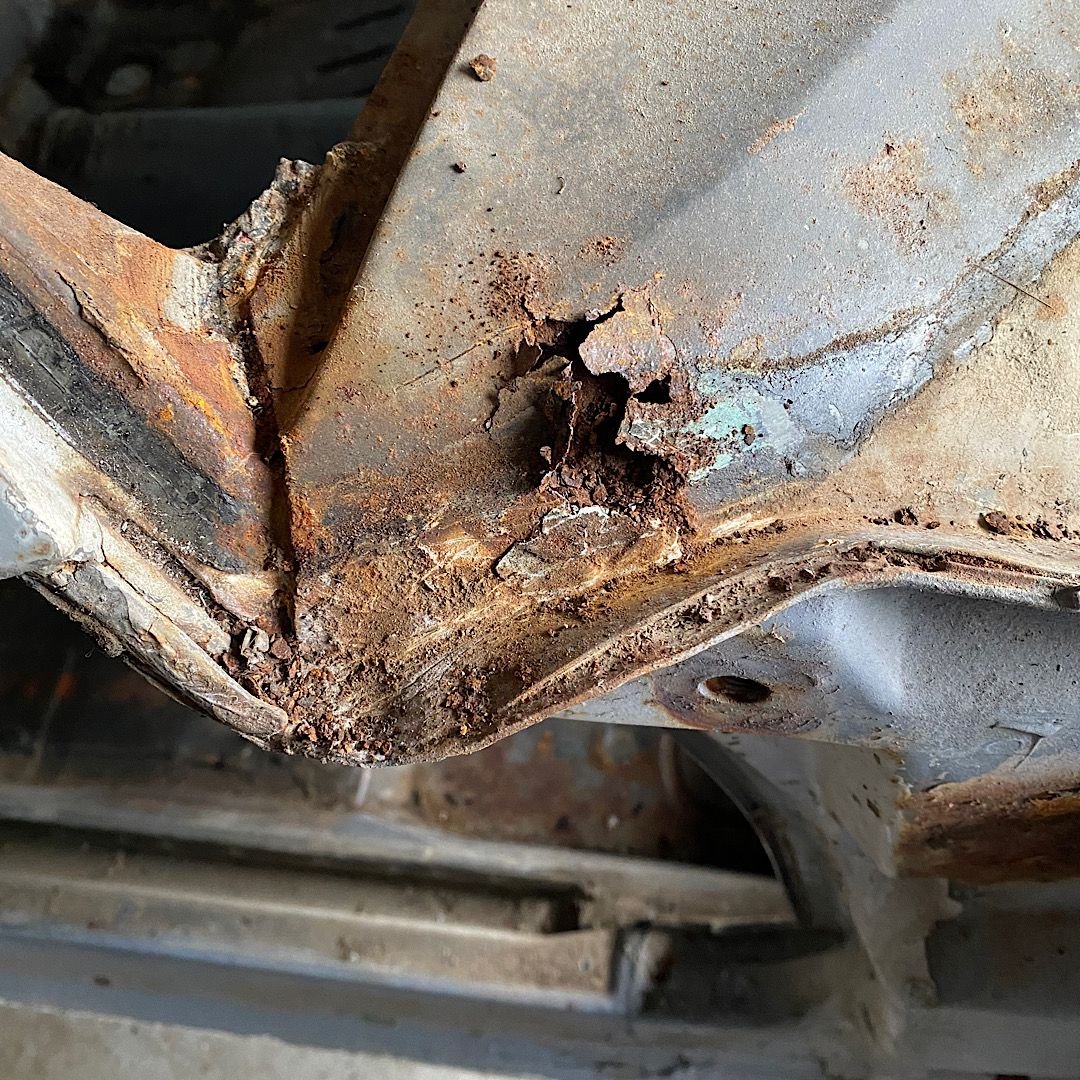

Just a simple patch on a common problem with 2nd gen Camaros. This was the last “repair” that was needed on the car. I am still in the process of replacing most of the rear sheet metal in the rear of the car and I will post those as I finish them.

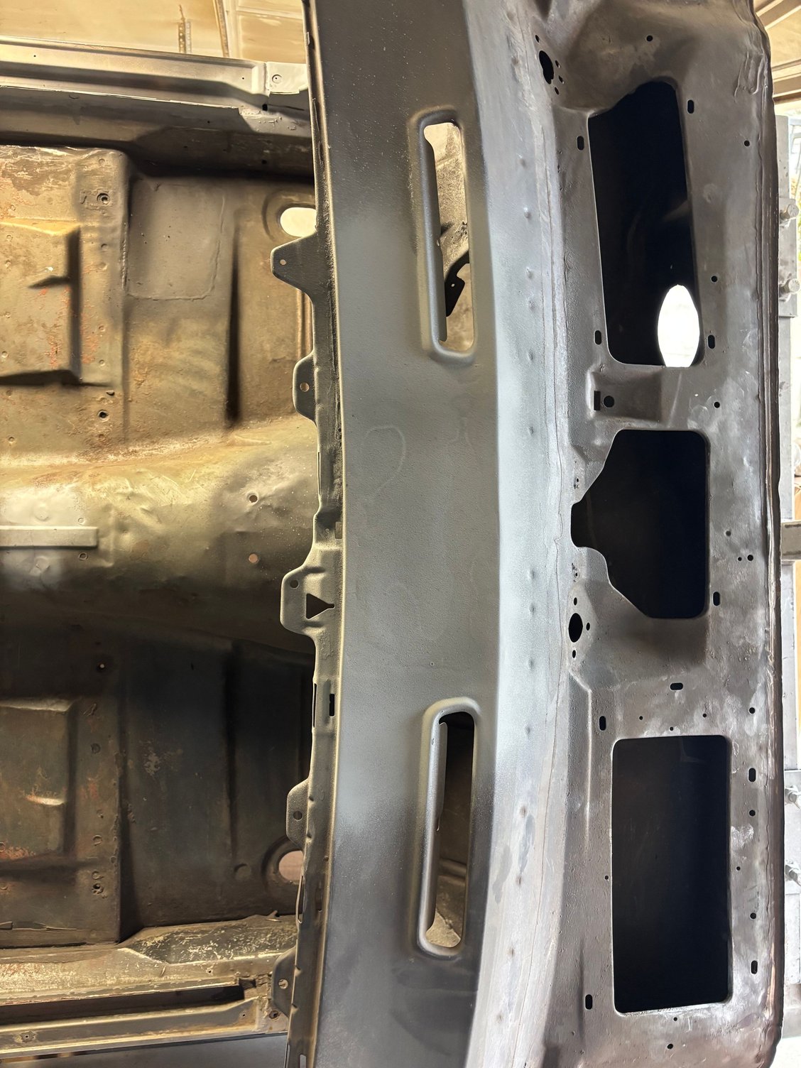

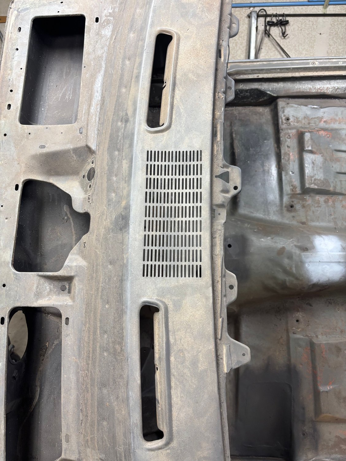

I eliminated the front speaker grill from the dash. This is one of those things that most people don’t do, but I wanted a smoother look. We’ll see if anyone notices after the car is finished.
