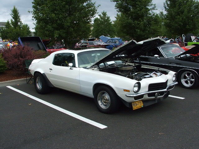

I'm still running the old school 14" rally sport wheels on my '71 Camaro. N50-14" on the back and 245-14" on the front. 7" rallies in front, but I had the centers punched out and 10" outter rims welded on the centers in the rear to accomodate the MT tires.
Keeps a stock look, without sacrificing traction.
