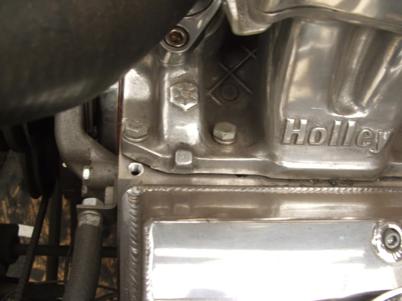

I still don't understand how you can drill out a hole when there's no material over it? I can clearly see the end hole on each end visable on my heads, so the old intake doesn't even cover the hole with metal that could be drilled?
I went out and took a pic of my intake and heads. You can see the one end hole completely exposed, and just see half of the other hole.:

  #17
I'll have to see if I can find a picture or if I have an archived article on the intake differences. The holes in question aren't the end ones. On the newer style heads and intake, only the two in the center, on both sides, mount straight up and down. The rest of the bolts are still angled like the old style manifold/heads are. Those center bolt holes on the manifold are the ones you would need to hog out to get the bolts in vertically, with using washers or a spacer under the bolts.

  #18
Thanks Chuck. Wonder what the other vertical holes are for on these heads I have?
Edit: I amswered my own question. Went to Summit and brought up a Vortec intake. Those holes are for the Vortec intake. Here's a view of the Vortec, it appears to use all the holes my head have:
