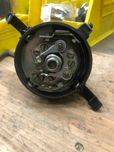

Originally Posted by Gorn
I do not think GM made a car without Vacuum advance since WW2.
There were a few in the 1960's high performance applications that had Delco Remy manual advance dual point distributers.
Not that the OP's six banger would have even had one.
Delco Remy Dual Point Distributor - Picture 1 of 5Delco Remy Dual Point Distributor - Picture 2 of 5
