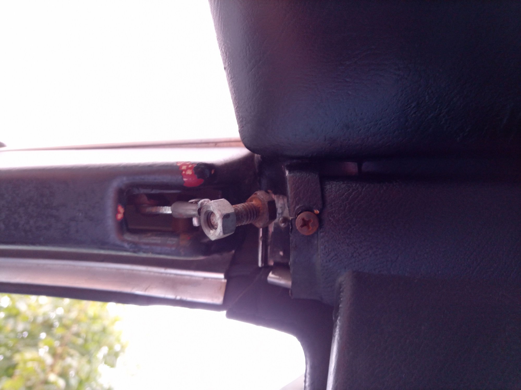

Literally here to figure out this solution in Oct 2022 haha. The passenger side I think is missing something at the rear part where it connects to from the glass to the body over the passenger window (not the inside center of the body. I'll try to snag a picture. I don't know what the piece is called so maybe someone can identify it. I'll post pics shortly in this thread.

Originally Posted by Yracing02
So? Other people with this problem could see this and could help them
So my question is this. When the handle is down to release the t-top, it releases. When putting them back on and tighten them back up; are these doo-dads supposed to go into something? Also there is 1 linkage that is disconnected but doesn't seem to line up? Do I just "persuade it" with the screw?
