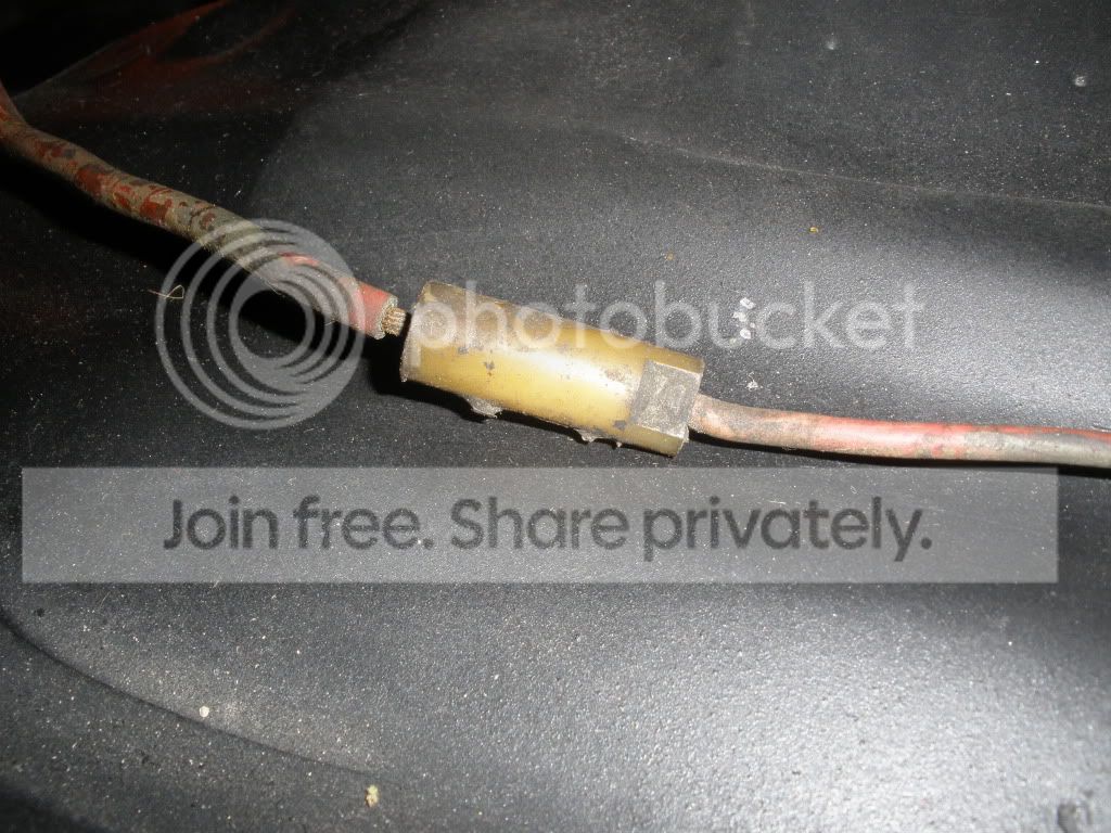

my question is, how does that one actually work, is the wire itself the fuse? the blue connector? sorry if its a dumb quetion
on my old wire it has the big inline fuse

The blue connector is just a crimp connector.. the wire it's self is a fuse... it will melt at too much power going through it... it also sends up a nice smoke signal when it blows too... now you need to re-route those wires or rind a heat wrap to protect them.... for an emergency repair you can replace your old Fused fuseable link with a hunk of regular 14guage wire to get you on the road till you can get the proper link in there.
