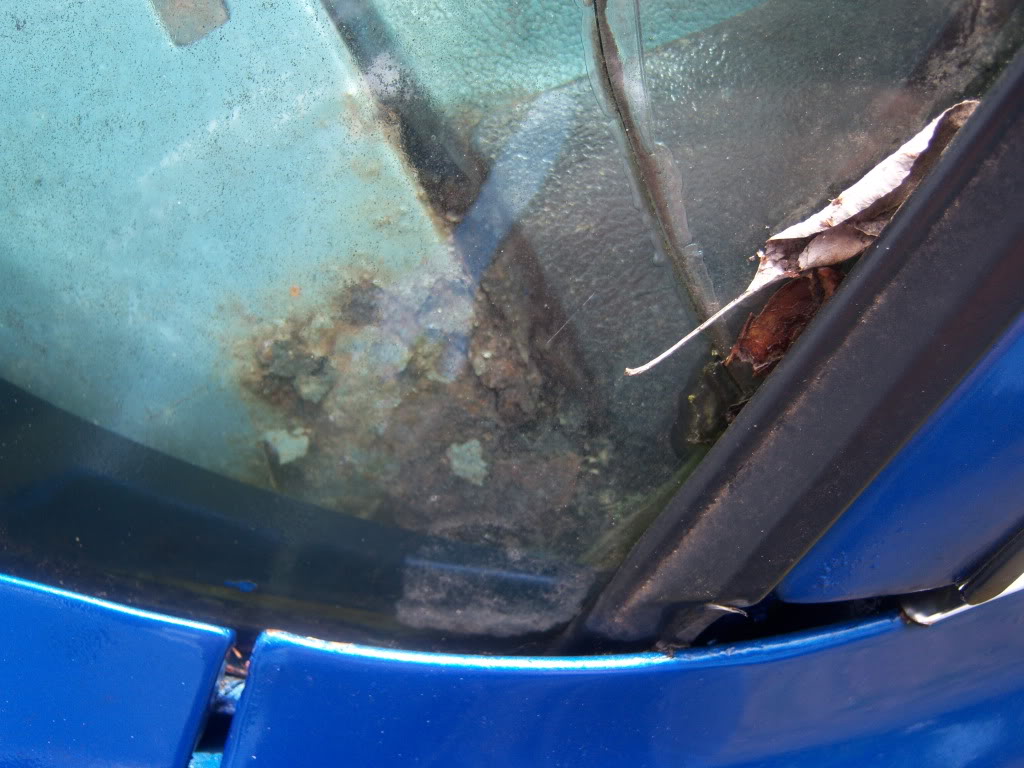

Look here for rust and a bad windshield seal. Even my 50.000 mile car has a bad seal.

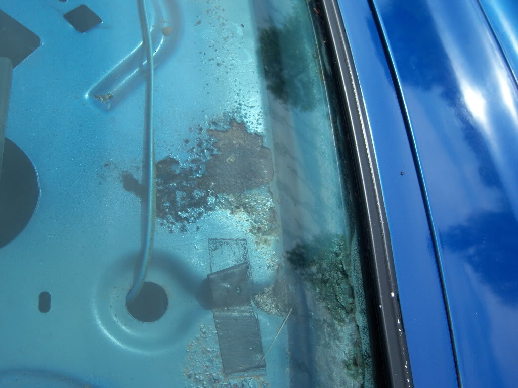

Under the back dash too.

Hey I have that same problem on my front dash, how are you going to fix yours? Mine is through, I was thinking of just cutting a piece from a donor car and welding it on, sort of afraid of messing up the vin. I would definitely buy that car, does she have all the original paper work? since she is the original owner?

If you were asking me. I bought another car. I have seen people replace the cowl piece. They repop them. The problem is the seal. It dries and shrinks. From what I've read when the windshield is resealed with that caulk stuff the windshield sits alittle lower and the trim sits funny. I would rather that then having a nice car rust there. Heres the pic that didn't post.
