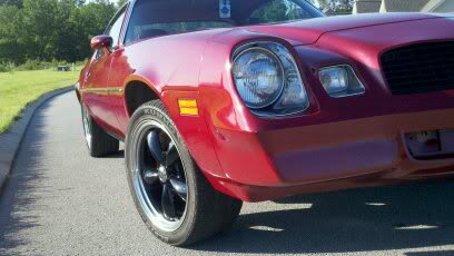

see the gap in the front? i want it gone. i think my car is so high, im not sure why, i can do it pretty easily. i want it done right though.

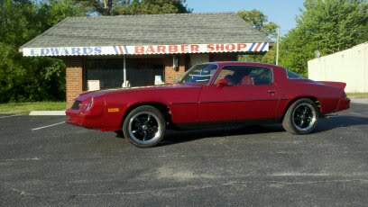

Old Sep 15, 2011 | 10:30 PM
bmorrow's Avatar
Joined: Apr 2011
Posts: 12
Old Sep 15, 2011 | 11:44 PM
Something is not right about that. It looks like it has spring spacers in it. You could get stock springs and bring that down 3".
The passenger side looks higher than the drivers too. You need to look into your front end and see if the coil is located proper in the subframe. There are tabs that for a circle up there, they should all be inside the spring.

Probably just has new springs that haven't settled yet. I'd swap them out for 2" lowering springs and it will be great. I think you'll regret going 3" once you start dragging the undercarriage on everything!
