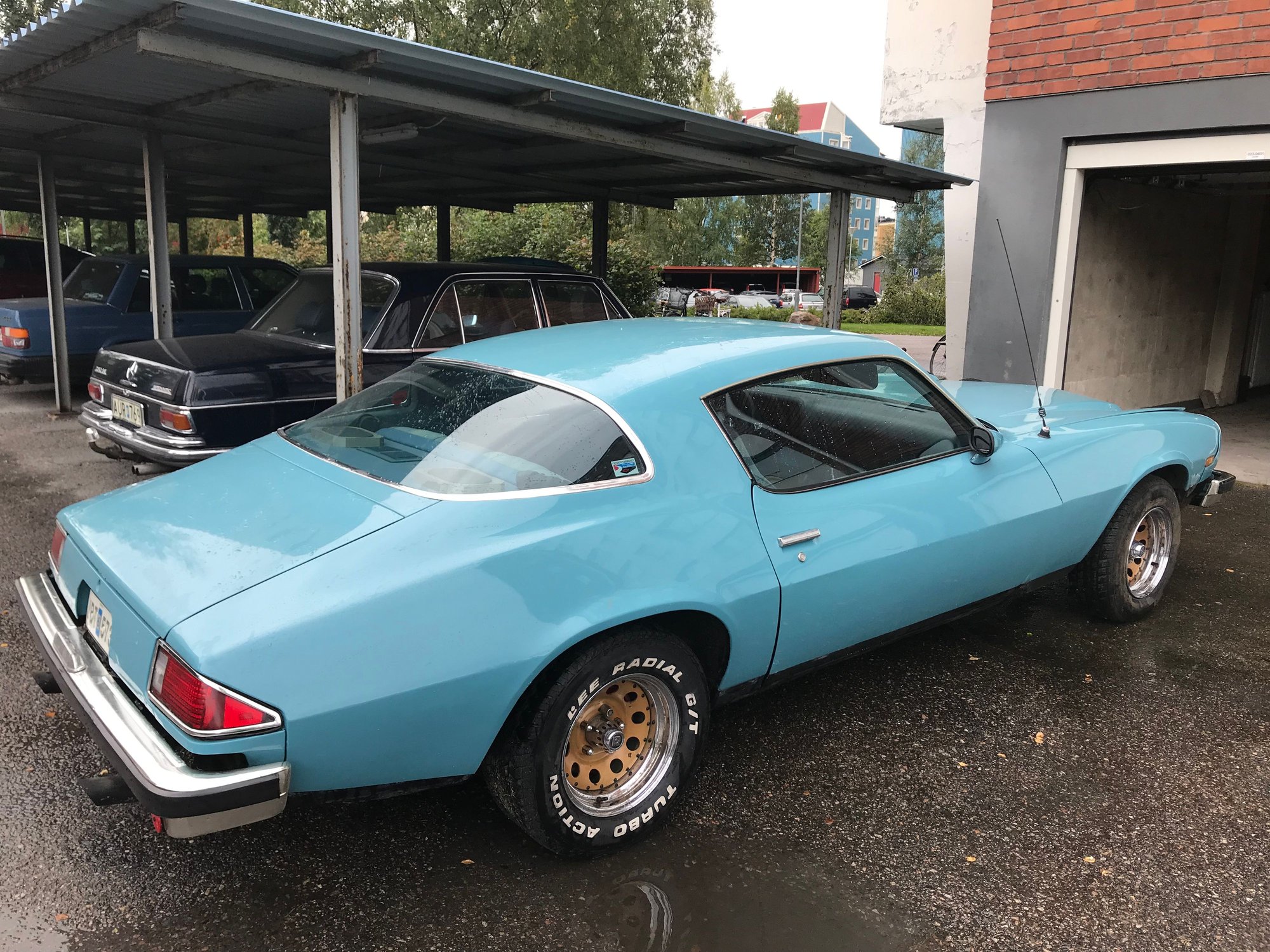

Old Sep 15, 2019 | 07:21 AM
Nosse's Avatar
Joined: Sep 2019
Posts: 7
Default Gearing
Started the car and got in the reverse gear so backed it out and let the engine get warm. Washed the car lightly cause it was so dusty all over.
Could not get the gearing into drive after that, had to push the car inside.
The oil stick for the gearbox showed 1-1.5cm oil at the bottom when cold but nothing at all when the car had been warm.
Do you think it was because of to Little gearingoil it would not Shift into drive?
Old Sep 15, 2019 | 09:56 AM
Do you think it was because of to Little gearing oil it would not Shift into drive?
Could be,the auto-trans fluid level needs to be checked with the car warm and running not cold like the engine oil.
It's best to put it in each forward gear for a few seconds before checking it too.
Your car has been sitting a long while,I'd put it in drive after putting it in each gear for a few and then let it idle in drive for a while like a minute or two and see if it doesn't start trying to go into gear then put it in park and check the fluid level.
Don't overfill it,just put in a pint at a time and repeat the process,hopefully she'll come back to life.
Nice looking car by the way!
https://www.yourmechanic.com/article...c-transmission
Old Sep 21, 2019 | 09:18 AM
Nosse's Avatar
Joined: Sep 2019
Posts: 7
I followed your advise and after filling 2 liters of dexron gear oil it came alive and could shift in all gears.
Took it for a short drive.
The oilstick still only shows à Little oil at the bottom. Before i filled it was completley dry when warm. Need to Byy more oil and fill in some more i guess?
Is it normal that you need to fill this much oil in the gearinbox..?
Old Sep 21, 2019 | 11:55 AM
I hope you meant auto trans fluid and not actually gear oil because they are very different products,at any rate it seems it was indeed pretty low and could probably use a little more but I'd start with maybe half a bottle after another little drive around to warm it up good and then re-check it (with the engine running) before adding any more.
Glad to hear she came alive,great news!
