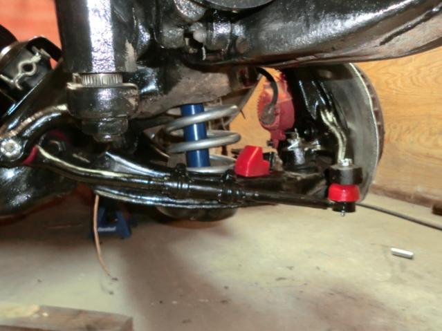

I.m painting my car red so I went with the red and lolts of lube. The bushings were easy. The springs were a challenge. LOL

I had the same idea to go with the red dust cap and probably red bushings as well, suspension black along with subframe, and steering is all silver Rustoleum Hammered paint.
