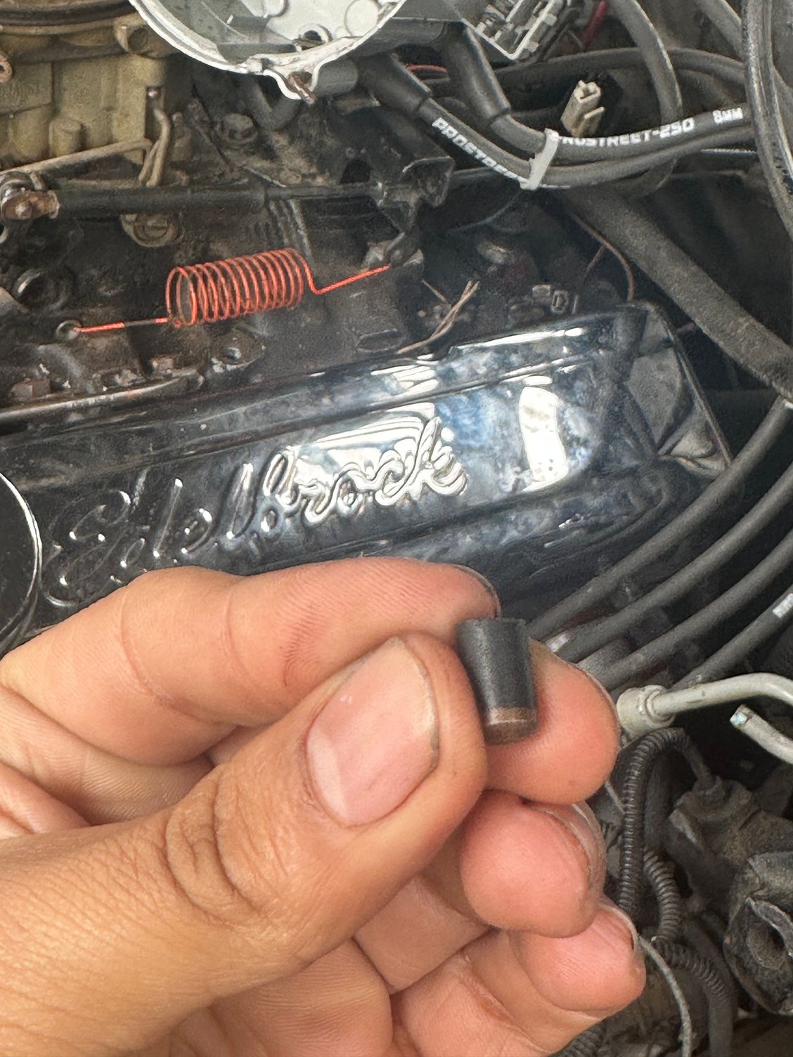

Took off distributor cap, and this little contact point fell out. It fell out when I took off the old motor as well but I thought it was normal and just saved it. I looked at it a little closer and it seems like it was broken off, there seems to be a piece of it on the cap itself still. And the piece I have in my hand doesn’t look like a clean cut. Again I’m not too advanced in distributors and gas in general I’m an all diesel guy lol. I’m hoping this is my problem.
Edit* Well I installed a new distributor cap and rotor and still no start. . There are spark marks inside the cap so I’m guessing it’s not a defective piece. I checked the gears for damage and it looks solid. I’m officially out of ideas. There are two small vacuum lines on the carb that are loose and free right now since the intake manifold doesn’t have the right ports as my old 350. However one of the lines is just for the choke on the carb, and the other goes to the top of the carb on the rear side. Would it not start if that line was not getting vacuum? Either way I hooked up a random hose I found lying around, it’s rubber and not the right size so I forced it into the vacuum ports just to test to see if that was the problem but the engine STILL did not start. Really not sure what else it could be
