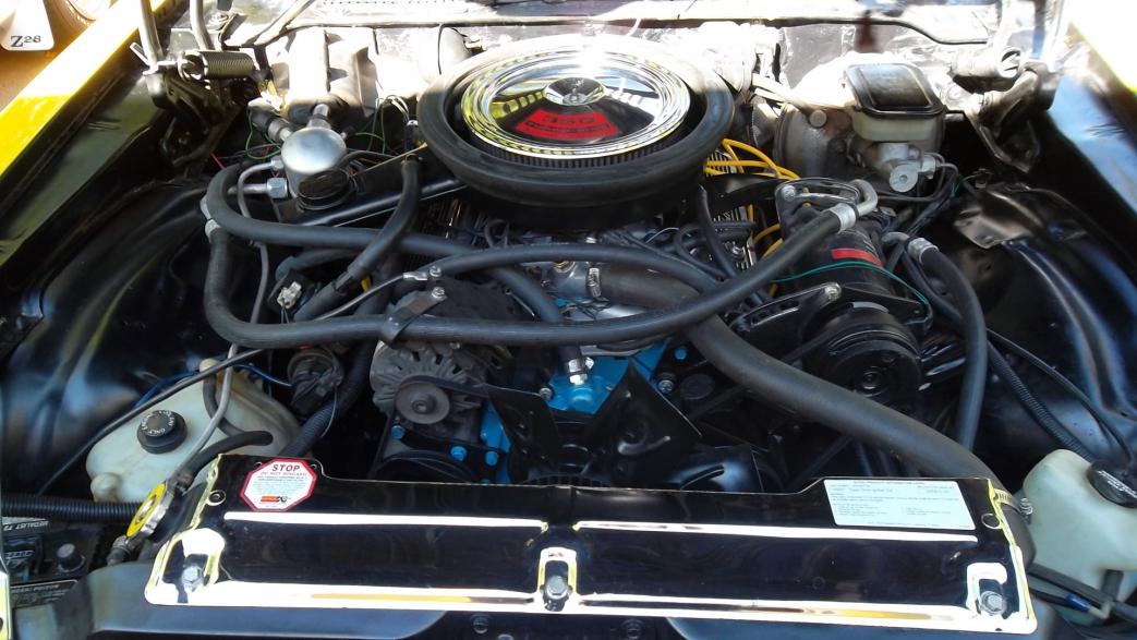

Hey guys, yeap, it's me again...lol Alright, quick easy question I'm sure for many of you... The Z is finally on the road and running great, I however live in Aurora, CO, so major emission laws out here... Naturally I've restored everything back to the way she should be, computer, cat, pump, etc., etc... Well took her to the emissions place, she ran perfect numbers at idle, but when they accelerate and hold at 2500 rpm's, she came in a little high on carbon output (hence burning rich), but not by much, I'm alotted 1.20 and she ran 1.70... Of course this being the computer carb, it's not adjustable, which I'm guessing means that my timing is just a smidgin off... Which way would I need to turn it to lean it out a smidgin?... Anyone know what timing mark I should be at for my altitude?... Also, I'm assuming that to set the timing correctly, I should unplug the computer connect, time it, then reconnect, correct?...
