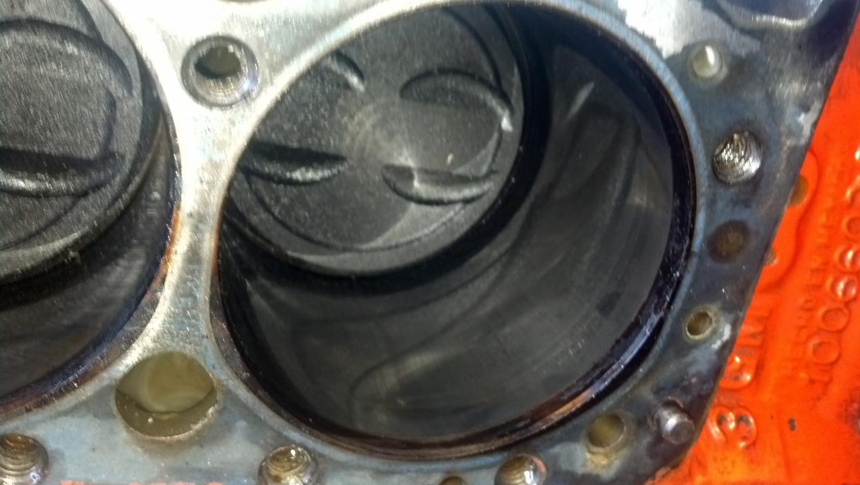

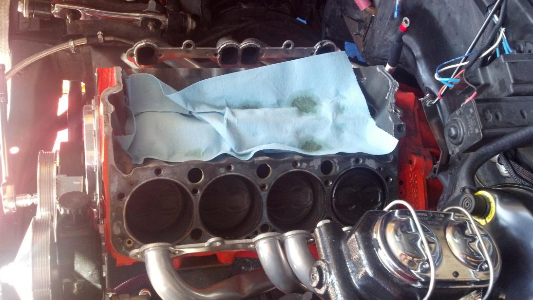

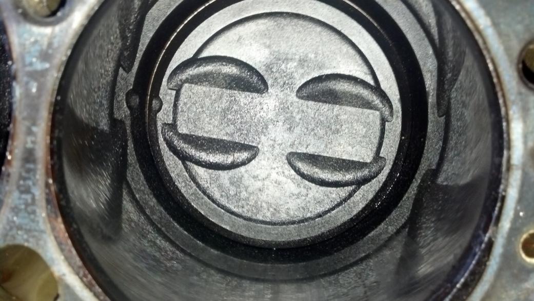

I did run it cap off and give or take about the same results... I have investigated it further and been looking closely at the heads and taking a ton of measurements of things. I am the kind of guy that wants to know why something is doing what it is doing. Use to take things apart as a kid all the time.. Did my first motor work back in the 70's and just never lost the knack for it. The heads are aluminum, Procomp, pistons stock 4.0 inch bore and checked the cylinder measurement's. Everything is right at 4.01 to 4.05 inches. The heads however were put on with incorrect sized gaskets from everything I have measured. The heads require a gasket of 4.150 to 4.185, .030 crush depth. I think as it appears the gasket rings actually sat right on the edge of the head and although fit the cylinder are to small for the heads. This would account for tiny amounts of water to slip in to the cylinder and would blow out the exhaust and not getting below the pistons to mix in the oil. Its all I can figure out so far and did not seal properly on number 7 cylinder. probably not a good seal anywhere but failed at number 7. So I have another engine on its way and I am going to rebuild this one with the proper gaskets..

Head gasket shown is correct size, but, may not be the correct material for alum.
Cleanest cylinder is the leaky cylinder.
Be sure to have heads pressure tested - could have an internal leak.
