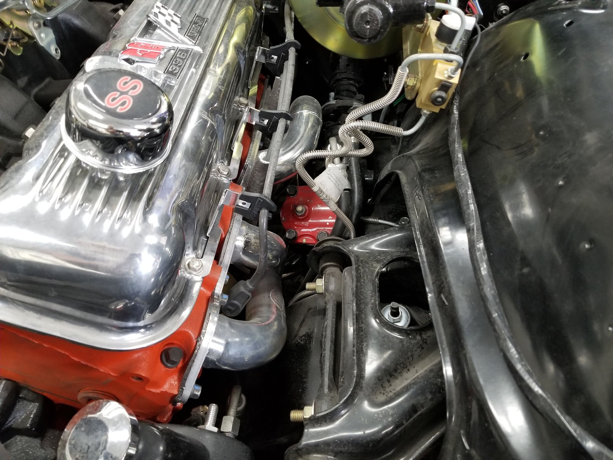

I went with Hooker’s Super Competition long-tube header (PN 2111-1HKR) on my 396/Muncie M20 combo. Works fine, last a long time, as they say. My ’68 is equipped with power steering, and we ended up going with this header to avoid beating in the #5 header tube. The #5 tube goes OVER the #7, then takes a hard dive to clear the Z-bar. Added benefit is there is NO header tube in close proximity to the steering box, so no heat injected into the power steering fluid. Regarding heat into the valve cover, see for yourself:

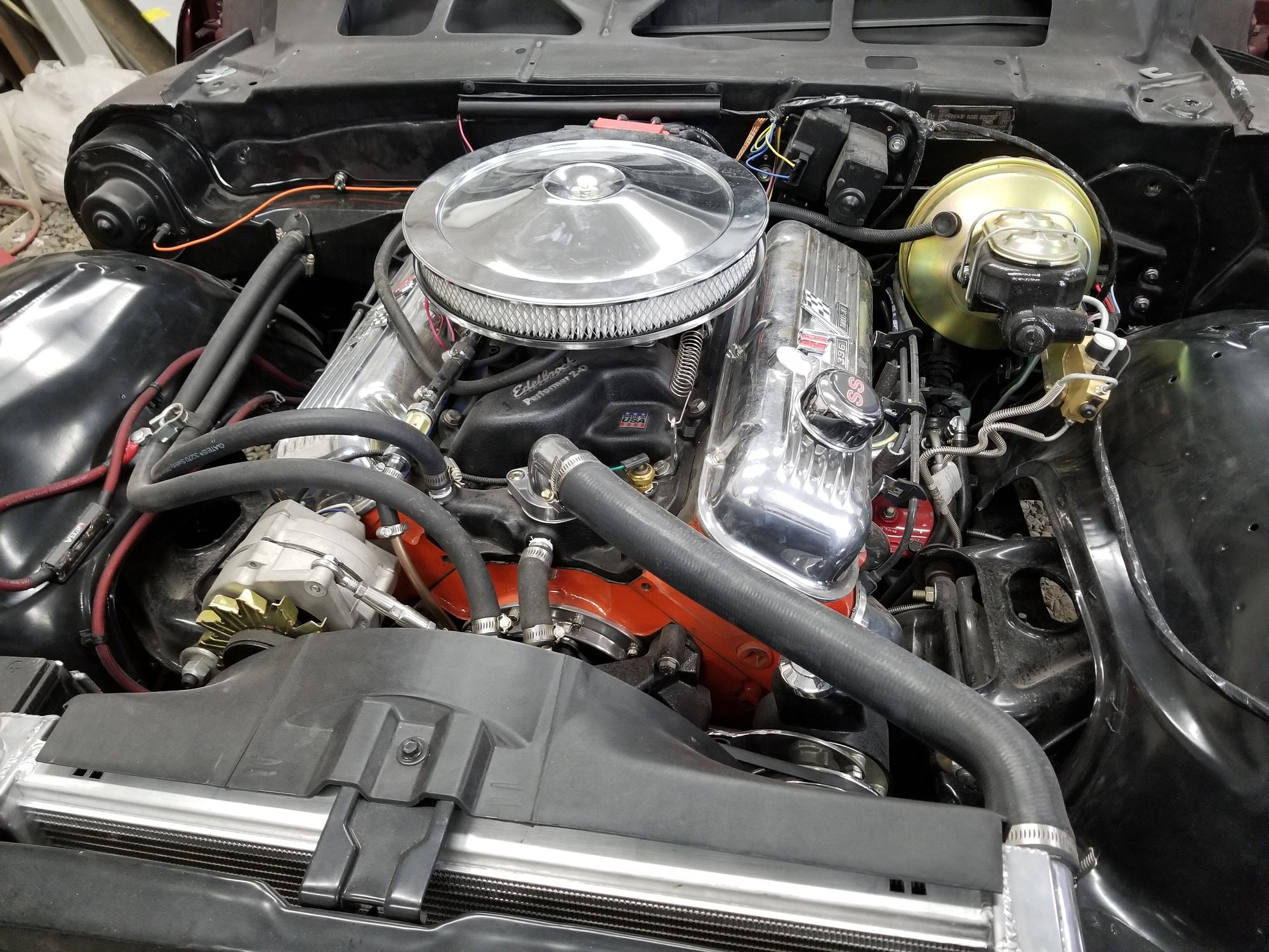

Here's a shot of the full engine, 396 feeling good:

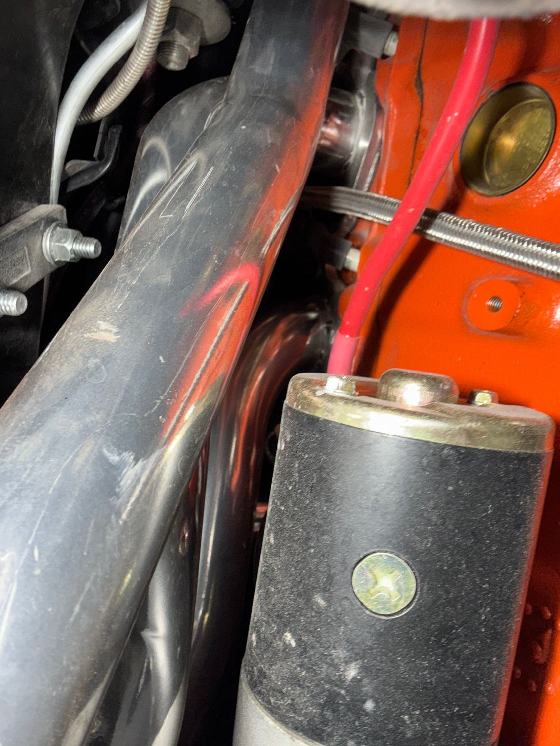

Yeah I wouldn't worry about the valve covers, starters are a different story and the most common problem with headers in a BB 1st gen Camaro.
Heat shields or wraps are a good idea to avoid heat sink in the starter.

Thanks for the pictures! This is exactly the route I'm looking for and your pics explained a lot. What I couldn't see from the picture of the header from Summit was how far the tubes spread outward, so the rocker cover is really no issue. Seems they fit perfectly, did you lay them into the bay first then drop the motor on them?

Regarding Y2K’s comment about starter issues, one of the things we did was choose a high-torque starter, which while very powerful, is actually smaller in diameter than a stock starter. Here is a pic I took today of the proximity of header tube to starter. It appears there is about an inch of clearance. That is only at the very front (radiator-end) of the starter. As you can see, they diverge the further back you go. I don’t know if there is an issue yet, as I haven’t run the Camaro in summer heat, having just received the car in mid-December. So far, no problem, and this starter is very strong:
