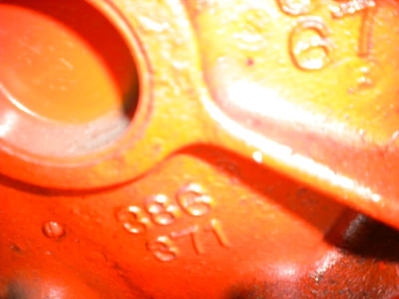

there is a number cast by the oil filter and the back of the block that look like this:
386
371

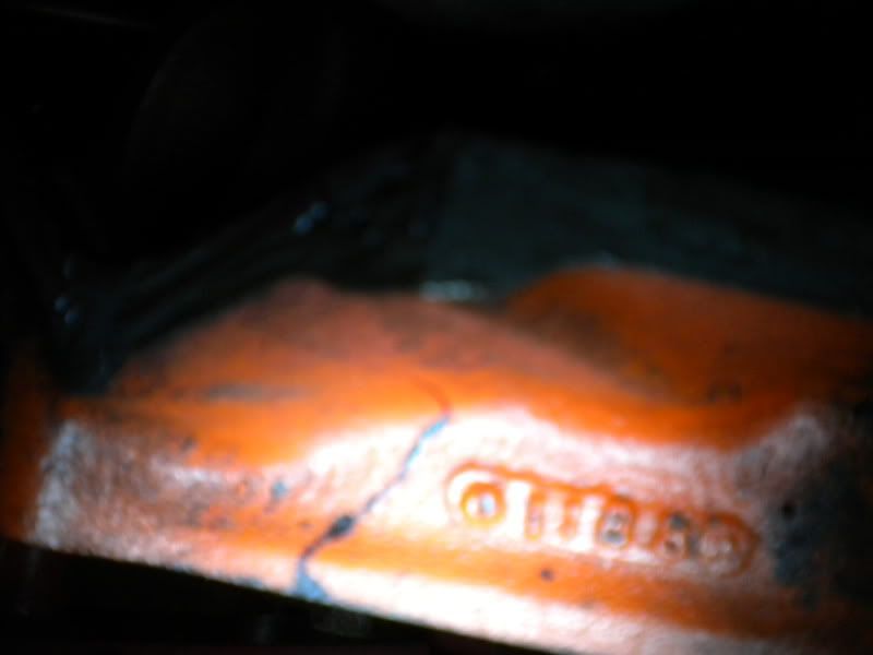

<a href="Login to a private Photobucket.com album" target="_blank"><img src="http://i8.photobucket.com/albums/a15...1/DSCN0521.jpg" border="0" alt="Photobucket"></a>

<a href="Login to a private Photobucket.com album" target="_blank"><img src="http://i8.photobucket.com/albums/a15...1/DSCN0537.jpg" border="0" alt="Photobucket"></a>
Old Apr 16, 2012 | 08:24 AM
  #15
That's not it. For the VIN what you're looking for is a stamping, not a casting. If it was by the oil filter, it would be on the flat vertical area behind the filter boss, right by the bellhousing.

yes, i know thats not it. just wasnt sure if that number meant something

i cant find any other stampings on this block.
