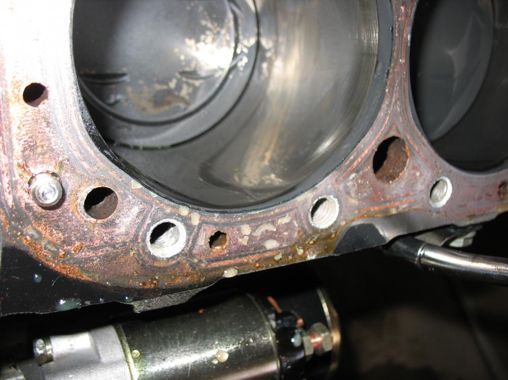

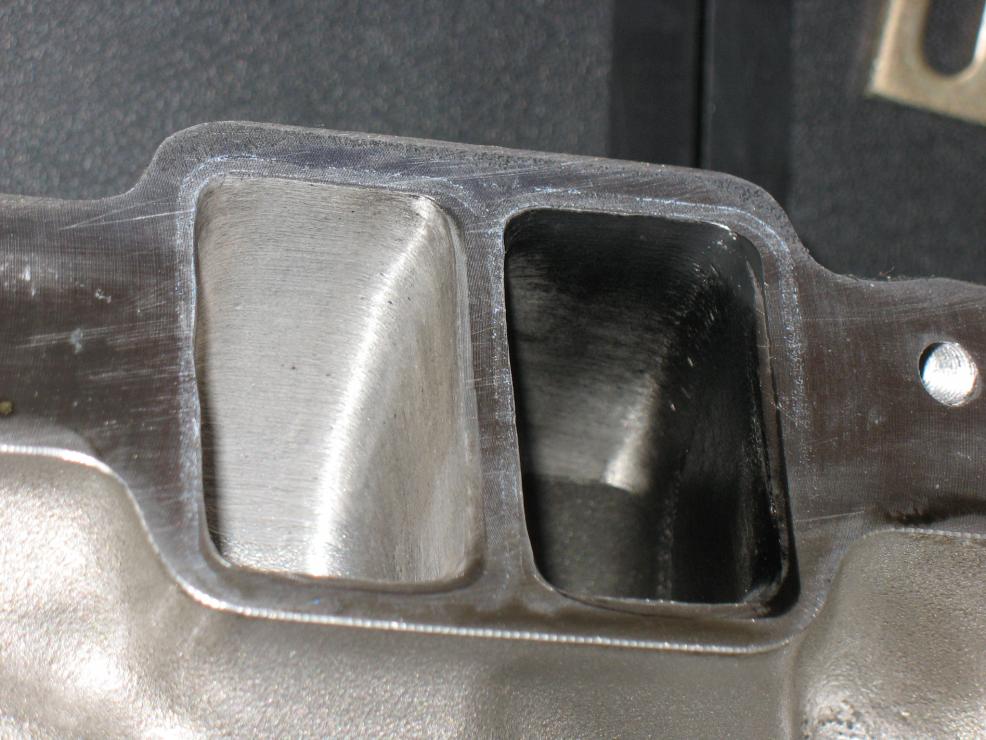

1) Intake runners really carboned up. See Pic1

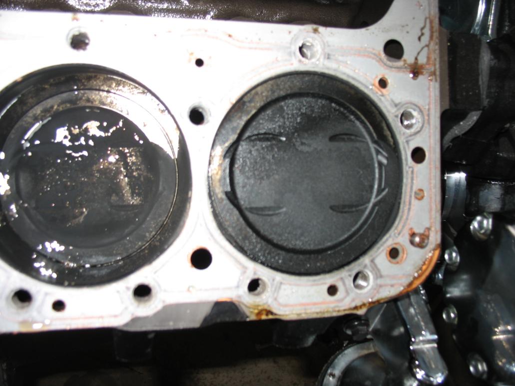

2) Coolant droplets/residue on intake/head gaskets in places I didn't expect. See Pic 2, 3
3) One cylinder (the one where the spring broke) excessively carboned and a little 'oily looking'. It also looks like there is a dimple next to the forward-most valve relief where the exhaust valve it the piston. Note, the valve looks fine (no marks whatsoever). See Pic 4.
So, a little history. I turned the motor upside down on an engine stand to replace the rear-main and pan gasket. Not sure if residual coolant may have sloshed out and around where it shouldn't be and that explains #2 above?

Quick thought. The heads have the heat riser passage. Is it possible an intake gasket leak could cause the carboning I'm seeing in the intake runner?
Is is possible that just residual coolant in the water jacket/etc. dribbled out/condensed as I was pulling the motor apart?
Finally, I used ARP teflon thread sealer on all the head bolts and on the center bolts of the intake. One picture shows the sealer migrated out of the threads where it all packed up a ways up the bolt. Is that normal? Will these bolts eventually leak coolant?

As I was reading I was thinking the coolant was if you rotated the engine on the stand. I'm glad that as I read further that's exactly what you did so that's probably all the coolant issue is. As far as carbon I think it's interesting that it's the cylinder with the damaged spring. I'm not sure how long the car ran with the broken spring but that might explain the carbon if the valve wasn't completely opening and/or closing. I know this is about 6 weeks late so hopefully you've got everything back together with no problems.
