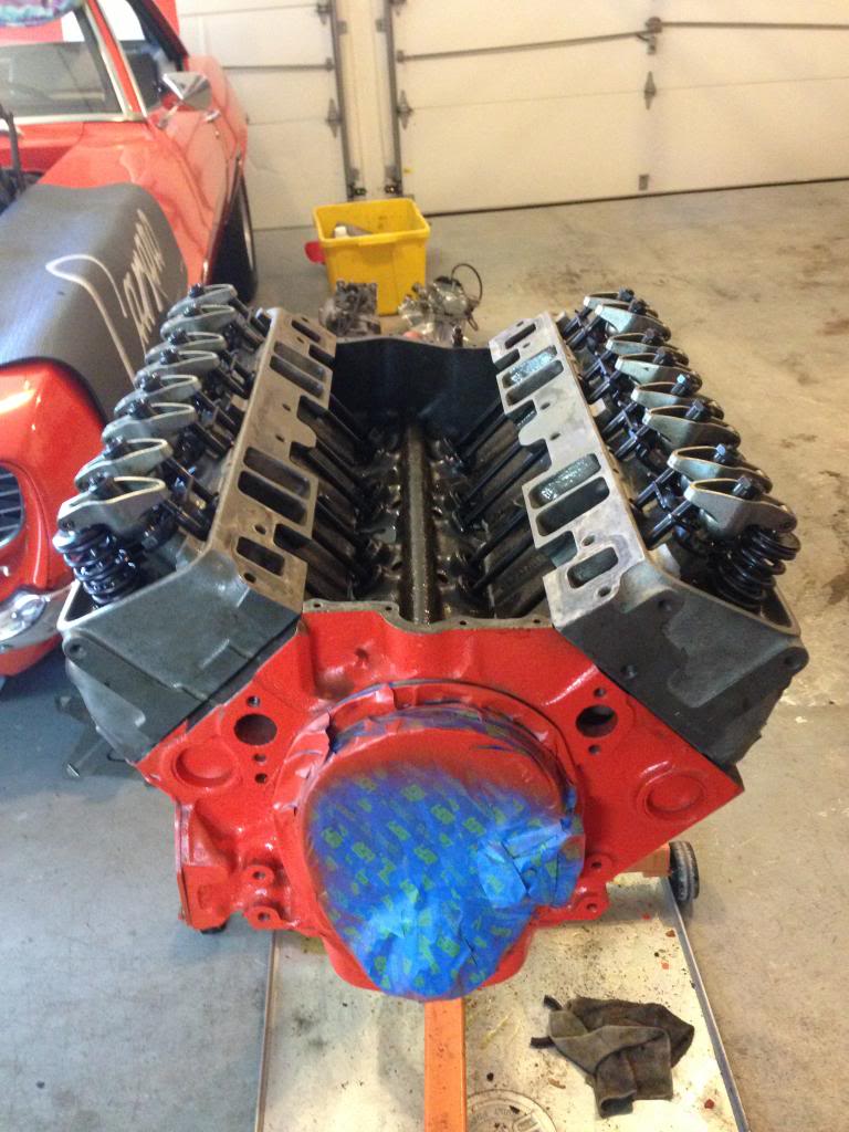

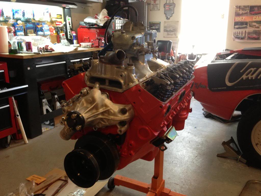

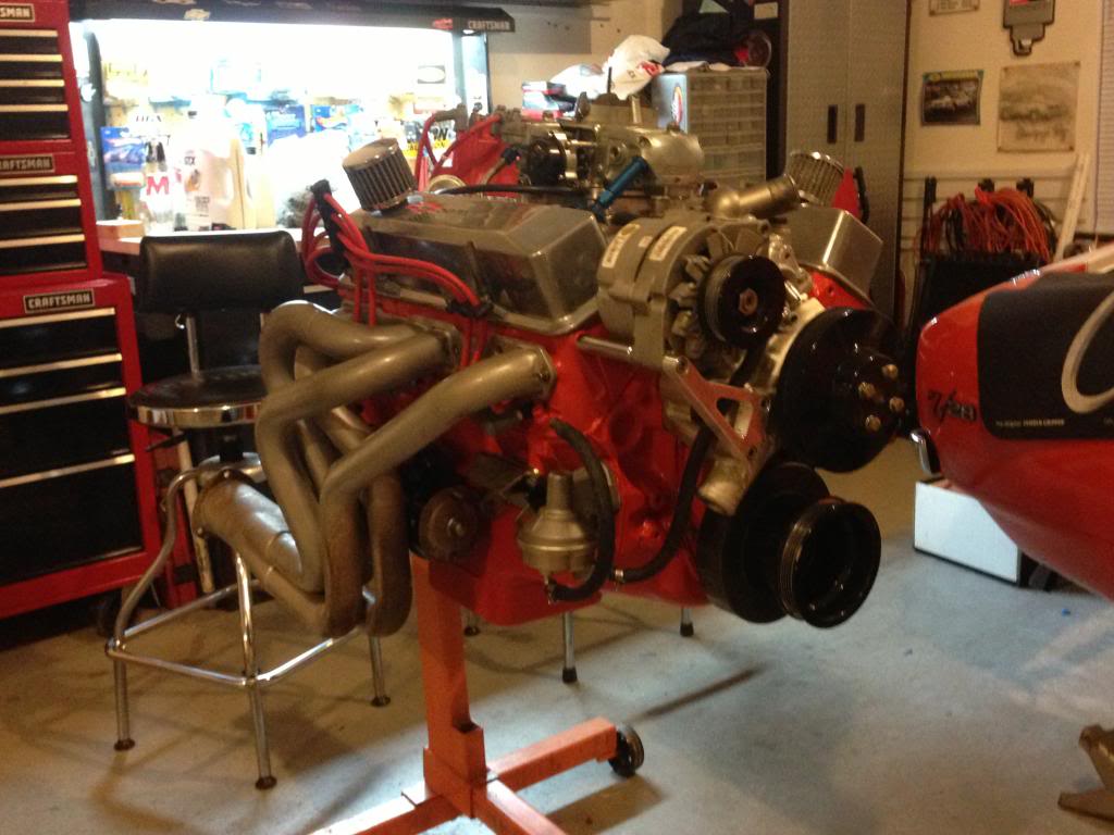

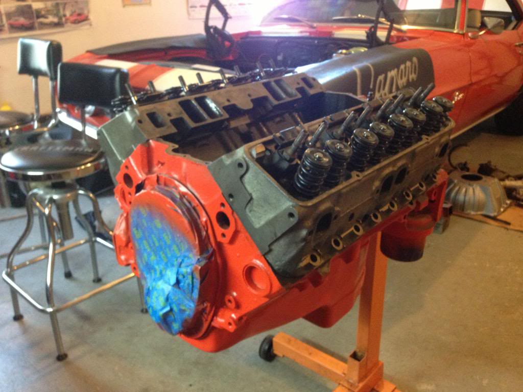

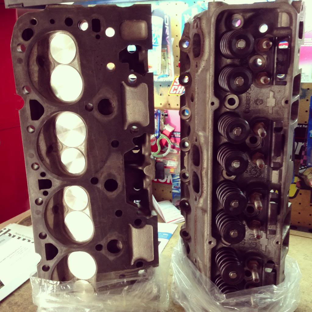

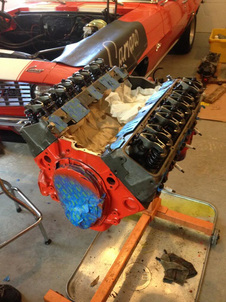

Finally got my heads back! This weekend I am reassembling everything and hopefully firing it up tomorrow. With this new set up 8000 rpm should be reachable
