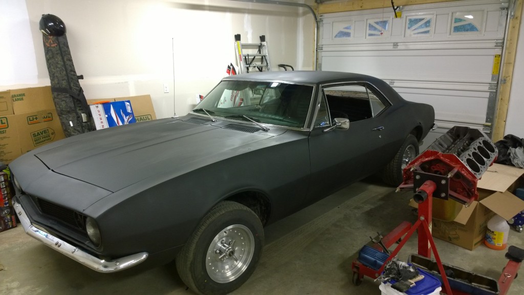

new temporary paint she's gonna be stripped down at the end of summer
