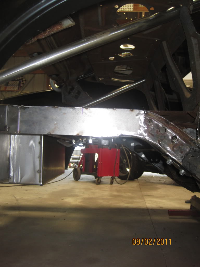

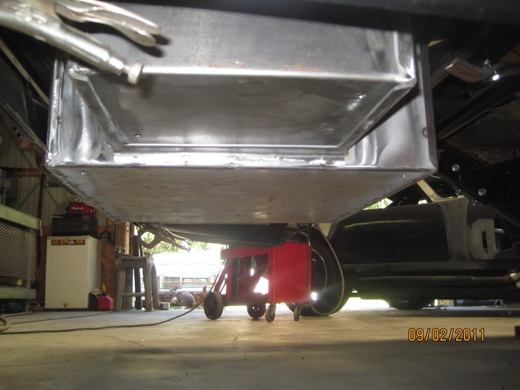

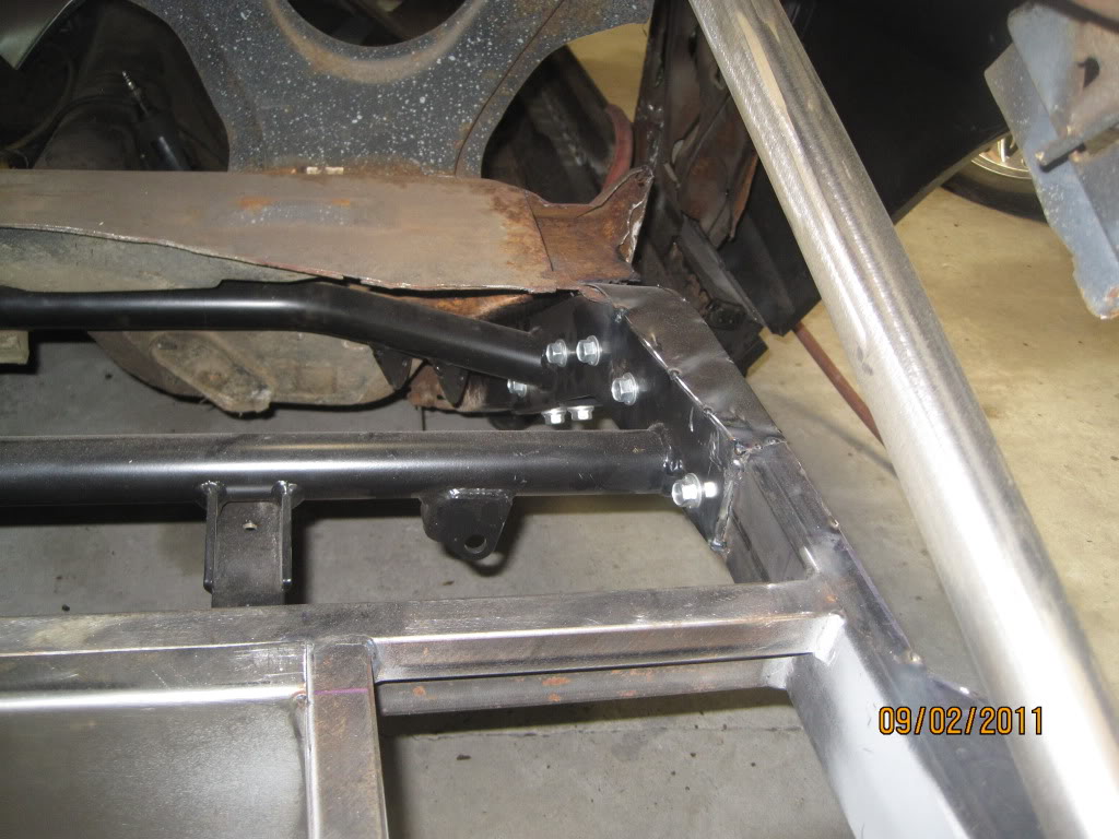

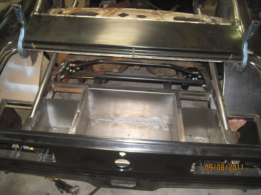

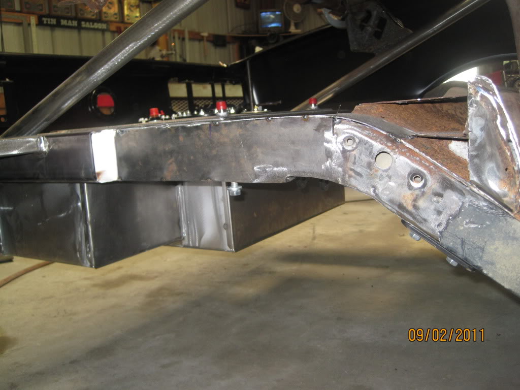

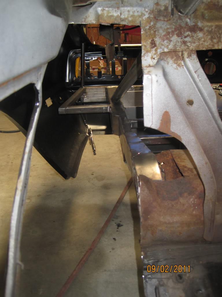

Back clip almost completed with notching the frame rails.. Fuel cell box with a box for batteries on each side.. Next set of pix hopefully will have wheel tubs and bead rolled floor for the trunk

some more pix

Look at that rear end.....haha j/k.....very nice work man. Can I ask a dumb question?......what is that box for? You said fuel cell box......as in gas tank?
Yes the fuel cell will be the storage for the fuel, instead of an aftermarket fuel tank for mini-tubbed camaro's..
The middle box was fabricated to house the aeromotive fuel cell with the eliminator fuel pump (for efi) to protect the aluminum fuel cell from the road and so its not just sitting on the trunk floor like 99% of cars, the rear clip has straight steel across the back incase of rear end collision. The two side boxes will house batteries, allowing the wiring to be hidden underneath the car.. the overall goal was to make it look as clean as possible when the trunk pops, instead of just throwin' two batteries and a fuel cell in the trunk..

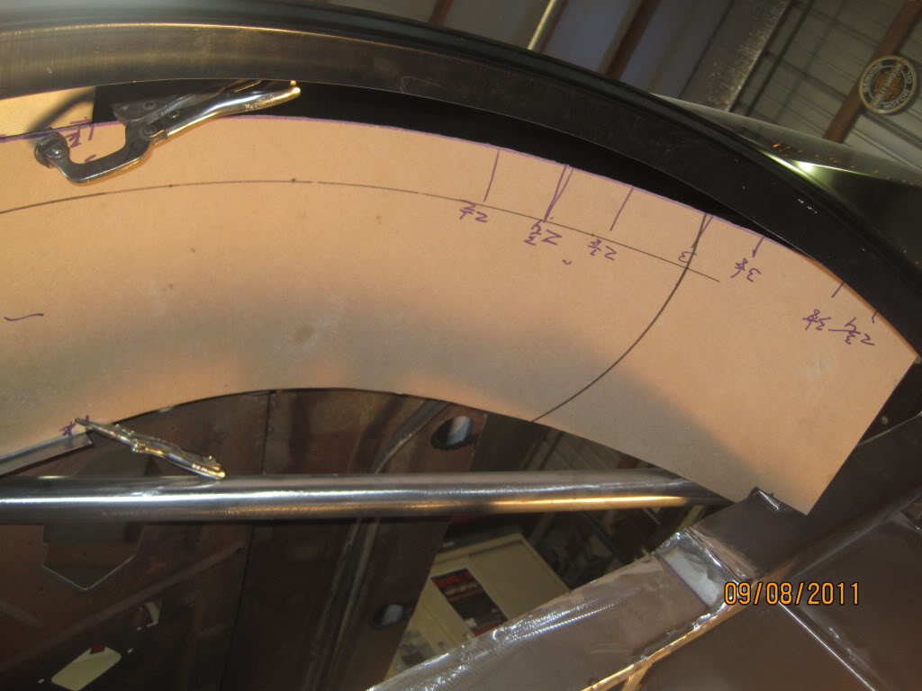

Wheel wells being fitted..
