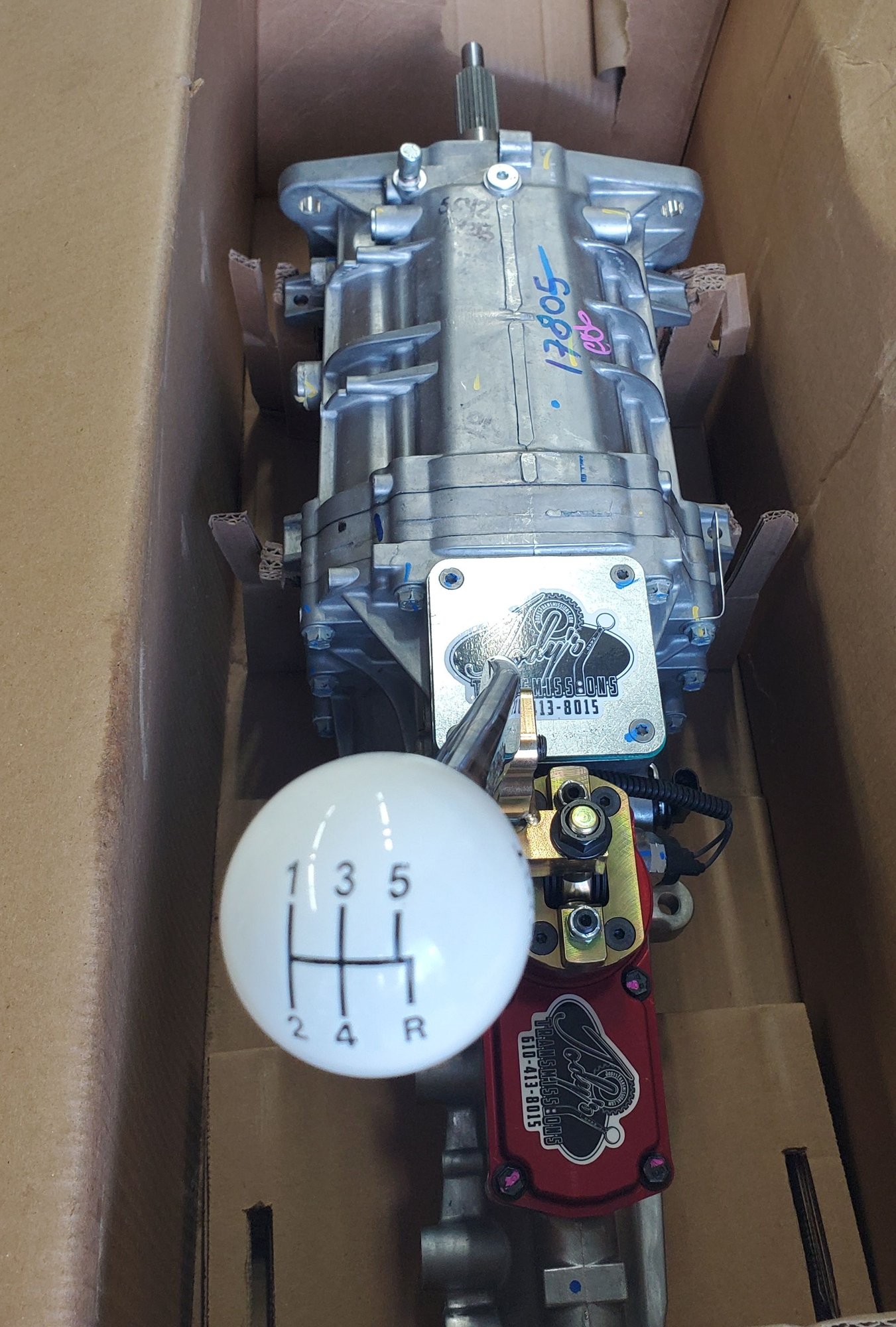

New Member here, so hello to Everyone first off. So I started working on this car for the guy (and friend) I work for. He bought the car roughly a year ago. The car shifted horribly, like really bad and he asked if I knew anything about them. I got to see the car for the first time that weekend. The linkage was beyond out of adjustment, one of the levers was on backwards, and the car had a truck bellhousing on it. There were some issues to say the least. The trans was also leaking out of the countershaft. we decided to install a Tremec TKX, new clutch and bellhousing. I took the car back to my shop and got started. While I was doing the swap, we decided might as well go over all of the suspension too. The 12 bolt rear had it's own issues as well so a new 12 bolt rear and 4 link found a new home in the car. I'll post some pics here as the project progressed last year and also how it's going now. I've wanted a first gen Camaro since I was around 10 years old. I also tried buying this car from my boss pretty much as soon as I saw it (and ever since then).

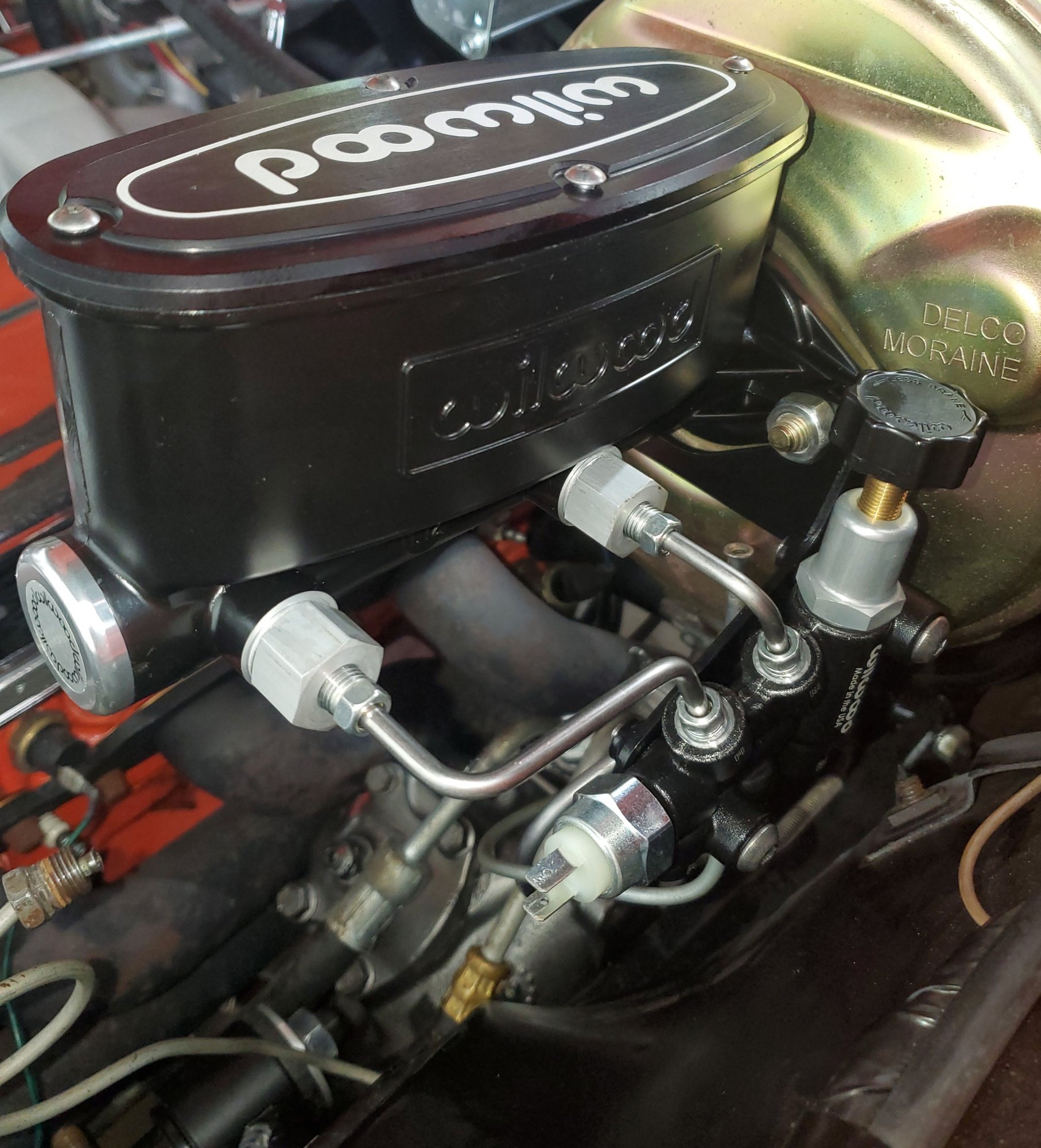

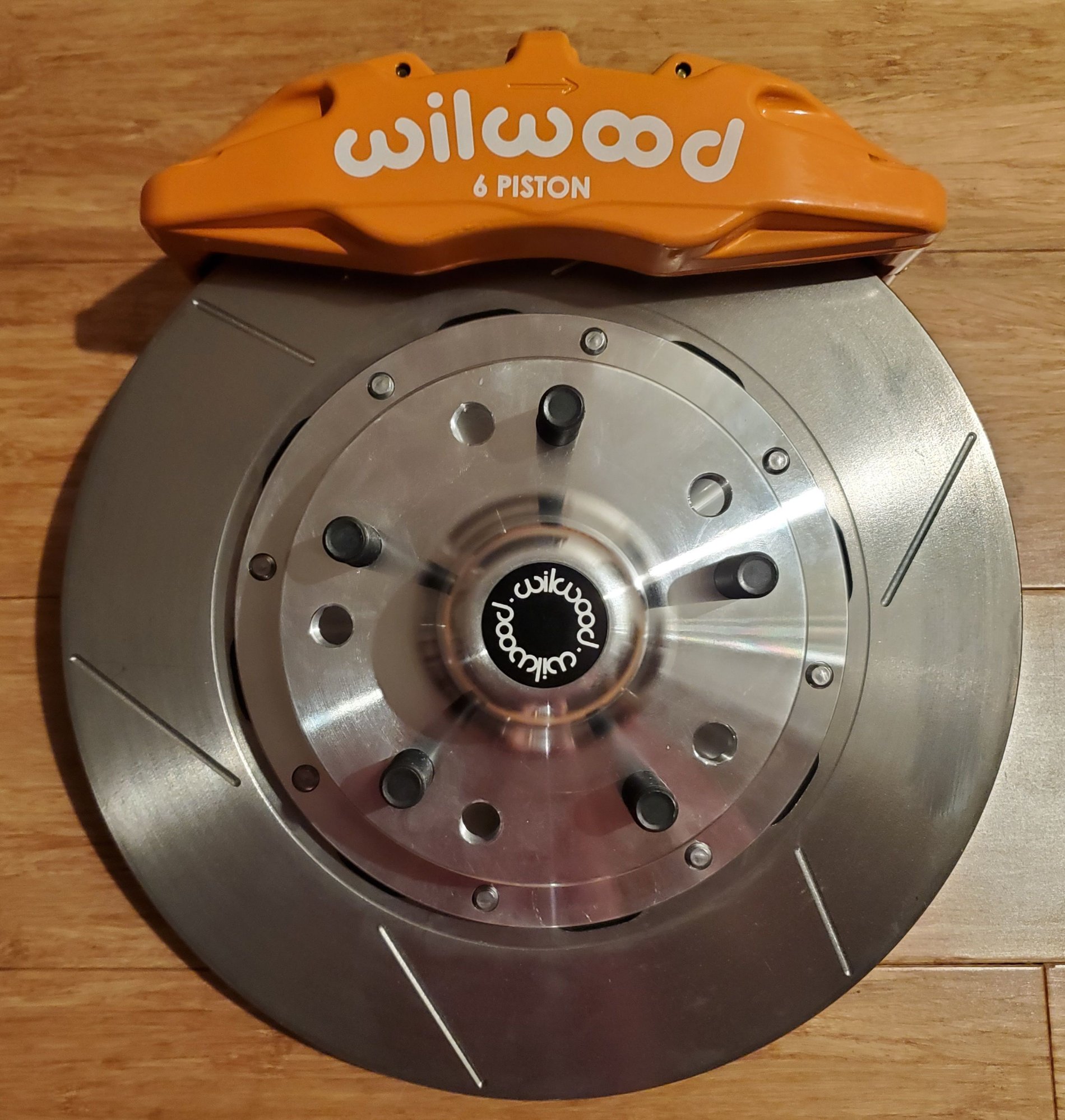

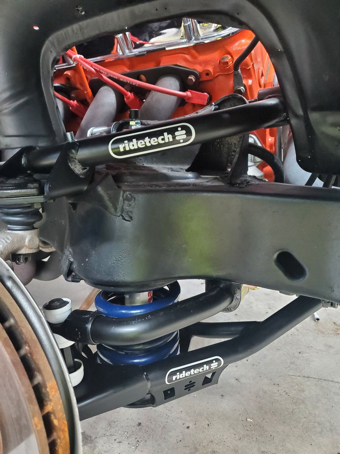

Did a rear disc conversion, new master cylinder with proportioning valve and 6 piston calipers up front. Tubular control arms, springs, ball joints, tie rod ends, sway bar, close ratio steering box and a tilt steering column.

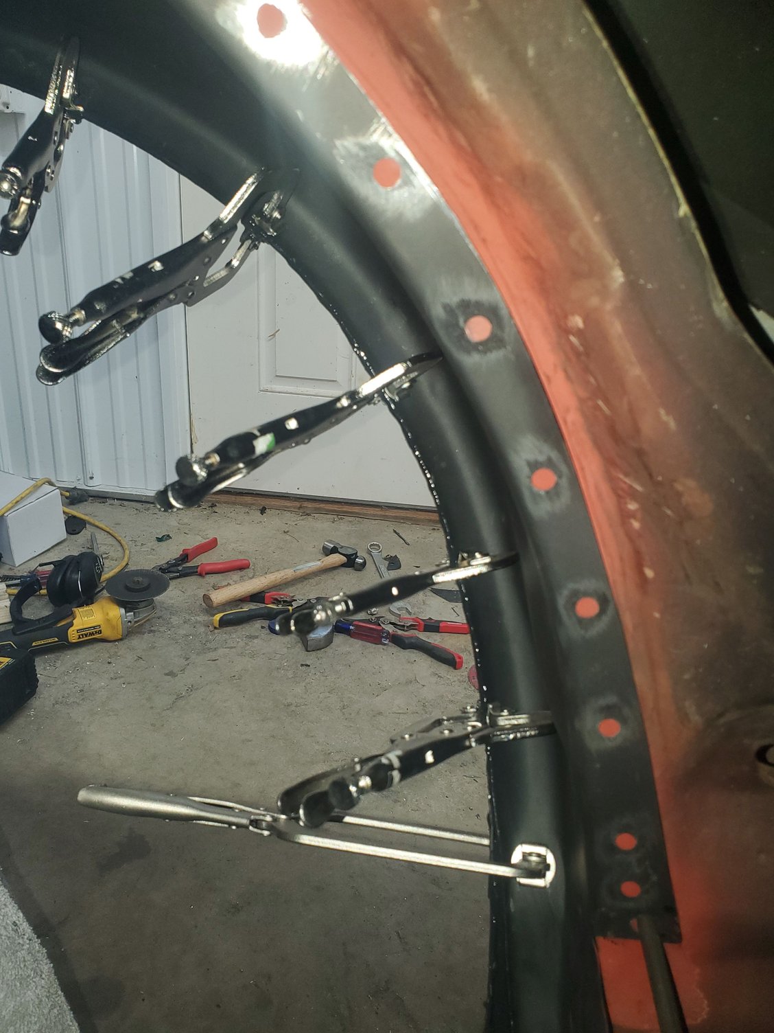

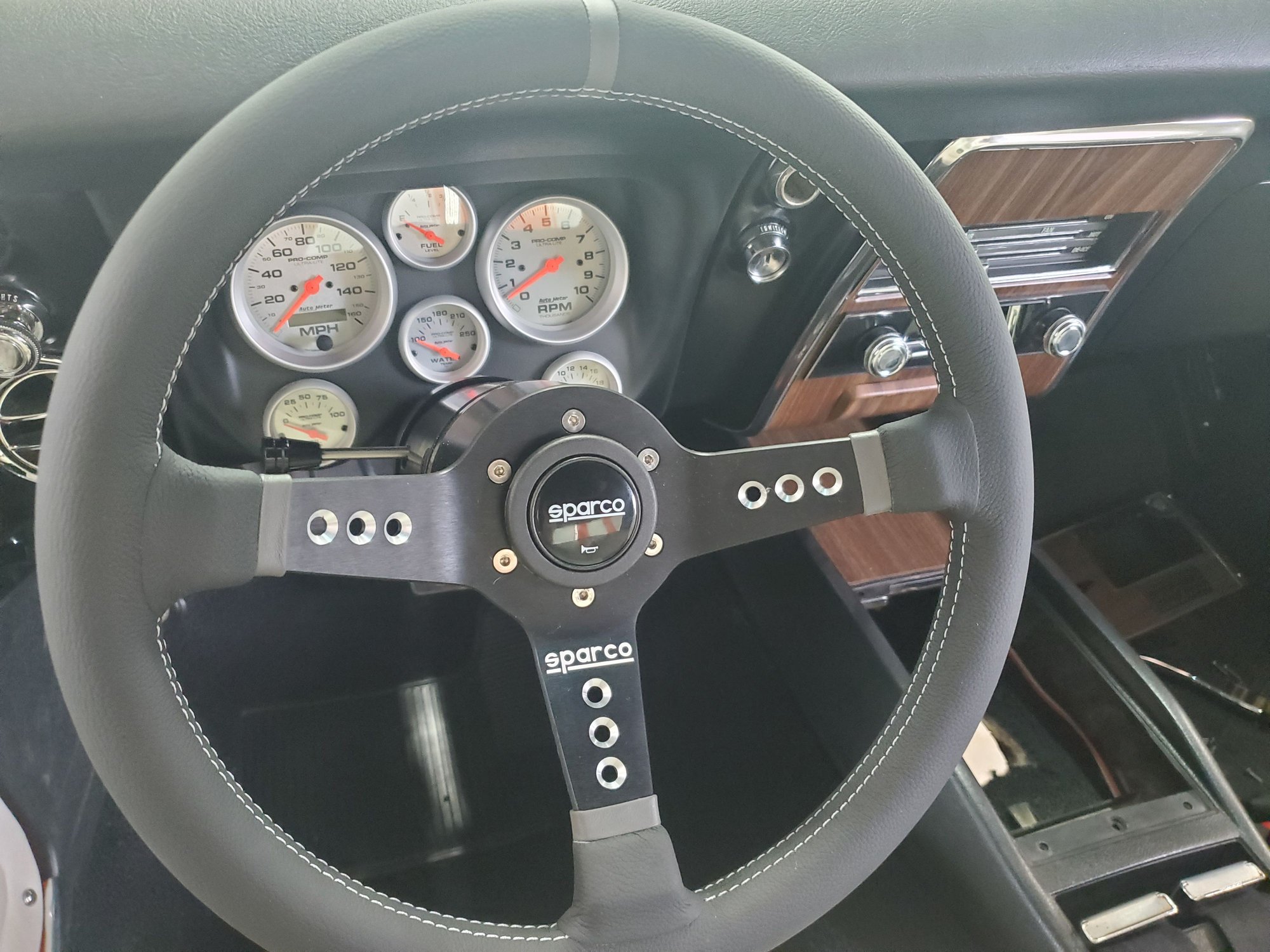

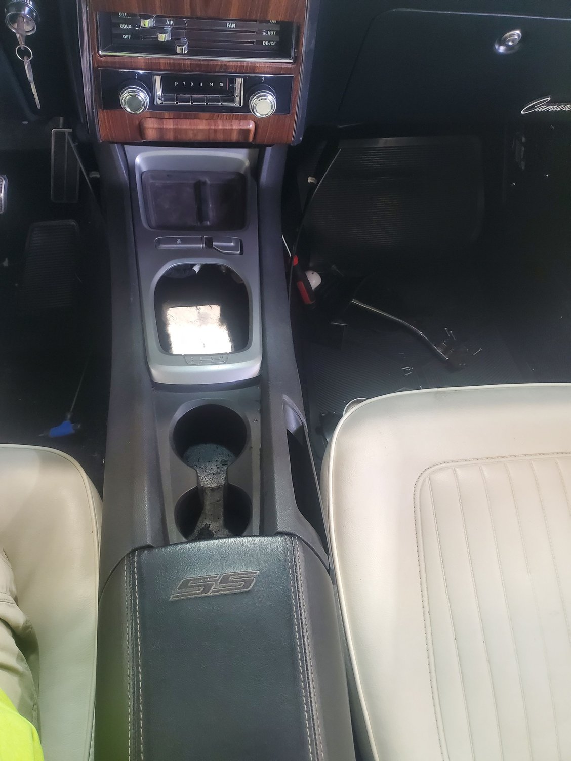

Definitely still a work in progress. Im currently mini tubbing the rear, and also found a rust issue on the outer wheelhouses. Replacing both the inner and outer now. Finished up the drivers side yesterday and got the passenger side about 50% done as well. Measuring for new rims / tires as well, now that I'll have some room. I swapped out the steering wheel and gauges on the car as well. Just got a center console out of a 2015 too, seems to fit fairly well. Just a few tweaks and some mounts to make for it.

sorry for the pic overload, just playing catch up with this build thread. Replacing the walnut with a black dash center panel and ashtray too.
