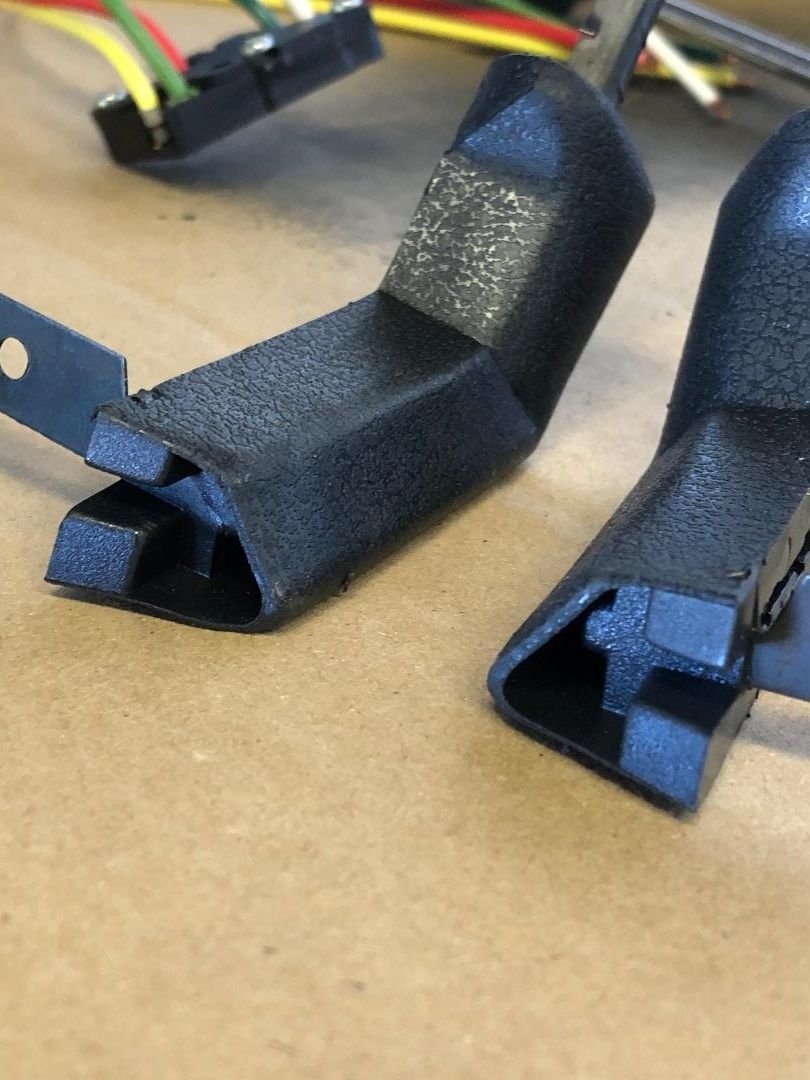

These are 1967 Quarter Jamb Upper Windlace Ends. They are 67 only items although 68-69 will fit.
The ends look to me to be unfinished and missing an end cap. Talking with the manufacturer they say the ends are the same as OEM. Can anyone confirm that?

Noticed you have not had a reply. So here is my take. I've replaced mine as well. Since they come only in black I had to paint them. As for the cap.They are just like the OEMs. There is no cap because the end of the molding strip that holds the back panel in place fits into the area where you think a cap is suppose to be. Hopes this helps.
