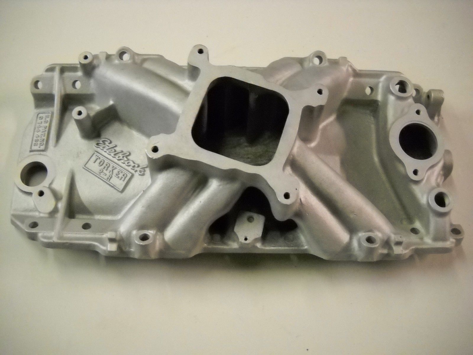

I ran a Holley 750 double pumper on a twisted torker intake like this one, had the rectangular port heads and solid lifter cam.
She ran like a scalded dog!

Thanks for the reply..... the intake does have dual planes.... not an open plenum like your picture.....so this is where the confusion begins.... is an open plenum better suited to a spread bore or a square bore carb? My intake is dual plane, but the separation doesn’t come all the way to the top of the intake....there is a gap about 3/4” of an inch in the splitter below the top surface of the intake. I hope that makes sense. Most of them that I see have the splitter between front and rear on the intake coming all the way to the top of the intake.

The 'dual-plane' manifold will be the better fit for you as one should build torque for the street. The one pictured is for high rpm in building horsepower.
The reduced center wall is for balancing both sides of plenum for a better vacuum signal, read steady, to the power valve rather than a choppy signal of a completely divided plenum.
