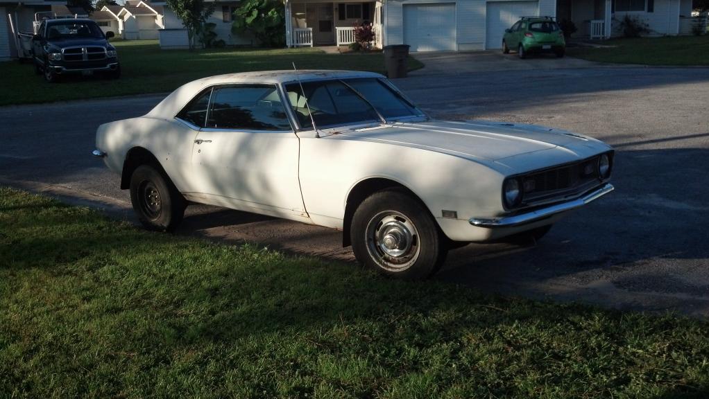

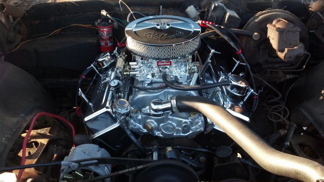

Ya i heard about the overheating but as long as you have the steam holes drilled in the heads then it is usually ok. But here are a few pics. the engine is a diamond in the rough but as full restore will be starting in about a year or so. cant wait! ! ! ! ! !
Attached Thumbnails What do you think about 400's??-img_20131012_171924_371.jpg   What do you think about 400's??-img_20131012_172014_255.jpg
