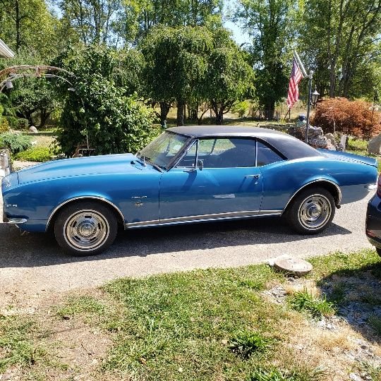

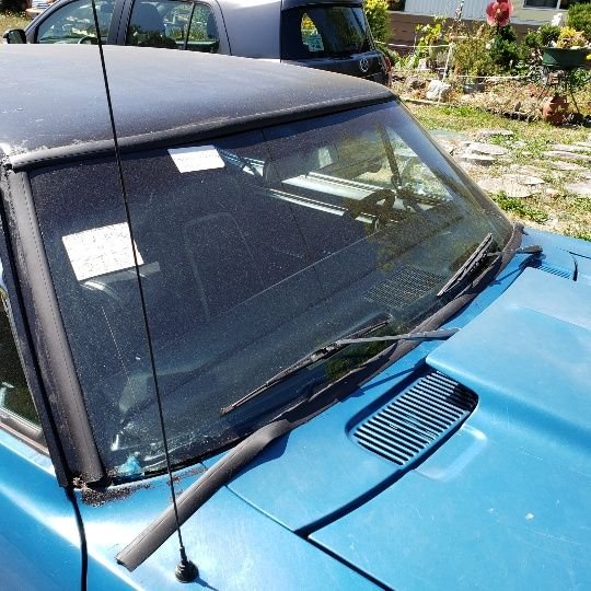

I'm seriously thinking of buying this but am very new to Camaro's. Does anything jump out at you? I see the non-stock hood and crappy windshield install. Let me know!!

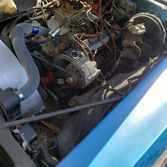

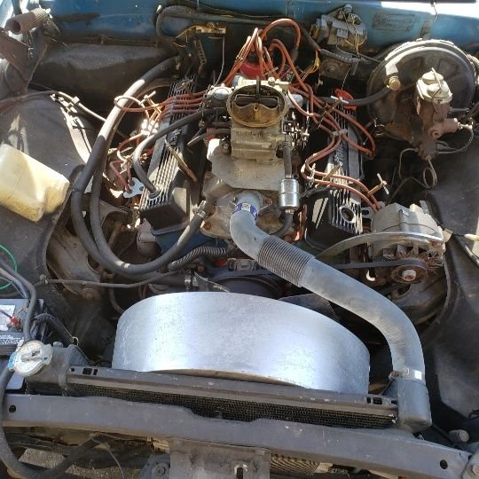

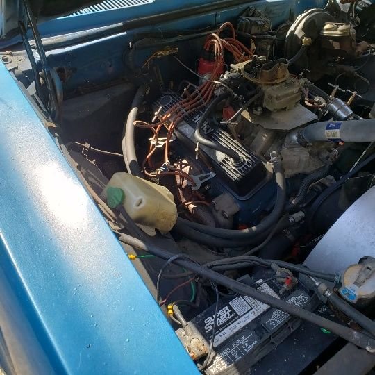

I am no expert by any means, BUT no air cleaner is a no no for me. not sure of the picture, but looks like no breather in the valve cover

Vinyl tops are a worry,very often rust underneath. I'd look the whole car over very carefully looking for rust including the subframes etc.
Homefry fan shroud looks pretty cheesy but I suppose it works.

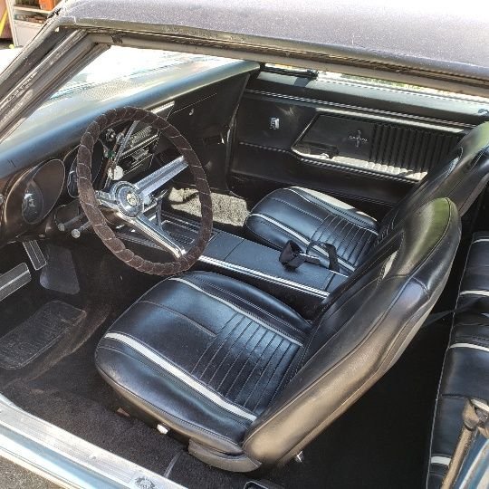

You should get the number off the cowl tag, The rear spoiler is not original and the fan shroud looks home made. The interior looks original deluxe with gages pack. Its not common for the firewall to be the body color. What are the kind of things you are looking for? Its a nice looking car but a long way away from a show winner against a high end restoration.
Underneath is where the sins normally show up.

What's up with that roof? Is it covered in vinyl? Post some better pictures of it front and back. It looks like someone's hack job.
BTW, in general, $10k for a running, driving 1st gen is a good price.

Thanks for the replies, I'll try to answer any questions. First off I'm 7 hours away from the car which is stored in my in-laws garage. My brother in law lives a couple of hours from the car so getting more pictures takes time. The vinyl roof is gone, matte black paint in it's place. Brakes are definitely high on the list as they haven't been touched in years. I don't know any thing about Fisher bodys, can someone enlighten me? I think the $10k price is because his sister (my wife) is interested. I'm sure he would list it for more if he decides to sell it out right. So what else should I be worried/concerned about? Thanks so much!
