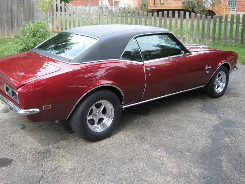

billet wheels and mickey thompsons front & back. if interested i can give you the dimensions.

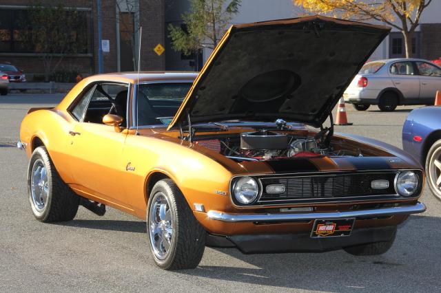

Definitely a 275 in the rear. 275-60-15 or 275-50-17. The front is up to you whether you want the drag race look or more of a street look. I have the 275-50-17 on a 17X9 in the rear with 225-50-17 in the front on a 17X8. Be careful with your back spacing, 5 1/2 on the rear and 4 3/4 on the front would work perfectly. I went 5 3/4 and 4 1/2 and have some minor issues.
